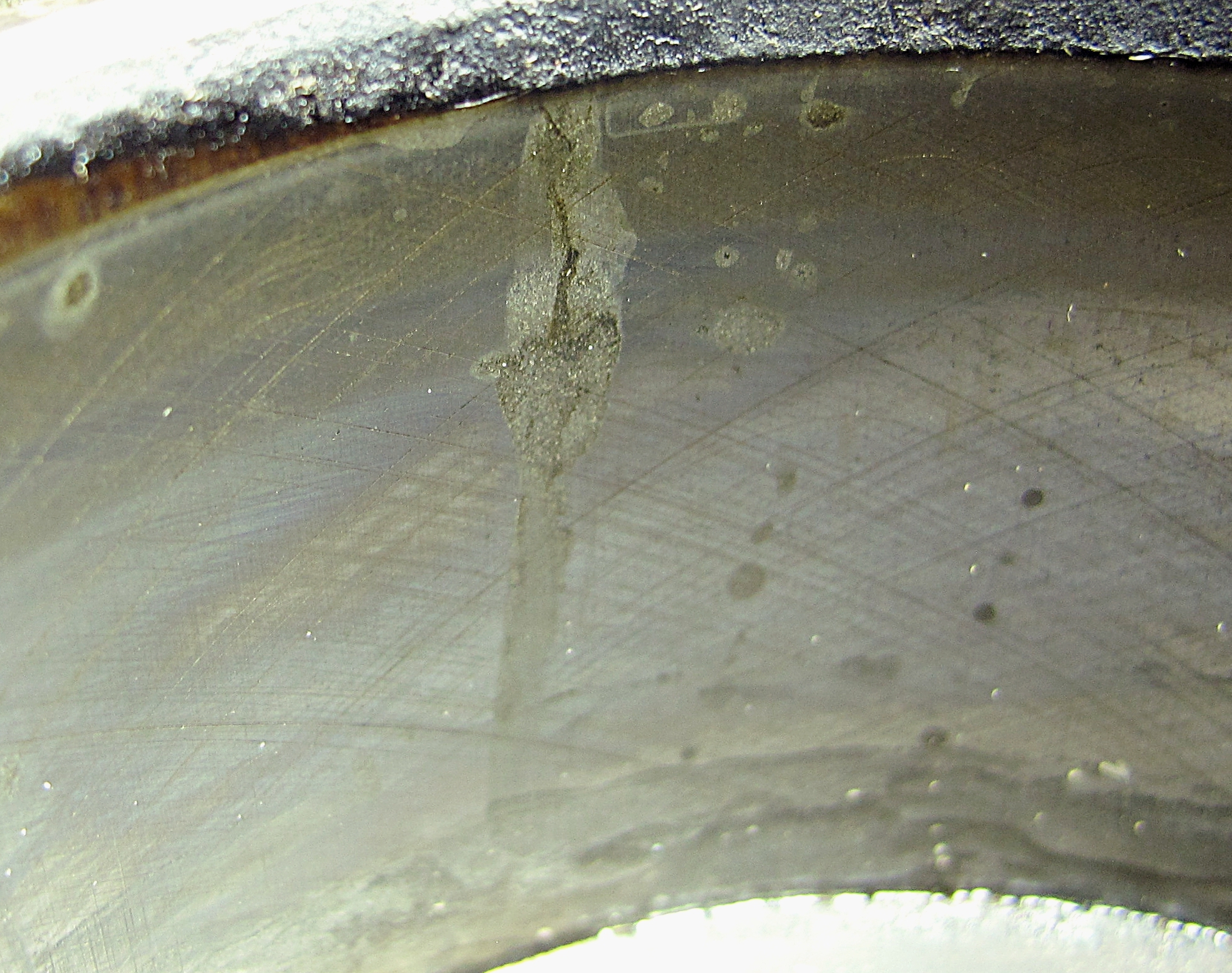

Hi I have a Crack in the cylinder! Is there some way to get new? One or four? Skoda in Norway want 650 pound for four with pistons.
Just buy one new liner and seal plus one set of piston rings and have it honed to suit those new piston rings.
