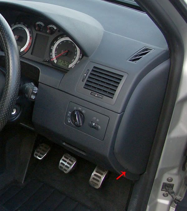

Hi mate, the fuse box is located at the end of the dash. Open the drivers door and there is a panel on the end of the dash that needs to be prised opened with a small screw driver.
If that makes any sence?
Welcome to the Forum :thumbup:
As above the fuse box is on the end of the dash, drivers side...
See piccy below...
The slot is designed so that the end of the key fits it, negating the need for tools to remove it.
