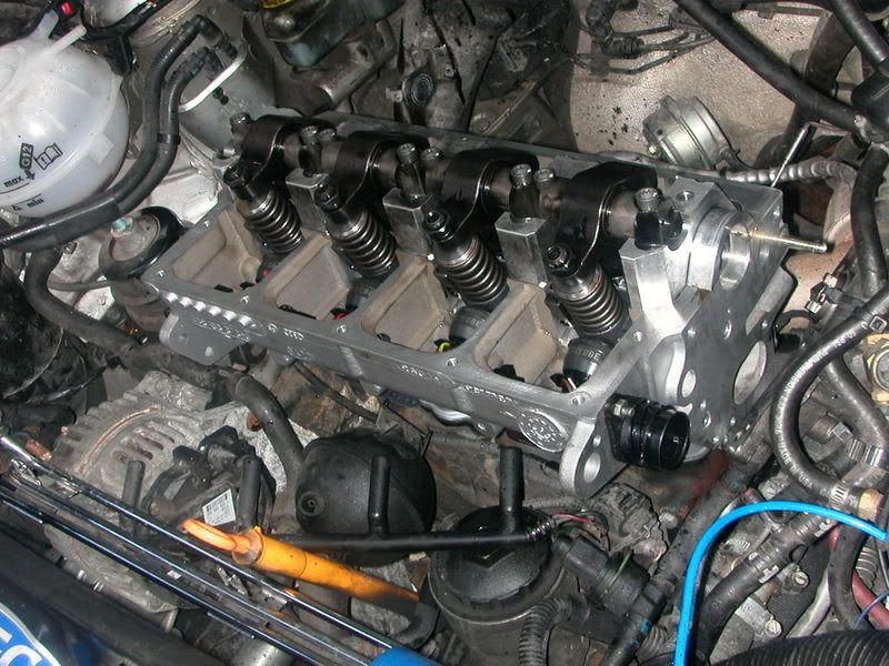

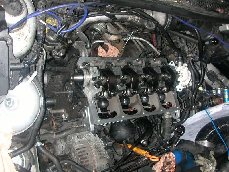

I put in the final two tappets & bearing shells myself. Cam offered up.
5 "blocks" to hold the cam down put in and bolted down.
Rockers get bolted on top too. :)
And the head pretty much ready now for fitting on to the block.
Head placed on the block, sweet as a nut.
And bolted down! These are tough little bolts! :cool: 40Nm, then 60Nm, then two successive 90 degree turns!

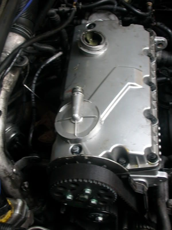

Cambelt gets put on, and....
... the injectors are setup using a dial gauge to ensure rockers at lowest point
Cam cover gets mated to its new head for the first time

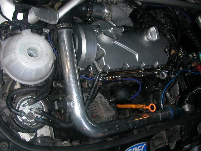

and the turbo and inlet are bolted on firmly. :)

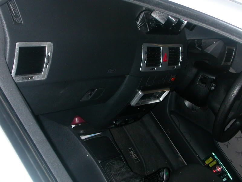

To pass the time I'd been painting bits of the inside of my car silver! :rofl:
Silver t'is!

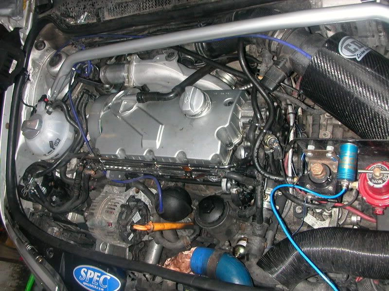

And although not obvious, the engine is ticking over in this shot! Water cap off as it was sucking water through quick! Needed even more when I'd got back from the first test drive.
Overall I'm very impressed with the work done, and the overall results at the end. Just cannot wait to dyno this thing! :D
