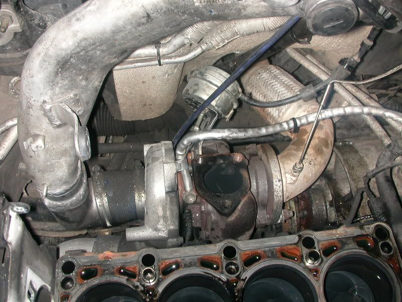

Turbo coming off, inlet already off.
Turbo just held on by the studs

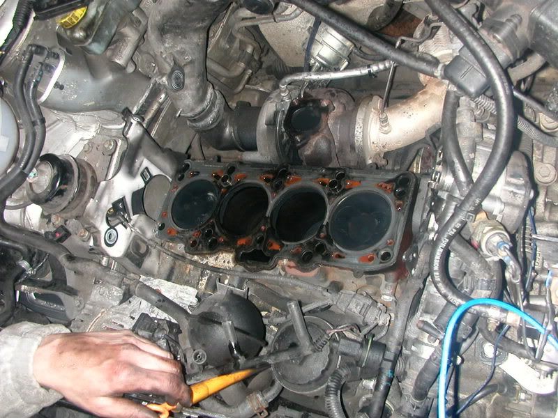

Cylinders/pistons verified as being in very good condition
A peek at the turbo from above. Some evidence of blowing.

Block cleaned up in readiness for new gasket
