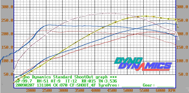

I did a quick photoshop comparison and scaled standard, Bluefin Stage 1 and Shark Stage 1 onto one graph... They are all off different dynos so I don't know how the figures will compare (although of course I stretched/shrunk them to fit the scale), but the curve shapes are interesting. Would be good to find a Revo map and pop it onto this graph too... Anyone have one for a 2.0 TFSi?
Red is standard
Blue are Bluefin
Pink/Yellow are Shark
Edit: Scales are BHP and ft-lb in case anyone is wondering :)

You aint going to get 270bhp off a Stage 1 Remap as you have put for Shark performance.
You will find that you will get somewhere around 235-240bhp & 270lb/ft with all of them (REVO, Shark, Bluefin)
However just be wary. You don't want the power coming in all at once and then tailing off quickly. Ideally you want a curve like the Bluefin Torque curve you have plotted. But you wont get a curve like that from any of them above 250lb/ft (not that i have ever seen anyway). When you actually get it done your looking for a curve like the Shark Performance one. Some of REVO's latest files have similar curves (My Stage 2+ does) which is what your after. Smooth and Progressive not a big shove then out of puff.
Out of all of the Tuners out there for the TFSi if i were starting all over again it would be a toss up between REVO, Shark & APR for me and i would probably go with Shark.
Yeah, I know. I haven't plotted anything here, just put other curves I have seen onto one graph for comparison. Would be nice to have them all on the same car and on the same dyno, but hey, that ain't gonna happen!

Ahh roger that thought you had plotted stuff

Will update graph in a bit, can post up if anyone is interested? Might reduce figures for Shark remap to ~240bhp too as they do seem pretty high...

The shark graph itself is more important than its outright output values. Its all too easy to put the wrong parameters into the dyno system and get a higher than true reading.
For sure.

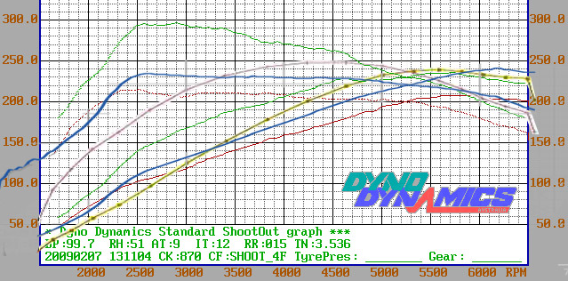

Will update graph in a bit...
Revo added in green, with Shark one brought down to 240bhp at it's highest point (and torque scaled down in the same way - not sure how dynos work, could torque be measured independently of BHP? Either way you can still see the curve.) Would be interesting to see the 'actual' readout of the Shark and Bluefin, they seem quite 'smoothed' compared with the direct readouts you see on JKM website...

For what it's worth i have learned to take Dyno figures with a pinch of Salt. All my Power runs (bar 2 when trying to sort a problem with Stage 2+) were done at JKM
To be honest Bhp & Torque figures are just for pub talk. It's how the car drives and what the Curve actually looks like.
Smooth and progressive is the way ahead. My car (according to the Dyno) has no more lb/ft on Stage 2+ than Stage 2. However because the Stage 2 Curve is now smoother the car is faster as the power is delivered progressively past 5k rpm.
Think of it this way the early the power comes in the easier it is going to spin the wheels in a FWD car.
The only way you could truly see what each manufacturer is like against each other is to Strap a car to a dyno and then load each Remap on and test one after another so that they are done on the same car with the same mods. 2 Identical cars with the same mods will not make the same power there will always be a difference which could be a number of things (way the car is run in, Intake temp constantly changing etc)
Totally agree, just trying to get some easily-viewed comparisons on the same page. There are so many maps about that it's pretty confusing!
The Shark dyno plot is from my vehicle and it recentlly made 236bhp on R Techs rollers with 264lbs of torque. The above plot was done at Geoff Bloor Garages in Nottingham. When I had my car in at R Tech it was to have a pressure test and dyno run because I was having a P0299 fault code re-appear. My car had no leaks and appeared to be running fine apart from the fault code coming back.
