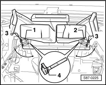

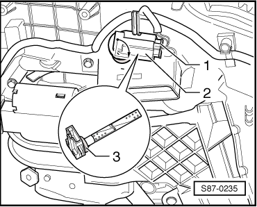

Looking at Elsawin, it says that there is a temperature sender in the footwell vent and in the middle vent, maybe these (or one) could be faulty. You need to remove the footwell vent to get at that one (unplug and turn 90 degrees to remove), and the dash panel has to be removed to get at the middle vent sensor. It doesn't mention how to test them, and I don't know if VAGCOM will tell you either? it may just be a case of elimination using a known good sender(s).
If your water pump wasn't working, I would have thought the engine would overheat?
Edit: The temp senders (above) may work with just a clean?, though I'm not sure having no experience of them. Also, just looked again - there are 4 senders - 1 in each footwell vent and 1 either side of the middle vents. I am guessing that the system has individual temp settings for the driver and passenger?
Edited by skoda norm, 09 November 2010 - 23:10.

Posted 10 November 2010 - 00:01
Some pics...
left footwell
Posted Image
right footwell
Posted Image
middle vents
Posted Image
No it doesn't. Removing the dash panel is a major job, and the sensors are perfectly accessible by simply lifting out the lidded box on the top of the dashboard. Just lift this out from the bottom, swing the box out of the way, without even disturbing the wiring to the hazard switch, and you'll see the sensors right there at the top, in the heater pipes, located above the radio. As already said, 90 degree turn, and they are out.
Two minute job to access and remove.
regards
Mike

View Postdirkthrust, on 29 January 2011 - 17:56, said:
Hi Mike
Do you think the problem im having might be something to do with the sensor ??
Im at the end of my tether to be honest.
Dirk
It's not going to hurt to clean the sensors. They are literally just strips of circuit board, and can be cleaned with electrical cleaner.
Mike
