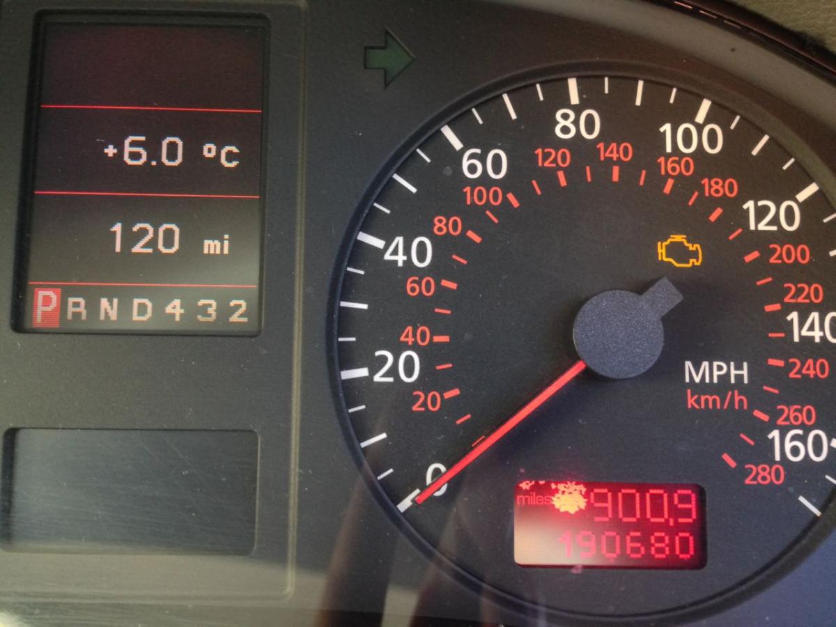

Looks like what my old Audi cluster mileage display did, something has got between the LCD and its backing, and the heating and cooling down causes it to move around. You could try disassembly, removing the screen and checking again. If you switch off and shine a torch at the LCD you'll still see the pattern because its permanent and not affected by power.

Similar effects on lcd screens used in commercial equipment when water gets on the conductive-rubber edge contacts.
Sounds plausible.
The windscreen would constantly mist up when I first got it so I assume it was damp inside.
I've had a few socks filled with cat litter around the car for a few months now, and it never mists up anymore so could be drying out the panel :)
My mk4 golf had this, I removed the lcd panel cleaned the pads with alcohol and it was fine for years.
Now completely fixed itself. Self healing Octavia :)
