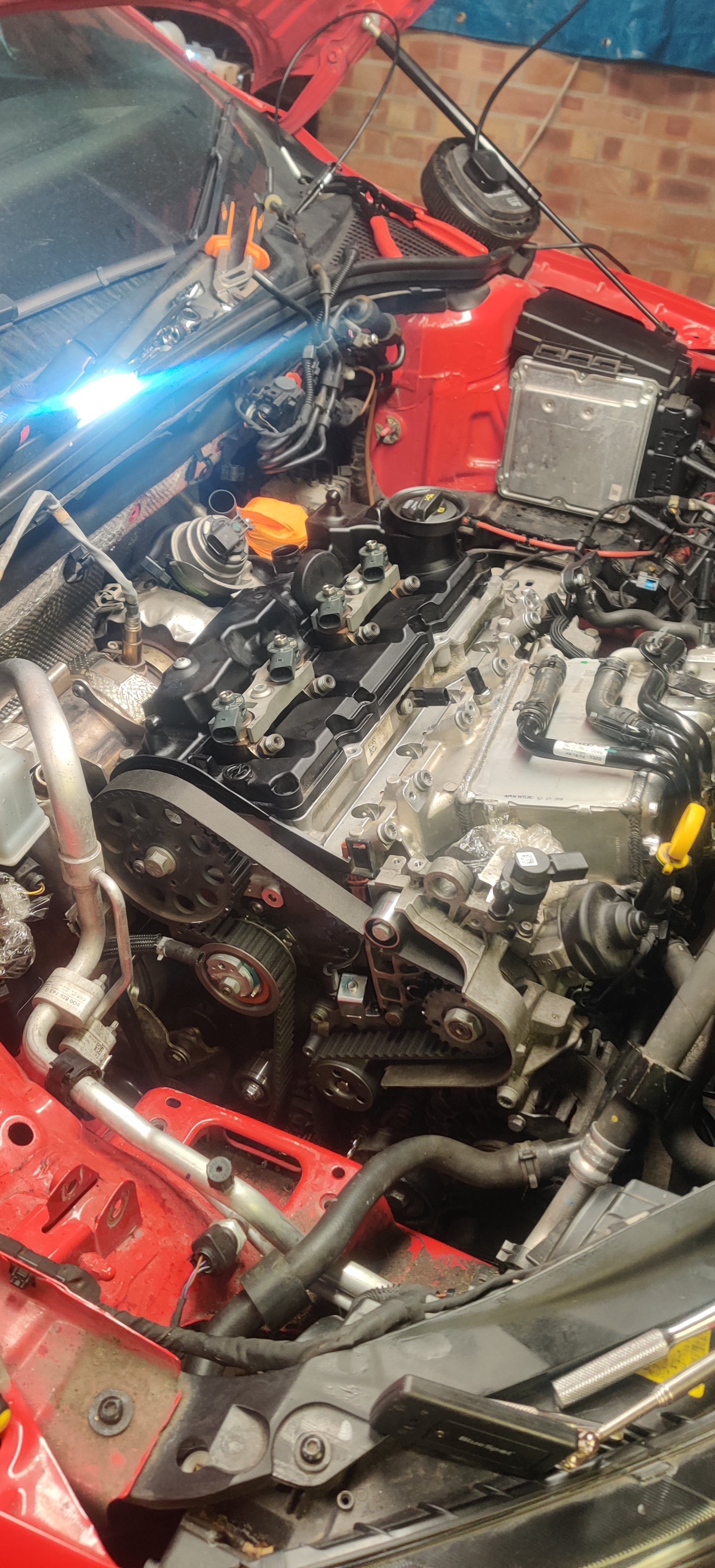

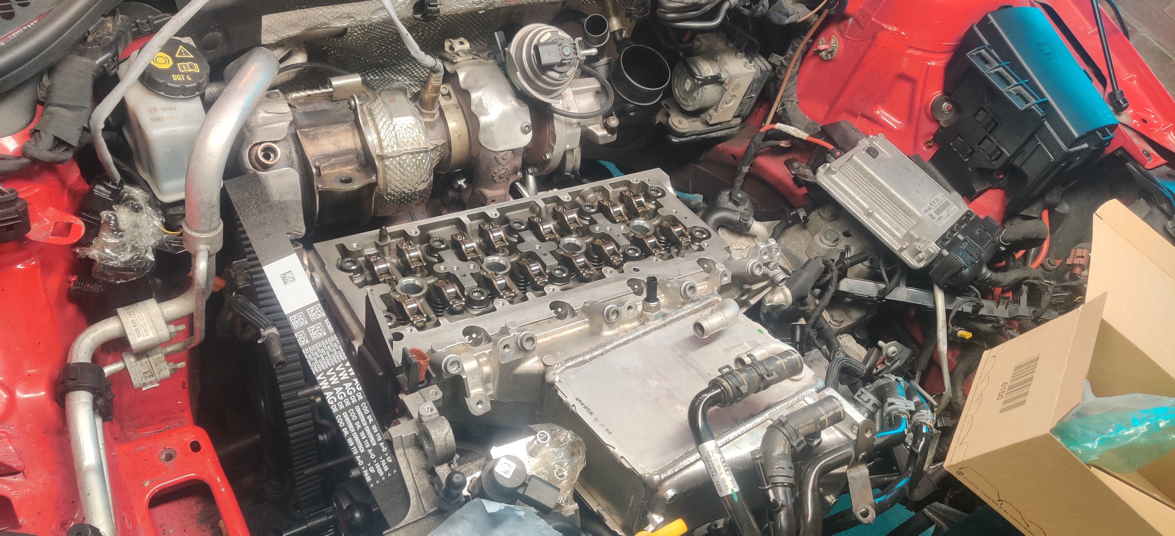

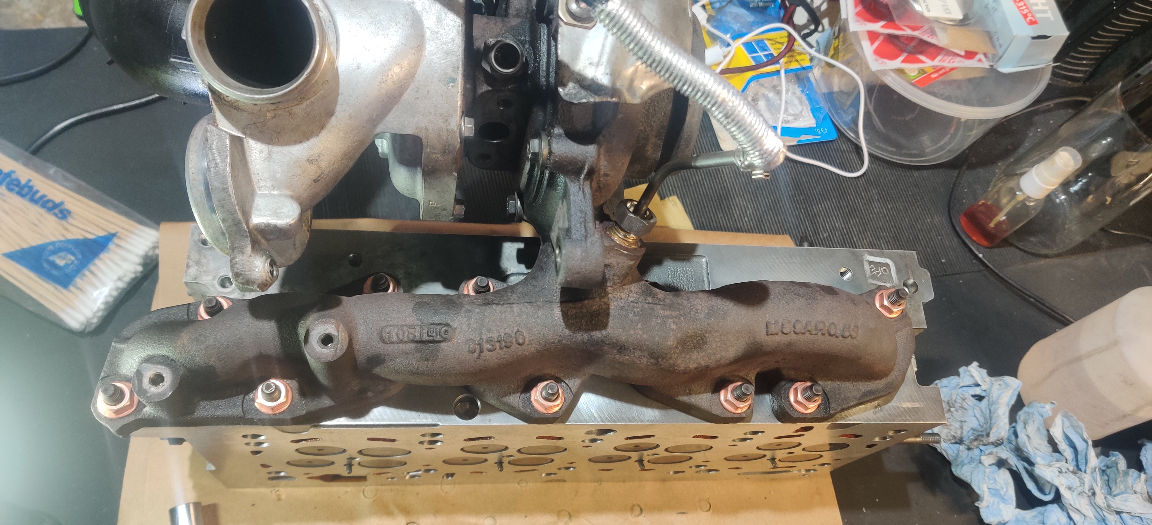

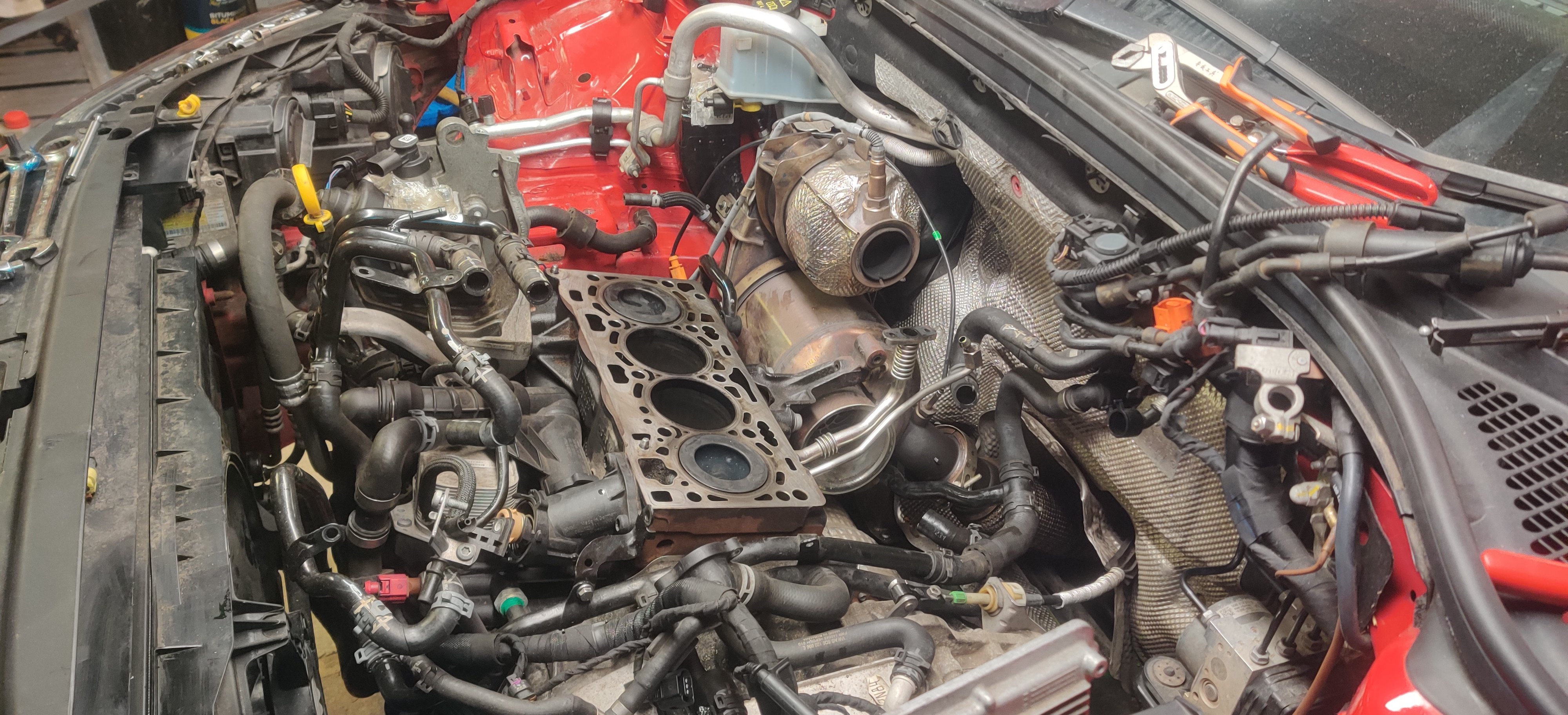

  7. For anyone interested, cylinder head was removed and pressure tested, found to be leaking through a crack between the water jacket and exhaust valve housing in cylinder 2 so not really repairable... 2nd hand head purchased pre-skimmed and valves lapped, pressure tested all good so fitted and engine rebuilt with fresh gaskets and new cambelt and waterpump kit. Up and running sweetly, no coolant loss apparent, hopefully it stays that way!
