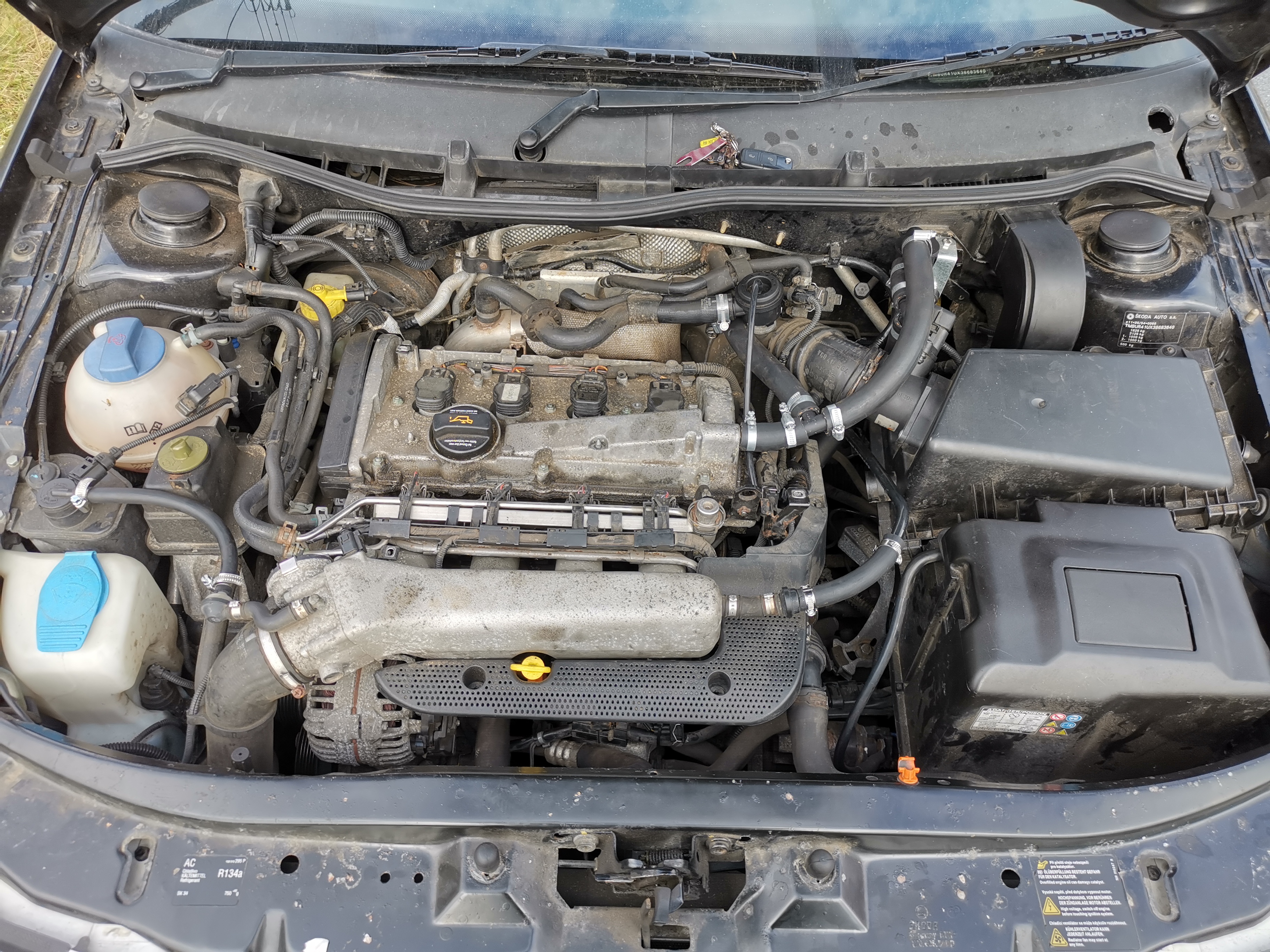

  4. Still need a new scuttle.. want a new expansion tank.. Not sure how to clean the alternator, they always look grim - buy a new one? Mr Muscle oven cleaner on the inlet manifold? Not into polishing, just not minging. Everything else can just get a wipe with groundnut oil. Catch can needs to move really too. I have a plan.

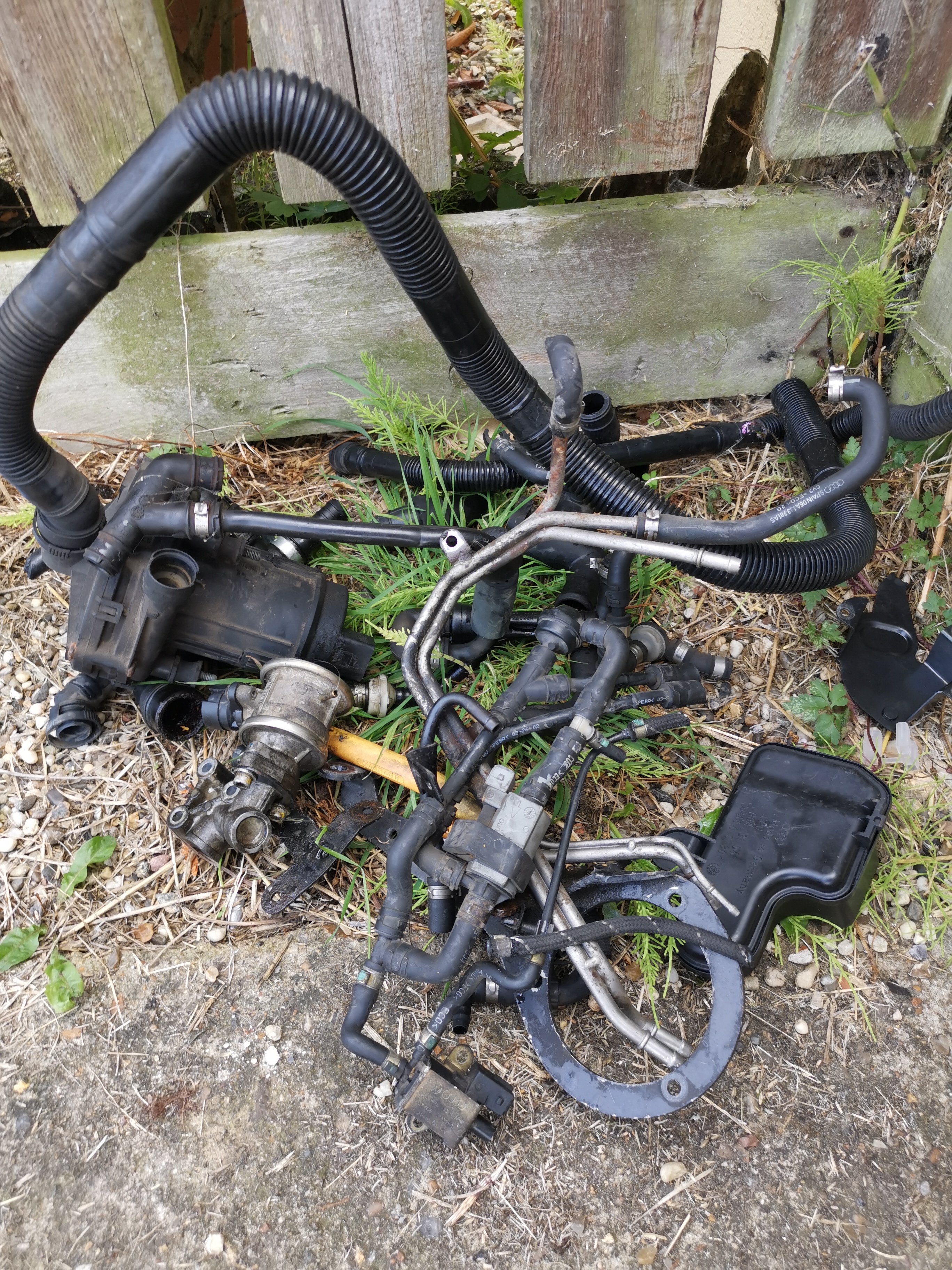

  11. I can sort of tackle some of this now... As well as Bowders guides on here, also have a read of this https://www.vwvortex.com/threads/diy-ultimate-sai-n249-pcv-evap-delete.4893472/ (but use Bowders) I did all mine over 3 days. It was too hot to do it in one hit and I did cop a bit of sunstroke... but you could do it in a day. Some of it overlaps a bit but you can work your way through SAI, then N-valves, then EVAP. You do bolt and unbolt a few things - well, I did. I was head scratching a bit until I had my hands on it, the SAI pump won't come out until you undo the bracket that's holds it up. I had, to hand, 2 metres of 19mm hose for the pcv and a catch can. 20 x 20-32mm jubilee clips (there was a few over) 1 tee, 2 elbows for the above https://www.ebay.co.uk/itm/222973159534?var=521778370377 https://www.ebay.co.uk/itm/222973159534?var=521778370378 ( 1m 13mm hose 1m 8mm hose and some clips for this too. 1m 3mm vacuum tubing - to connect the DV to the inlet manifold. New dipstick tube. One of these https://www.ebay.co.uk/itm/203291533297 (coolant flange, the CTS sits in it) There's an elbow under the inlet manifold - part #06A103213F you'll need an o-ring if it doesn't come with it (I also bought a new clip) A few holes will need plugging up... 1 in the TIP, 10mm bolt for that iirc and 2 need capping off out of the inlet manifold - underneath... I've just jammed some pipe on there and stuck a bolt in for now. I want to run a boost gauge from one of them. Oh... plugging up the hole on the airbox too... that's a big hole. I siliconed a piece of acrylic over it from the inside - there's probably a picture on my thread.. Think most confusing, for me, was that I expected everything to be at the front of the engine and it wasn't. Once I found everything it wasn't too bad.

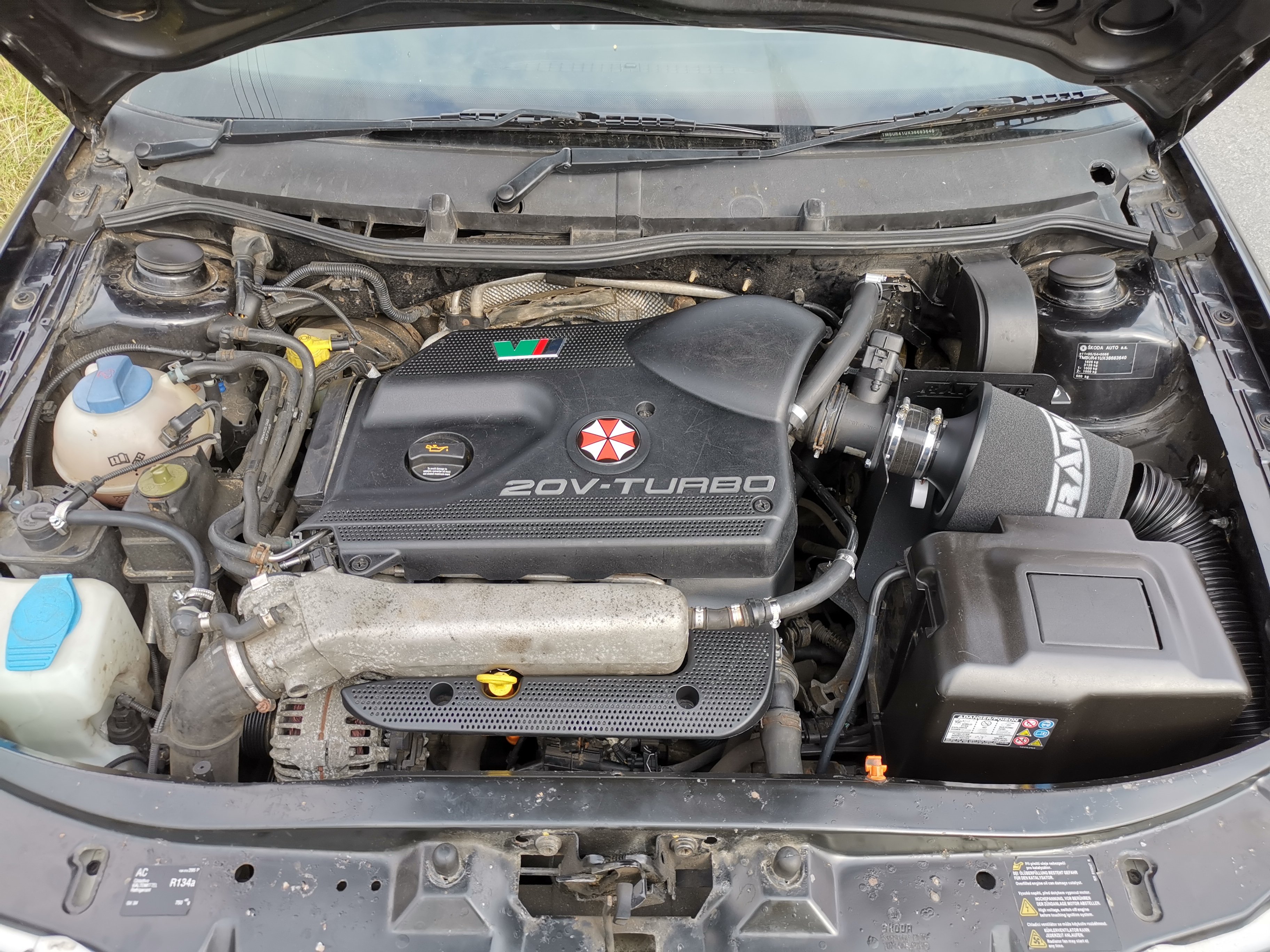

  16. It's in the plan.... never really tarted an engine bay up before.

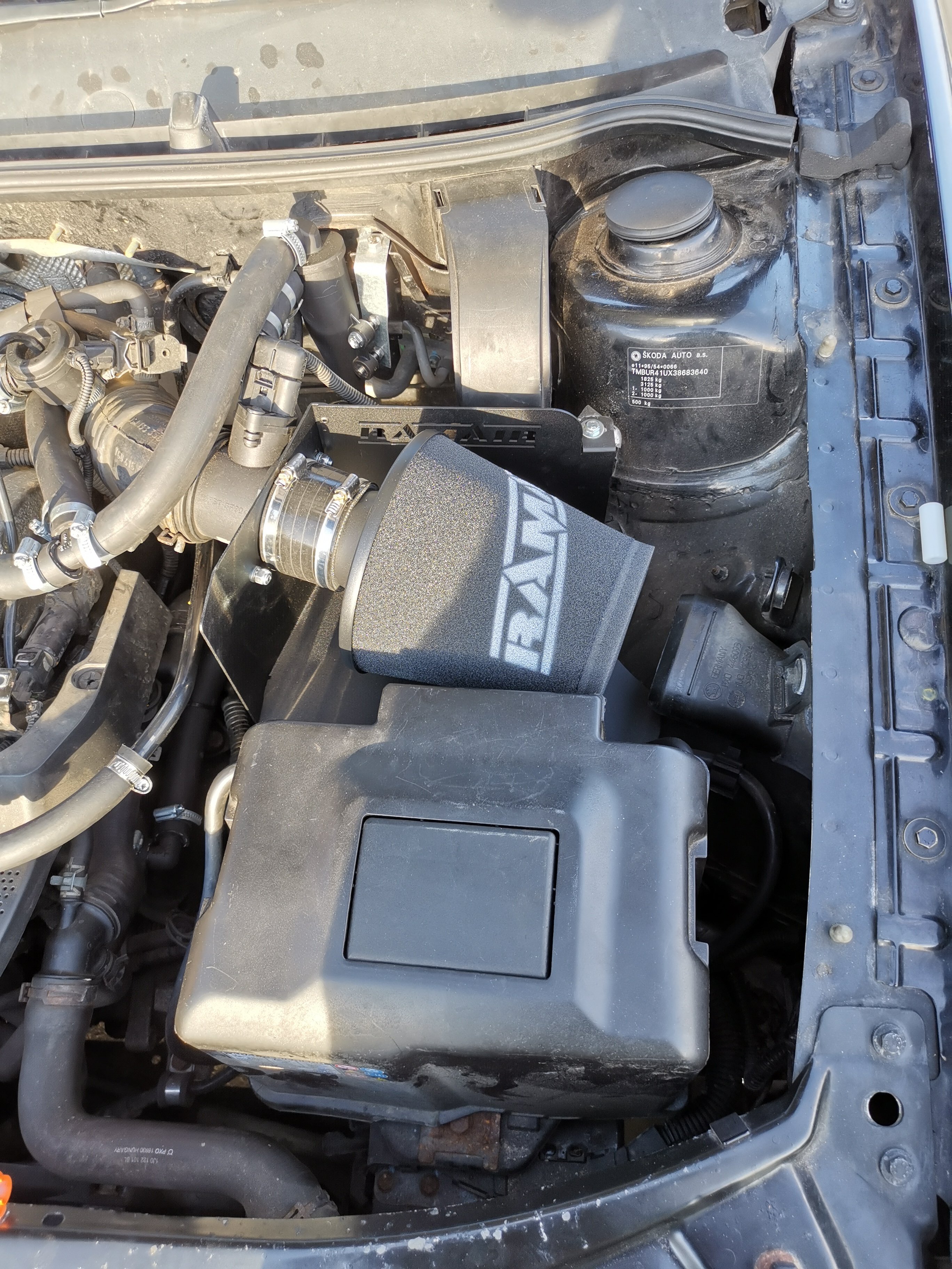

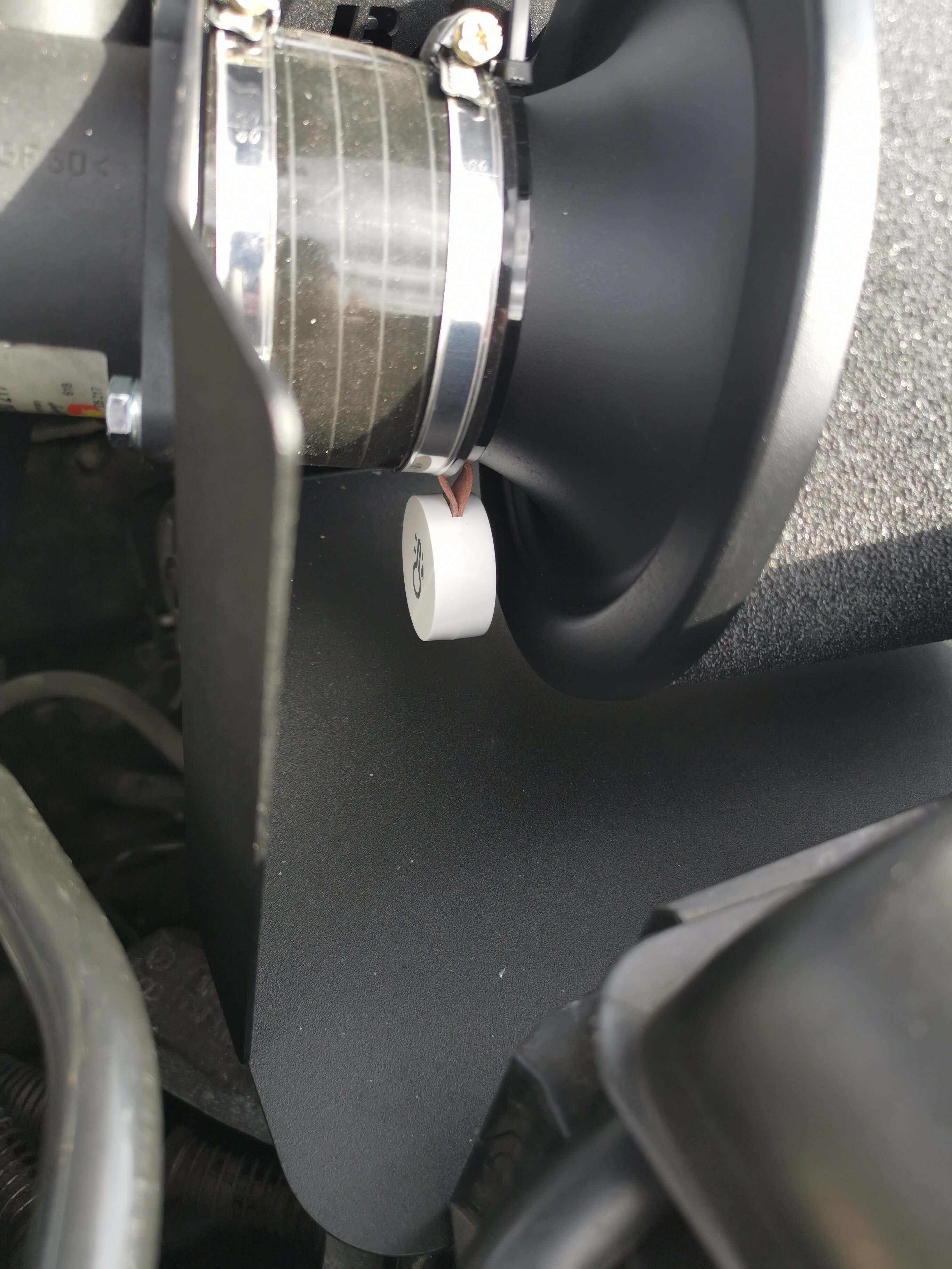

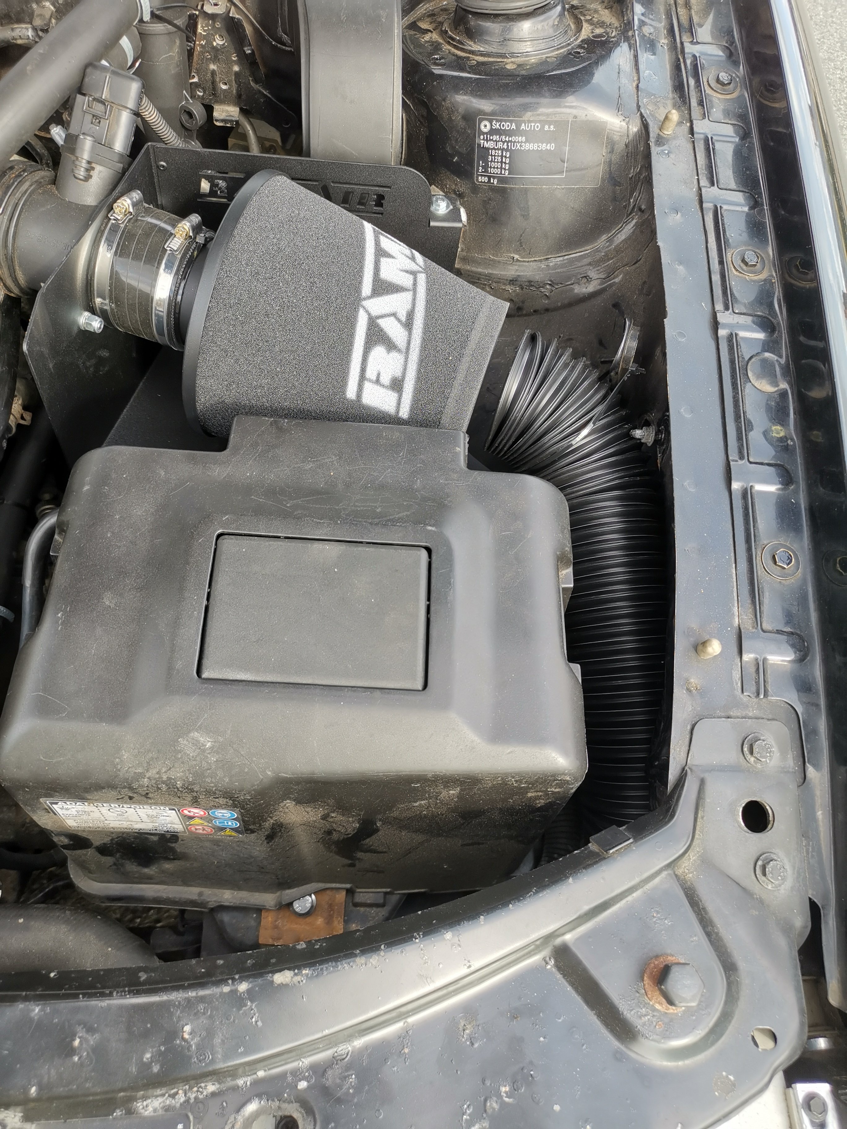

  18. mainly talking about the mk1 petrol cars but I guess it'd apply equally to others. Wondering if anyone knows, or has a rough idea, of temperatures reached inside the airbox of a petrol car. At running temps.. When cruising on the open road Sat idling for 15mins (after being thoroughly warmed up) Or, failing that, is there a (rough) temperature when power really starts to be affected?

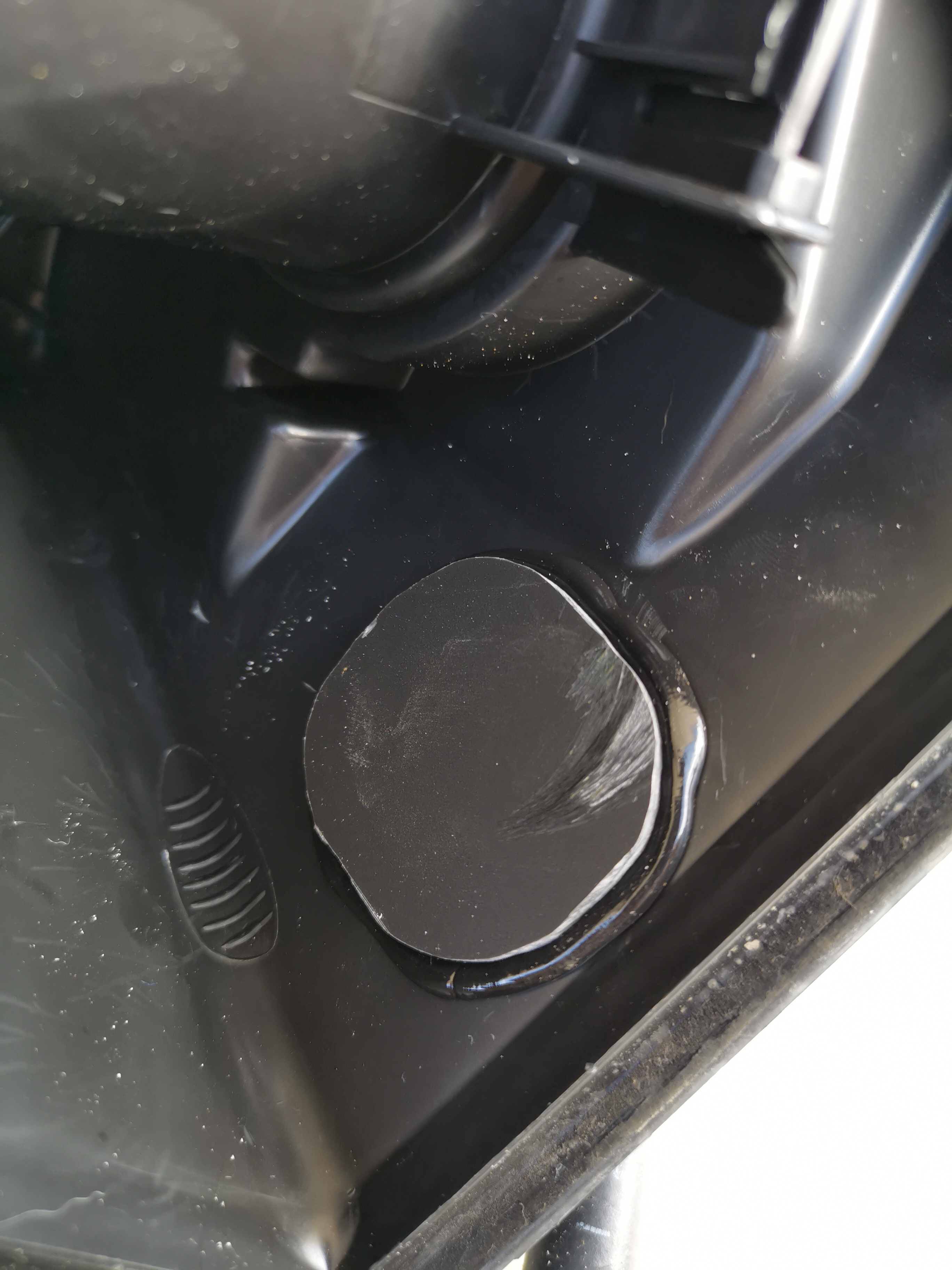

  19. Air feed implanted.. So pleased the headlight didn't have to be removed.. I've been getting some stick (elsewhere on the 'net and because of 2 decades of preaching against cone filters) about heat soak so I've dangled a wireless thermometer in there for s**ts and giggles Whether it'll work is anyone's guess. Not really fussed.. Still looks OE (and tatty-ish) from the front

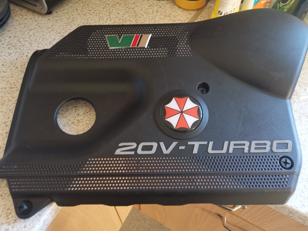

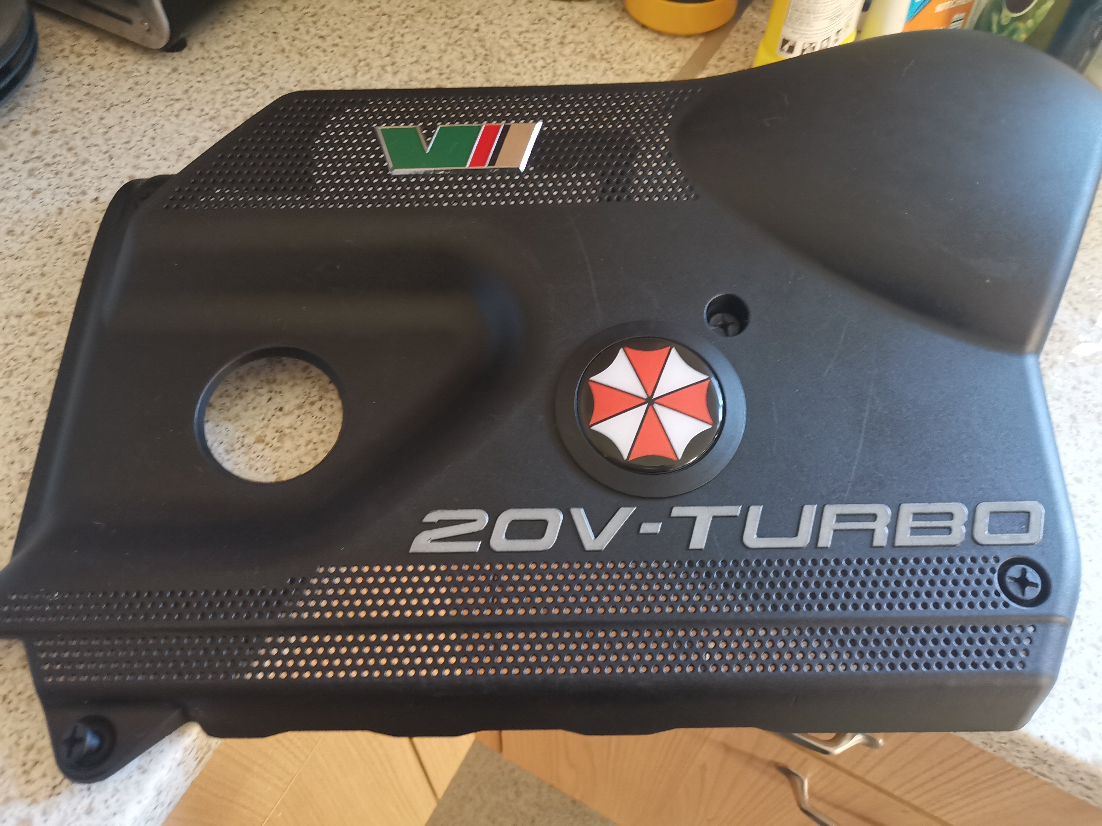

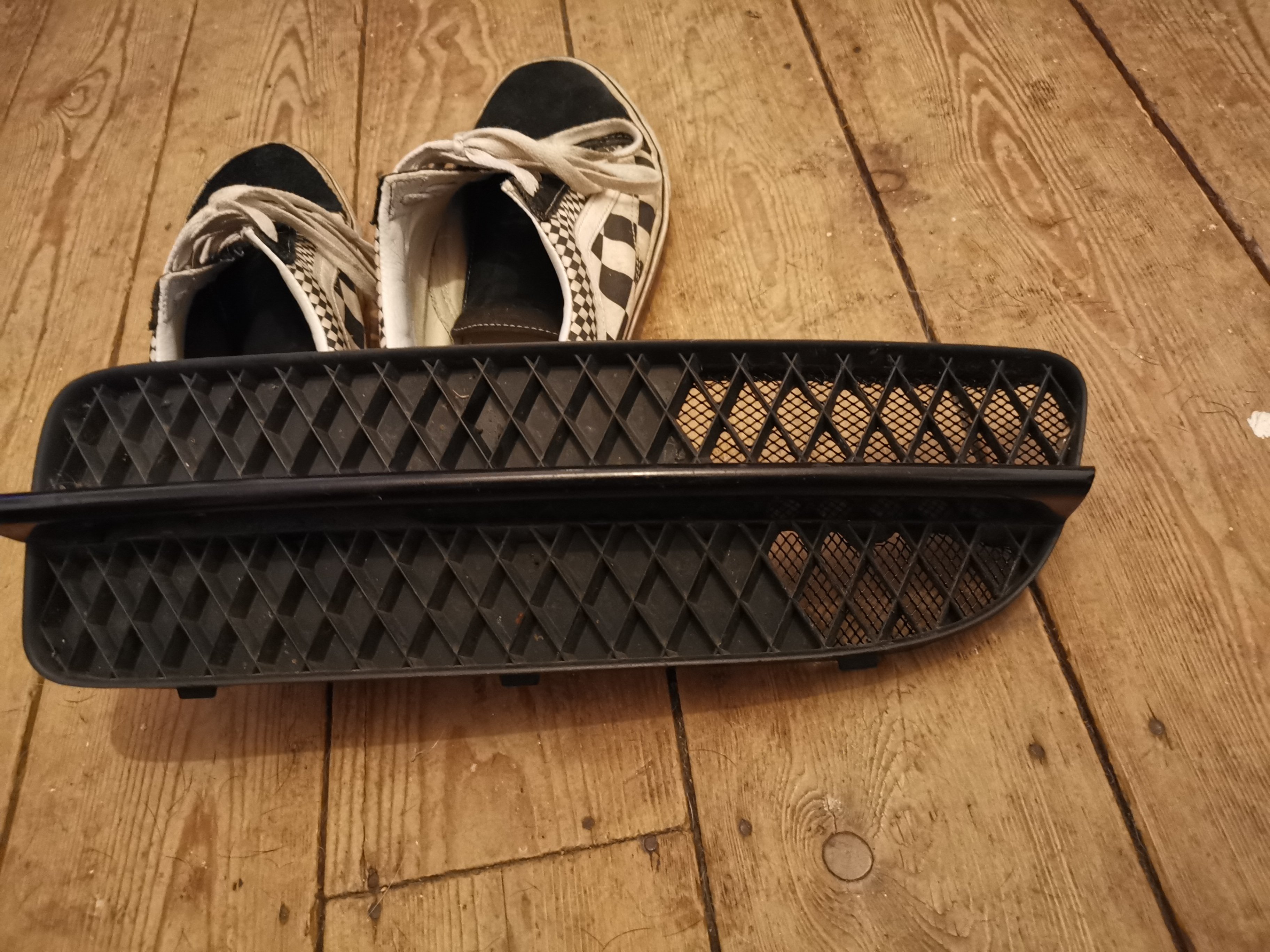

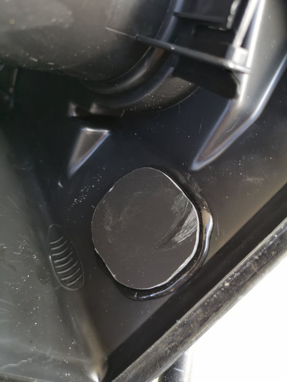

  20. I'd have to hit them pretty hard to get water through that cone but I hear ya... last one I did I took from under the bumper of a V6 Cavalier - blimey that was about 20 year ago. 😲 Drilled the holes for the strut brace too, forgot to get pics - the rustoleum is just curing before I fit it. And I have a K-brace to go in too. And the list of parts still to buy just keeps getting longer (and nobody wants to give me a job).. coil packs next I think. They don't match and my idling's just a little uneven.

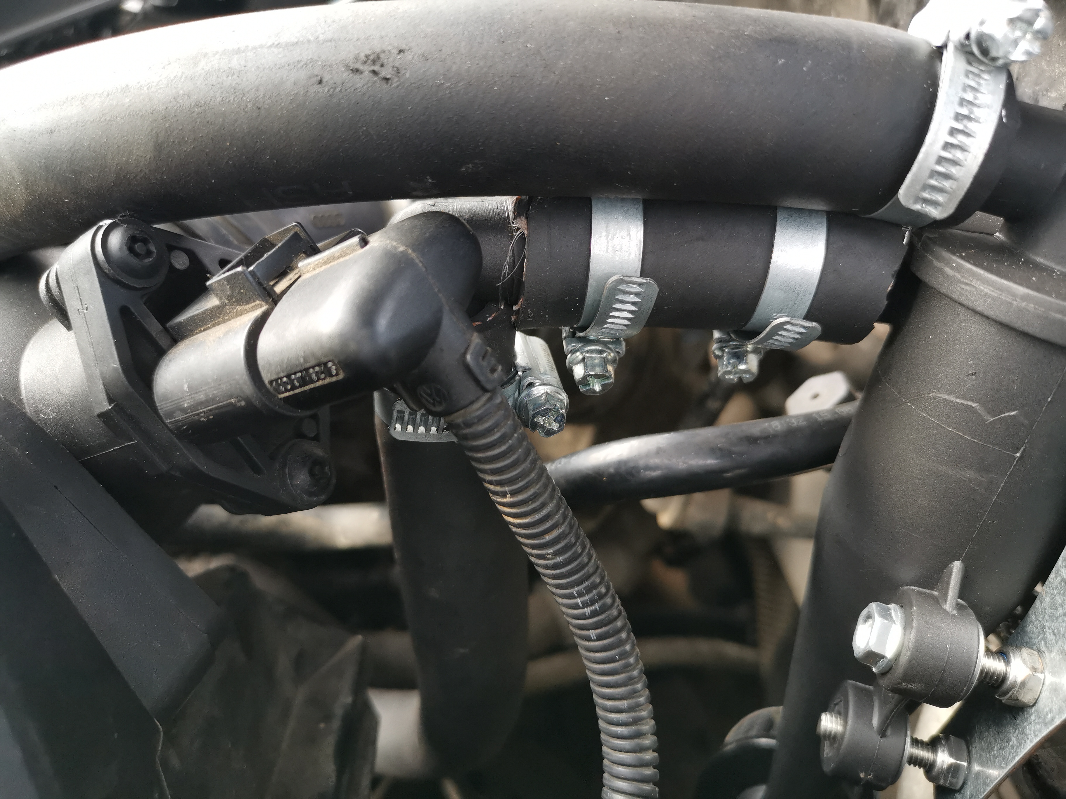

  21. More things have happened... I contacted Rtech about pre Stage2 checks/upgrades and tried to get one of their CAIs, as advertised on their site. They don't do them any more but suggested a Ramair kit. Ramair it is then I'm also working out the bumper fed cold air feed but still want to maintain the original look... Not noticed an increase in induction noise but if I drive gentle there is a lazy whoosh..
