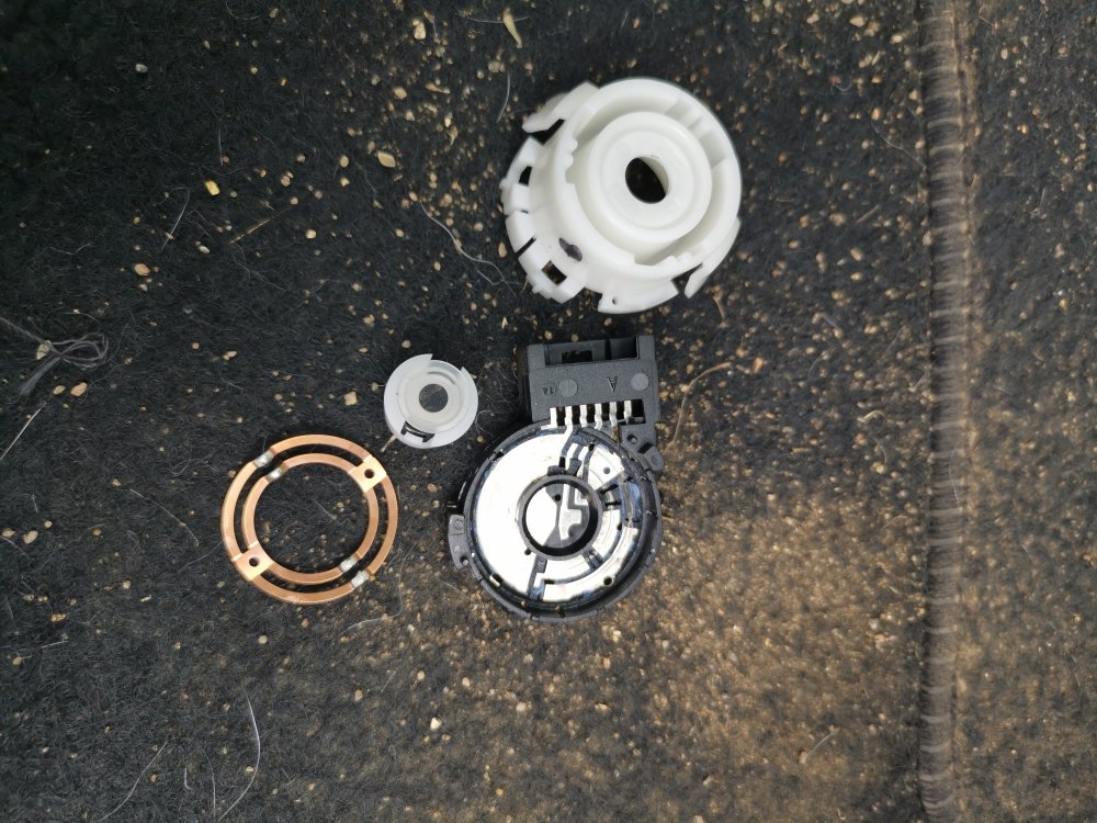

  4. New switch arrived, got it fitted and car fires straight up... Still got 2 relays arriving Tuesday because they're cheap and known to be twitchy.. Thanks for all the input (including @J.R.) I appreciate every reply.. Added a pic of how the old one came out, in spite of using picks to depress the clips..

  8. Gotta say... steering wheel off to remove cowling seemed excessive but nobody called him out on it so I moved on. New switch ordered (aftermarket, not genuine, should be here Monday). Swmbo can use my car til then - it'll cost her a fair bit more in fuel but it'll get her to work and back for a few days. Fingers crossed that'll be it .... thanks for the assist, much appreciated 👍
  9. Yep.. makes perfect sense (I think the failing relay scenario fits too, having read a few things in the last dozen or so hours).. If it's that easy I'll change it anyway.. thanks.. off to find a part number. Read another thread on here earlier that said the steering wheel needs to come off to get the cowling off. Not really up for that tbh... maybe a few year back but I really cba any more.
  10. It seems exactly like that tbh. But for one thing. If I leave it sitting ignition on the dash lights randomly come on/go off. If they're on and I try to start the car they go off. Every time. I swapped the 2 460 relays this morning and things improved. Dash lit up immediately. Couple of problematic starts but then about a dozen perfect ones. Going to order 2 new relays from the local dub dealer. Don't know what else to do.

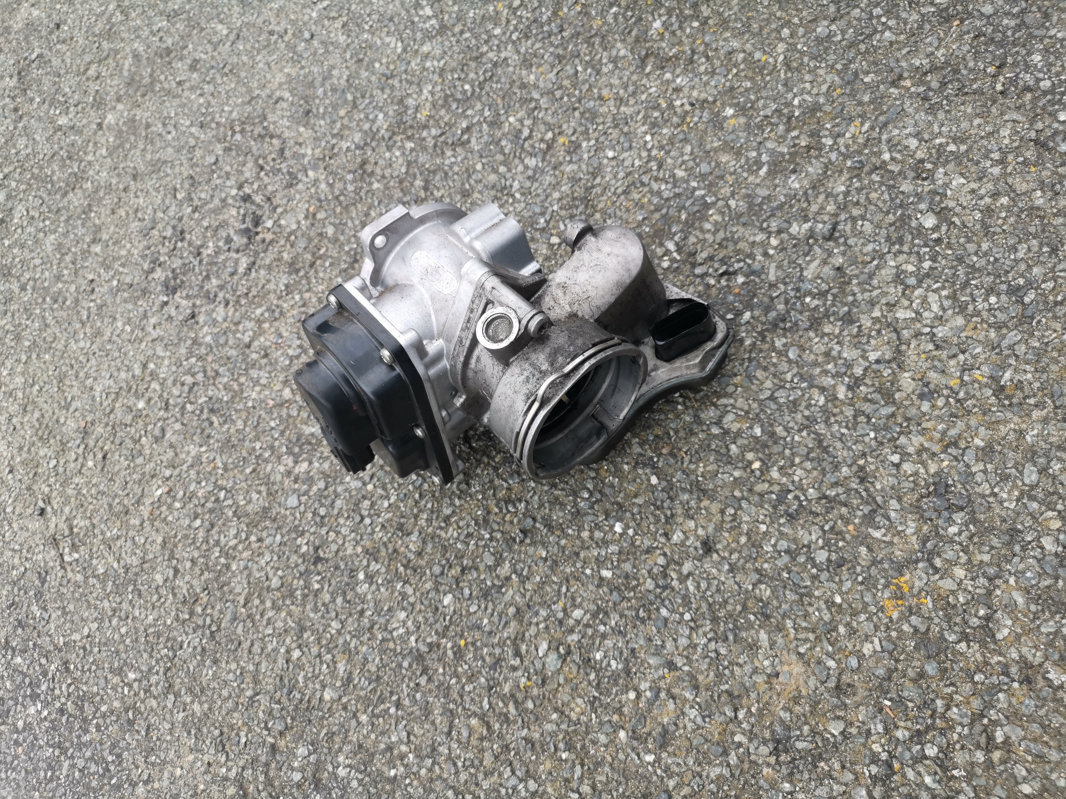

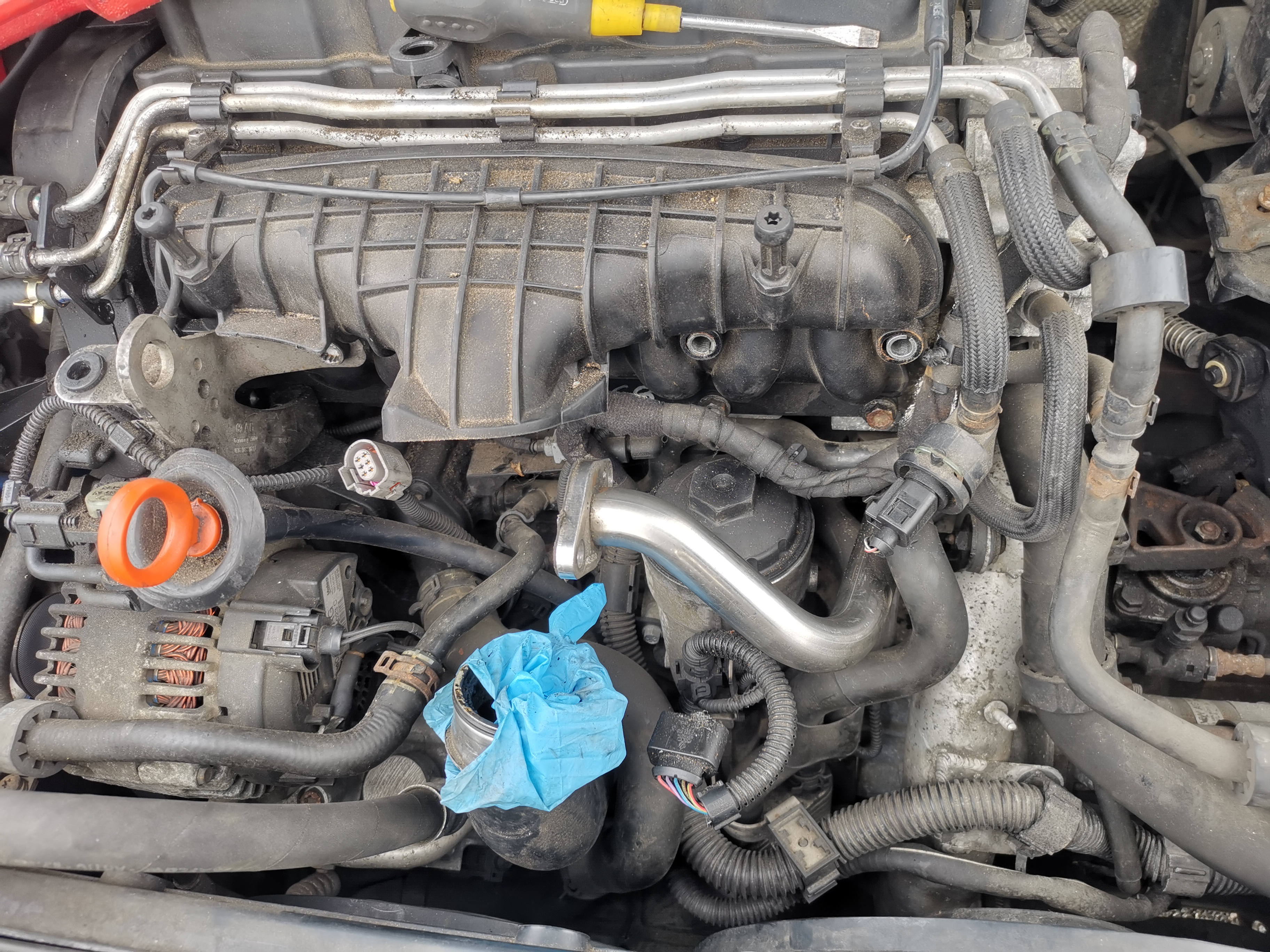

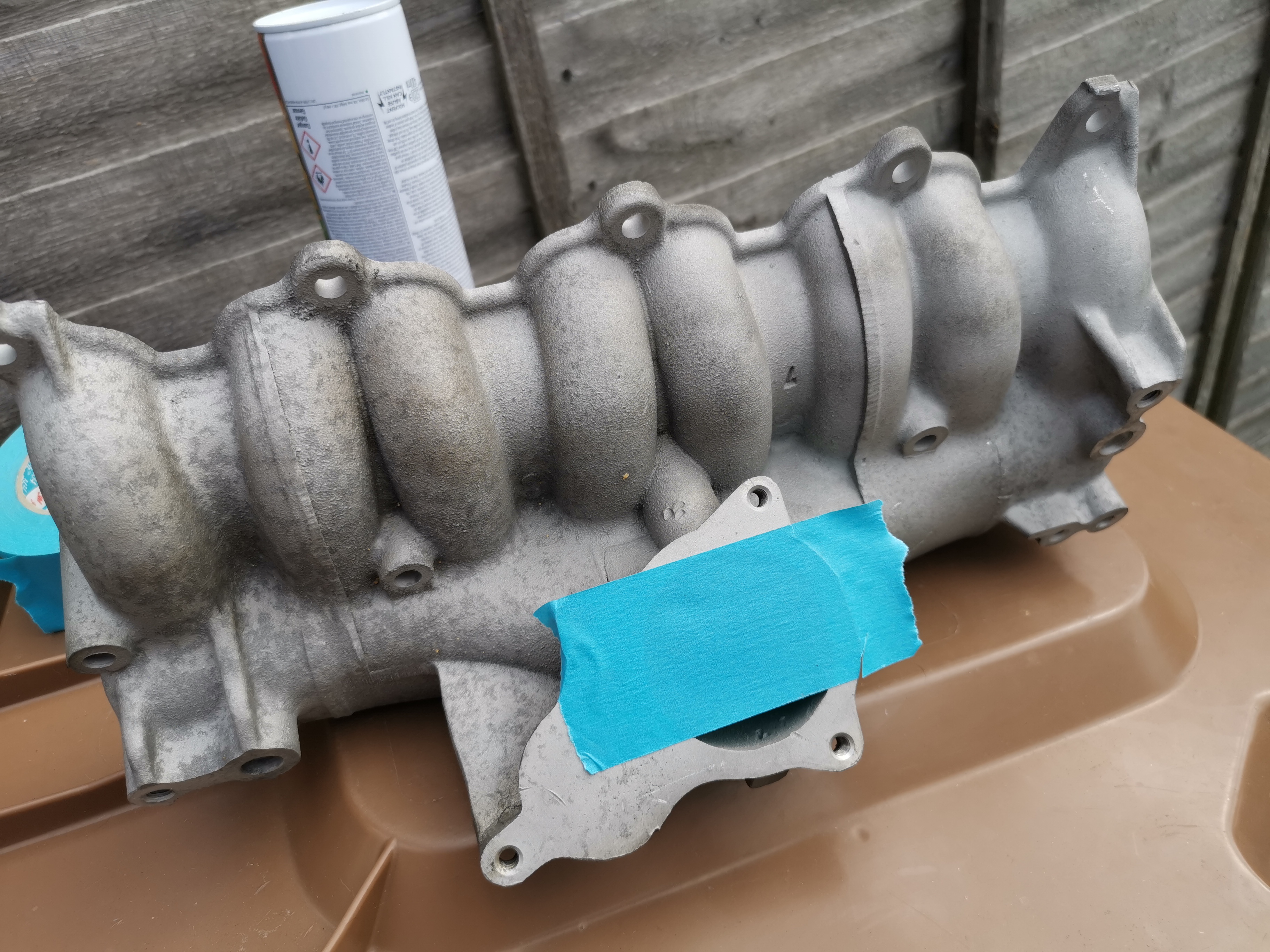

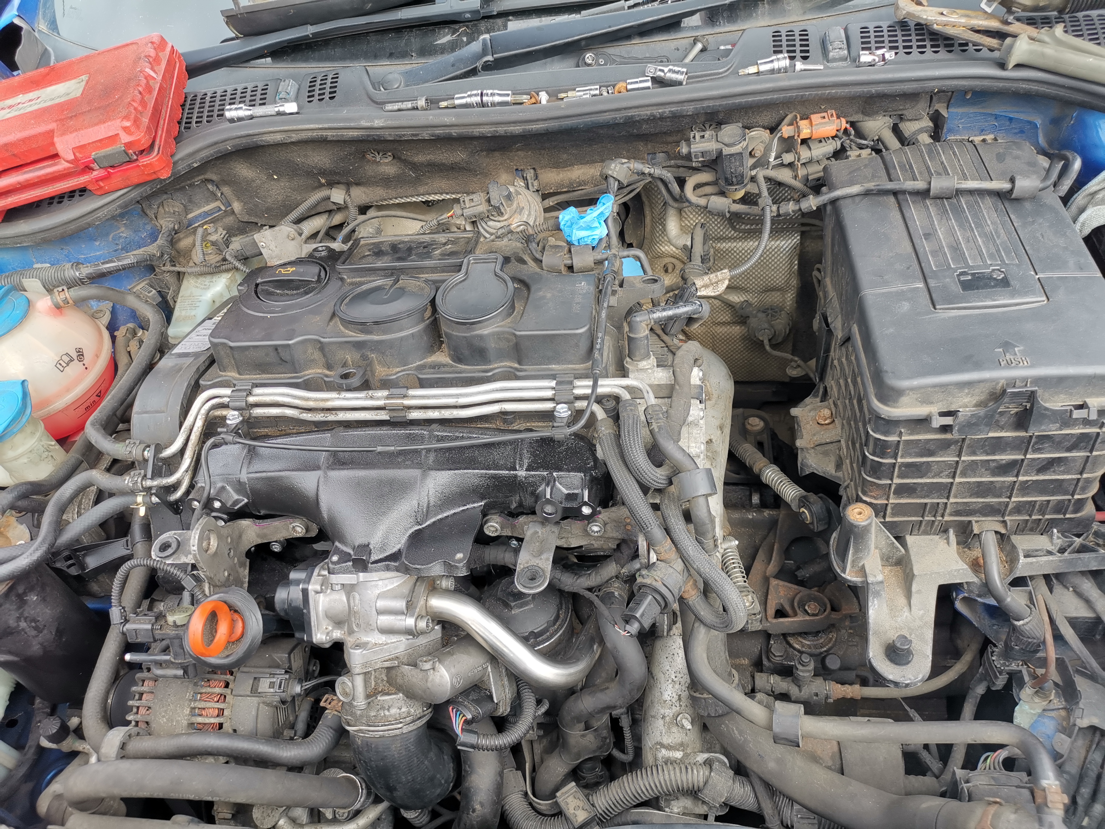

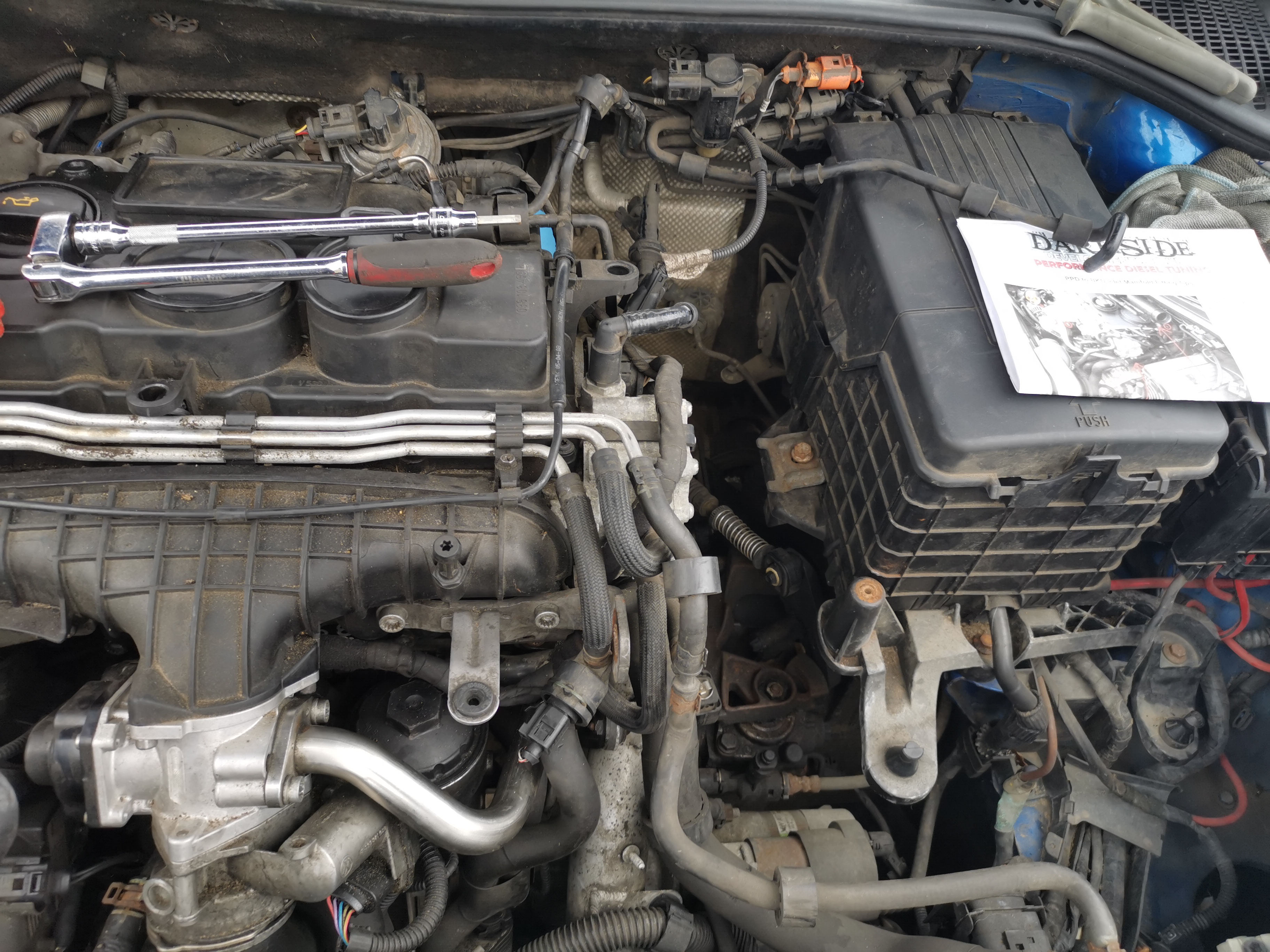

  13. Evil replied to Evil's topic in Octavia Projects

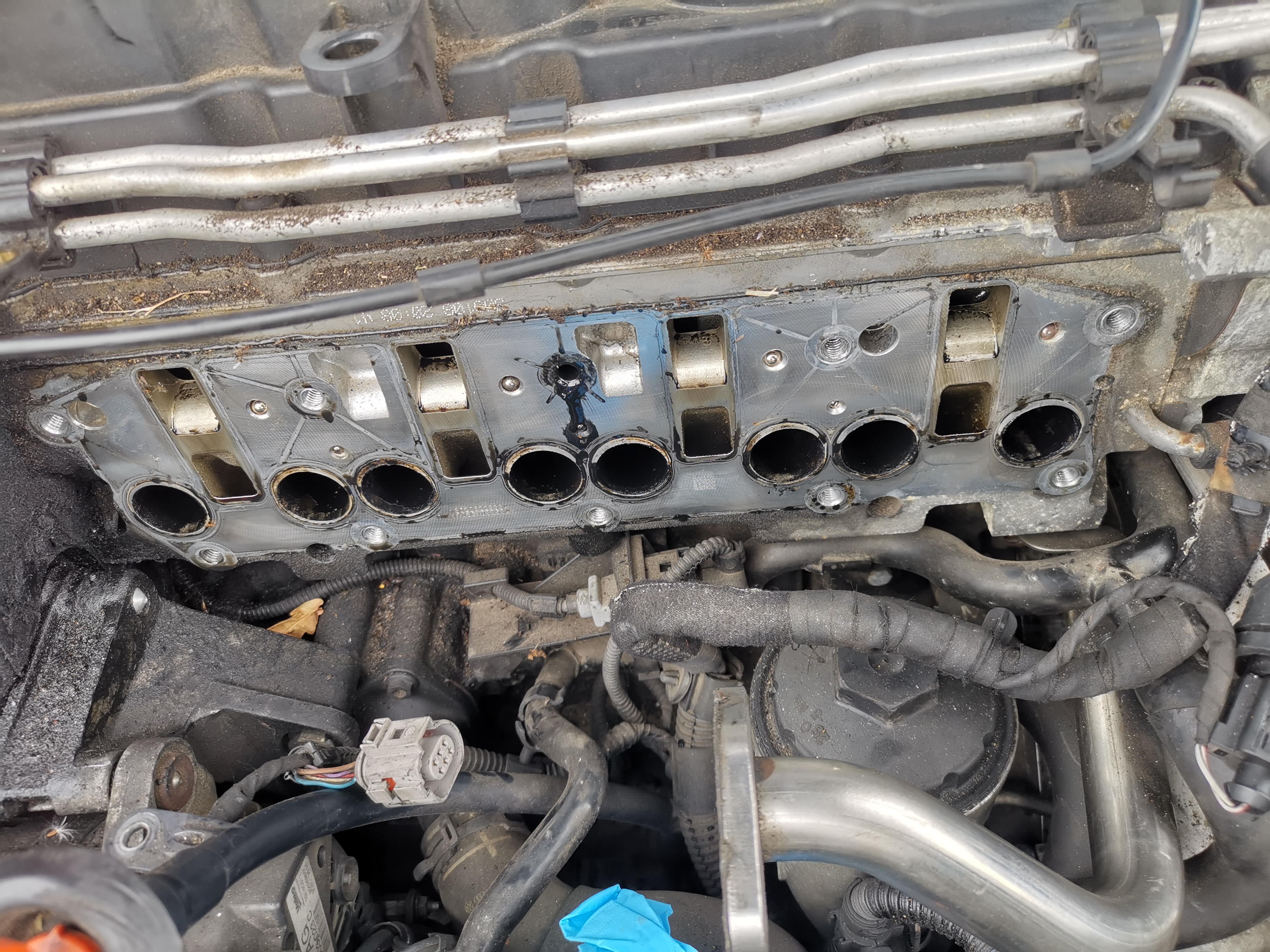

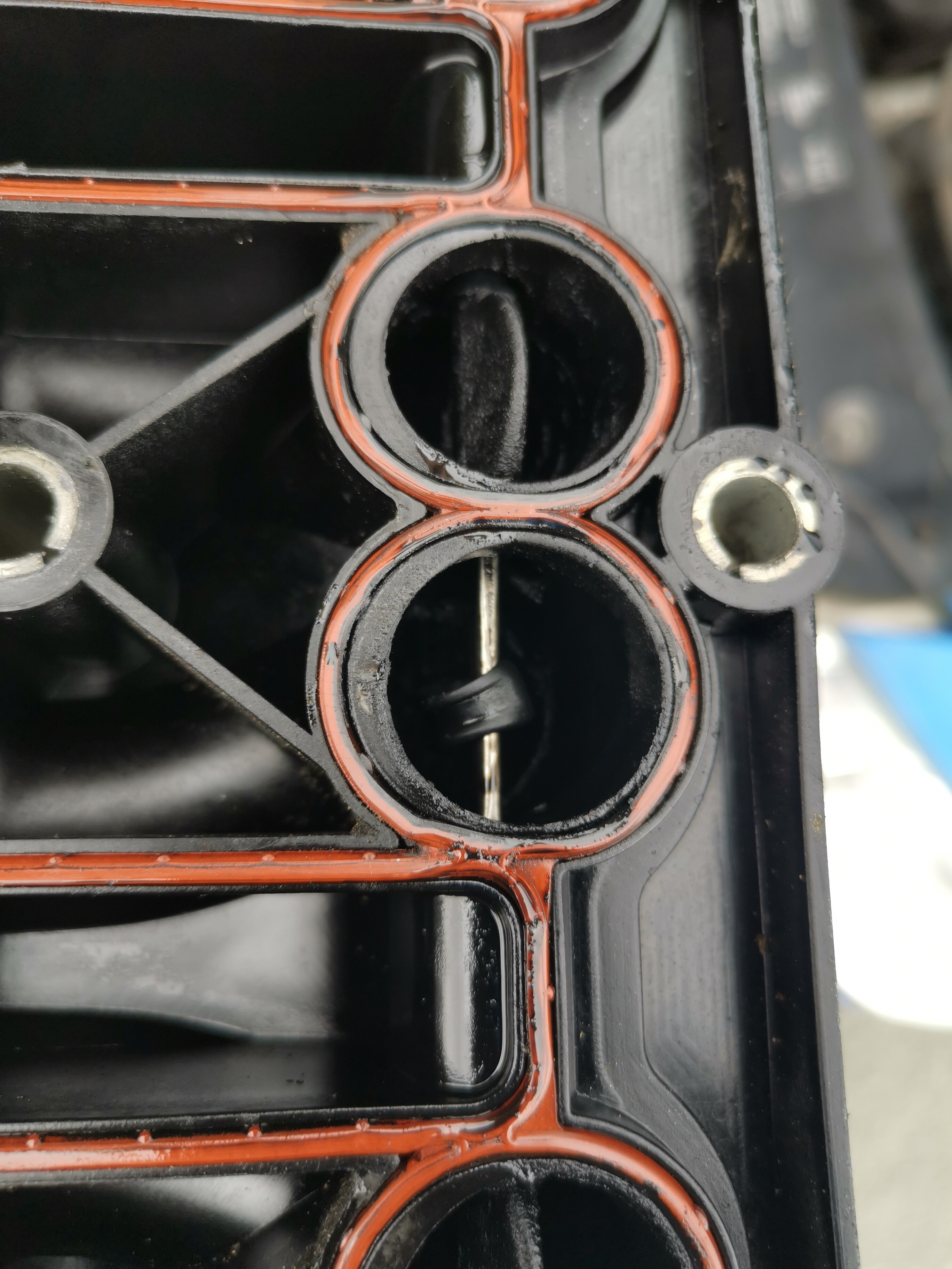

    Today was the day... Off with the original swirly flappy inlet and on with the BKD no flappy inlet. Not madly impressed with Darksides instructions tbh but we did it.. And got pictures too, much to Kirstys irritation... Ta daaaaaaaa..

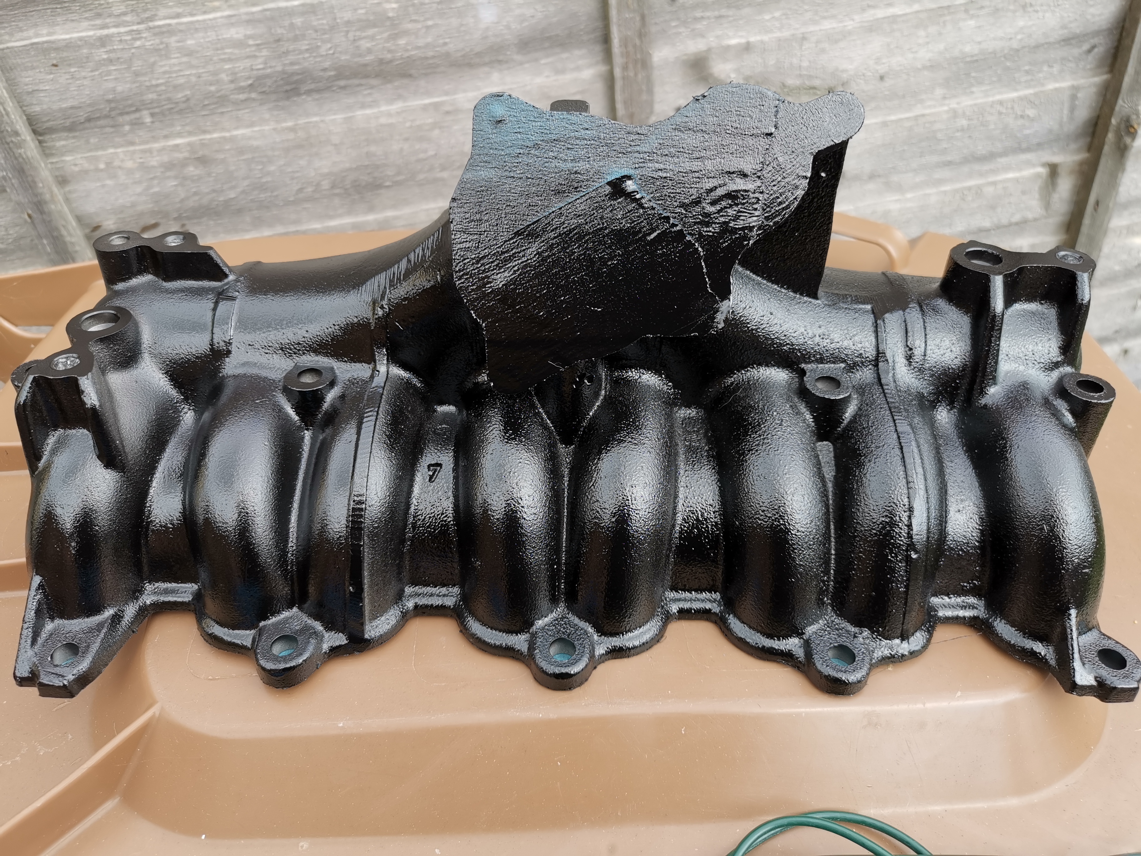

    And now it's black. Because that's what she wanted.

    In an effort to fix the won't pull past 3.5k revs issue (no codes, no nothing, runs lovely, mpg is normal) we're deleting flaps... Hello Darkside, take my money..
  22. It's had 1 coat of Hammerite Straight To Metal now for a liberal coating of Plastikote before I say a prayer and mark up my turrets... gawd help me.
