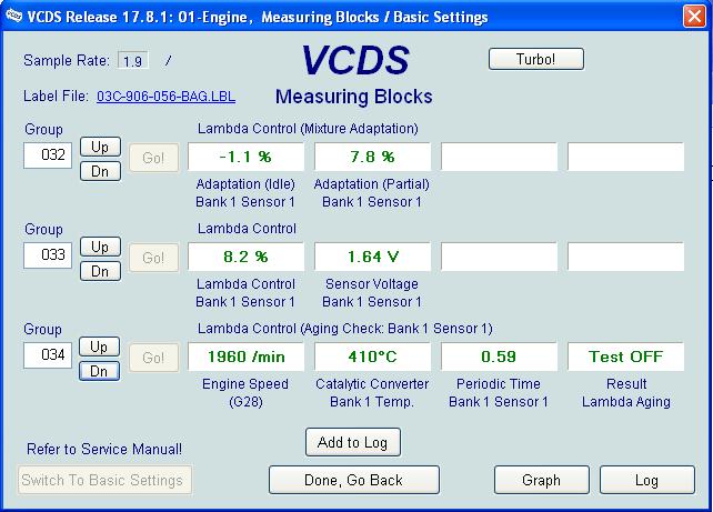

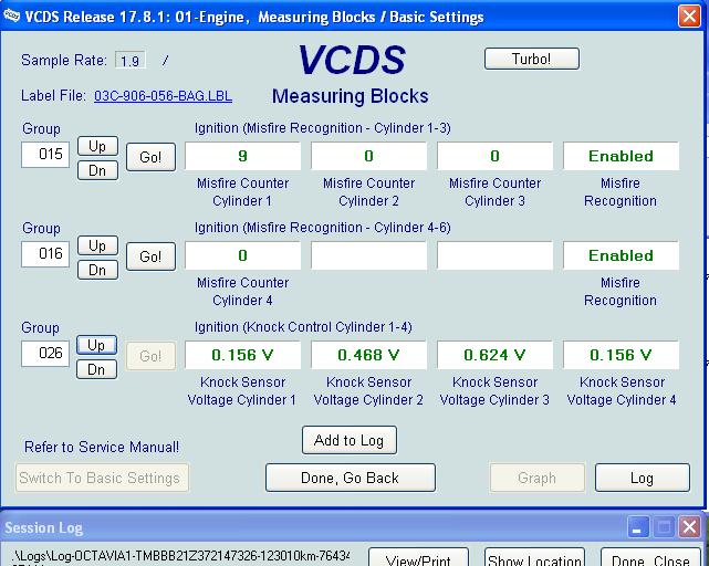

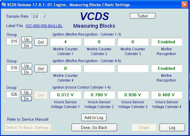

I have had VCDS scan thanks to Briskskoda and below are some results. Shows misfire count in Cylinder 1. Also post fuel trims and full log is attachedOctavia2.JPG.6f98e54160689d5b8901afcb9133f5c2.JPG:
Octavia1.JPG.20713cda6375c47d5fb7d7dee1a4af8b.JPG.
Please advise, where do I go from here. I am interested in the cure.

Duel mass flywheel?
I would swap the injector from cylinder 1 into another cylinder, you have looked at most other things so this seems the next logical step.
