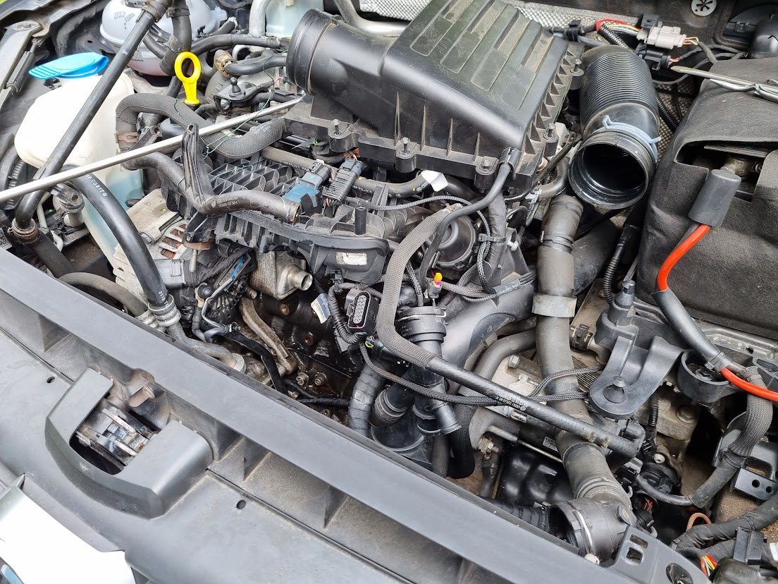

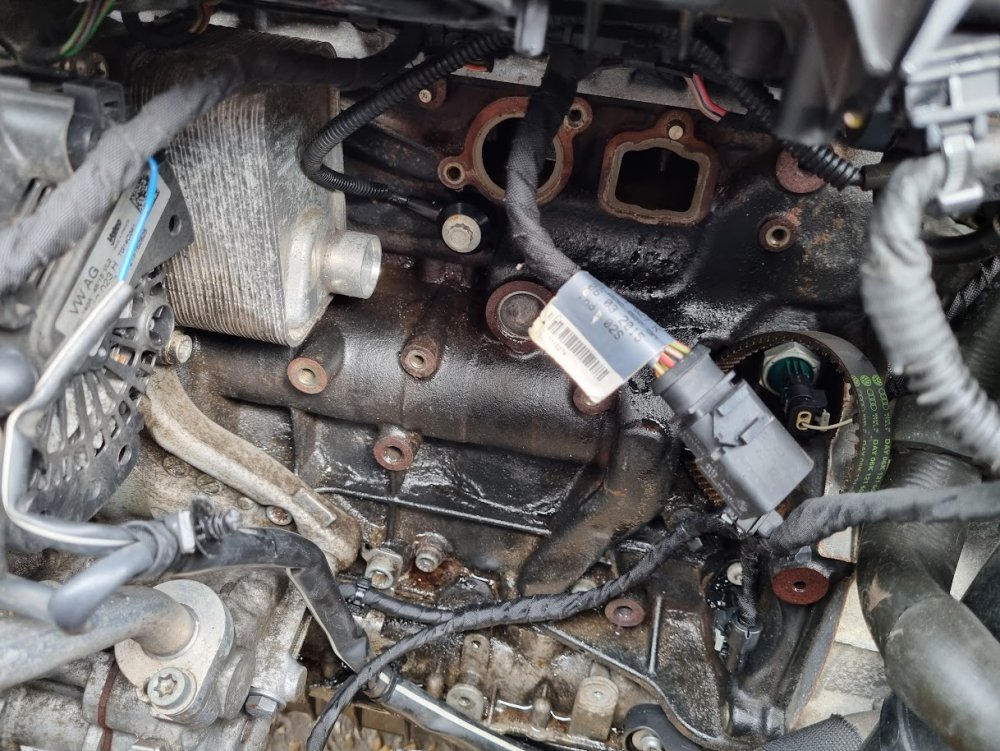

Here you go, these are the parts that were done on mine. They did say the damn things were buried and a lot had to come off.

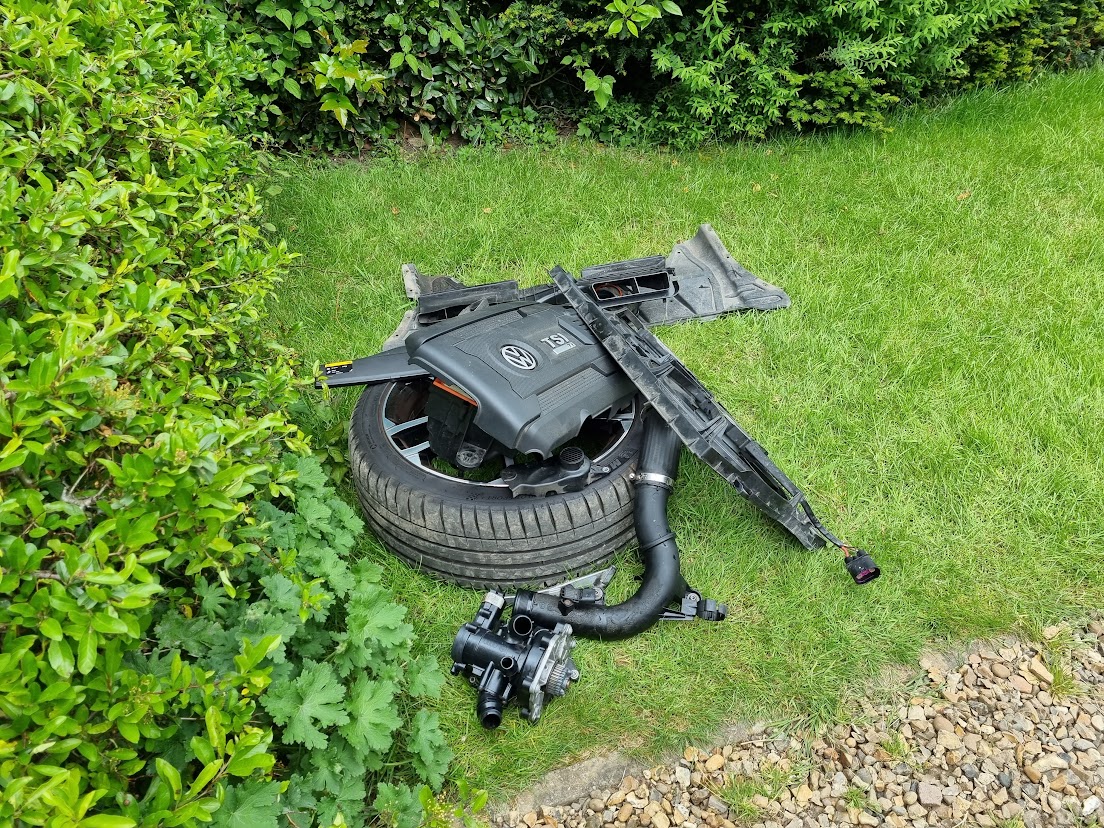

To be honest, if you look on the grassed area in my photo of parts removed,   you will see the module with the waterpump bolted up. the waterpump I'd already alloy. It is the inners of the module workings that seem to fail  like the plastic seal bushes and so on. In my case they eventually leak into the pcb and its then fried. In other cases I've seen it still tends to be the workings of the module, rather the water pump itself That leaks. So I think your stuck with replacing and expecting a very strong possibility of  failure in a similar time frame. Mine did about 6.5 years, 75k miles. But some element of failure will be duty cycle related...
