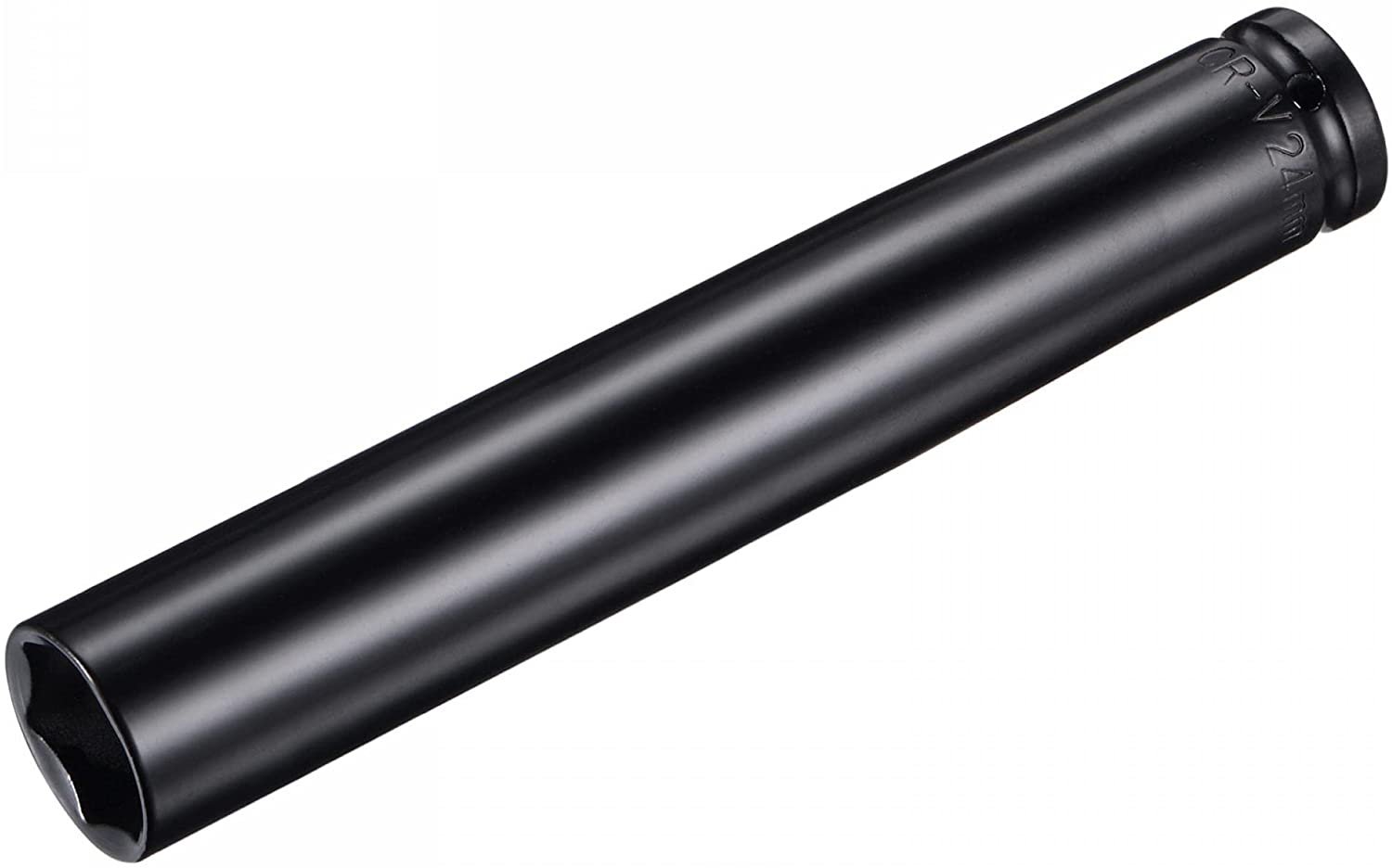

Superb 1.6tdi 2013 Oil Pressure Sensor Location
I am sure that is the engine lift bracket held on bt 3 bolts one is a triple square.. Or 24mm thin walled deep socket from Amazon
