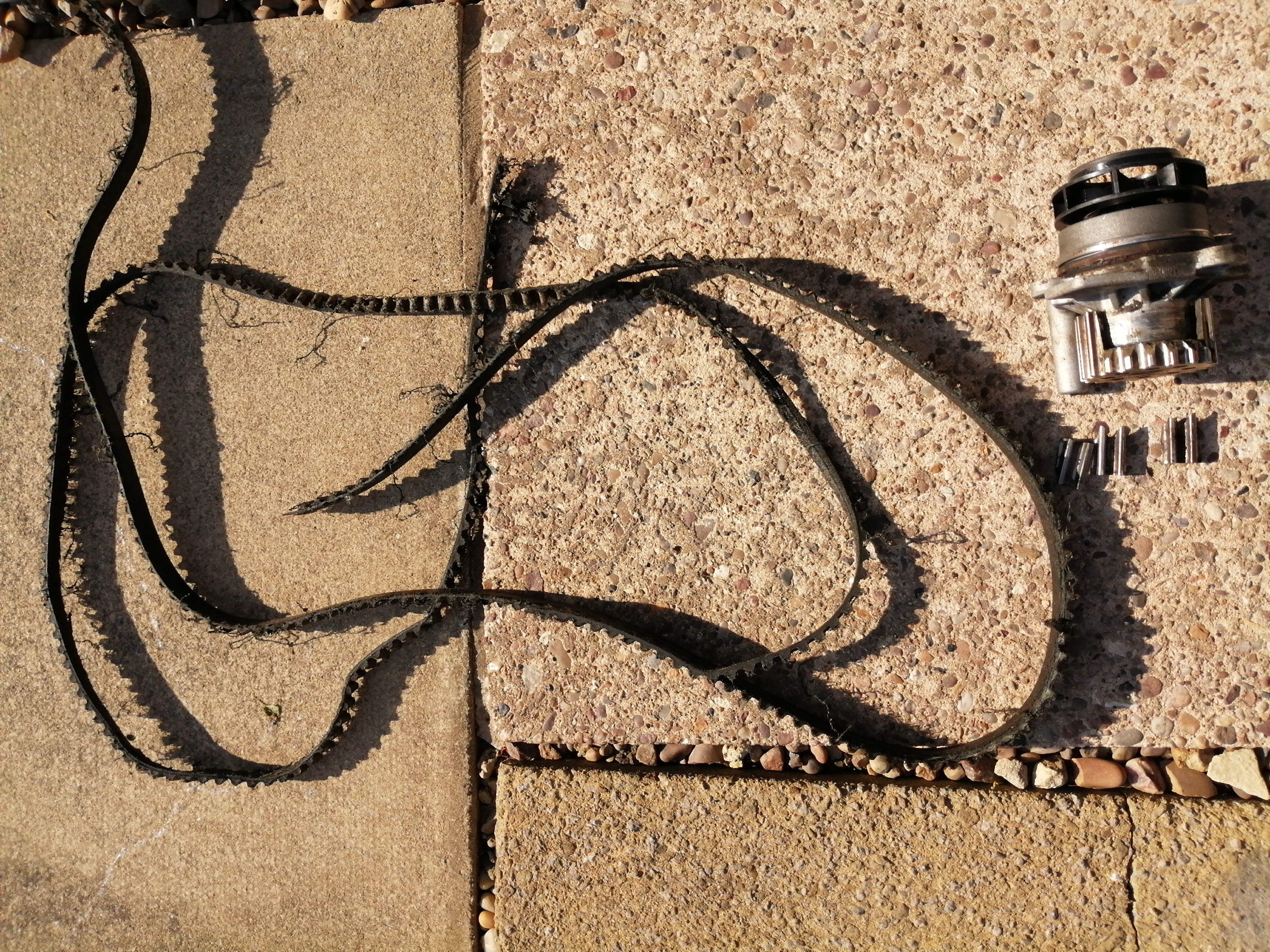

  18. Hi fitted the water pump all the pulleys and the belt that was a sod to get on, figured out the timing turned the crank with a spanner no interference, made sure everything was clear, and went for it, it started first turn of the key and ran perfectly!!, what a relief actually brought me to tears. Could not get the bolt undone from the crank to change the oil seal, so put the engine mount back on took it to a local garage that had one of those hammer guns that undid it, so I will be changing the oil seal tomorrow and putting it back together, I know it means taking the belt off again but at least I know the engine is ok. Thanks to everyone that commented and gave advice. It's been quite a journey and an emotional one as well.

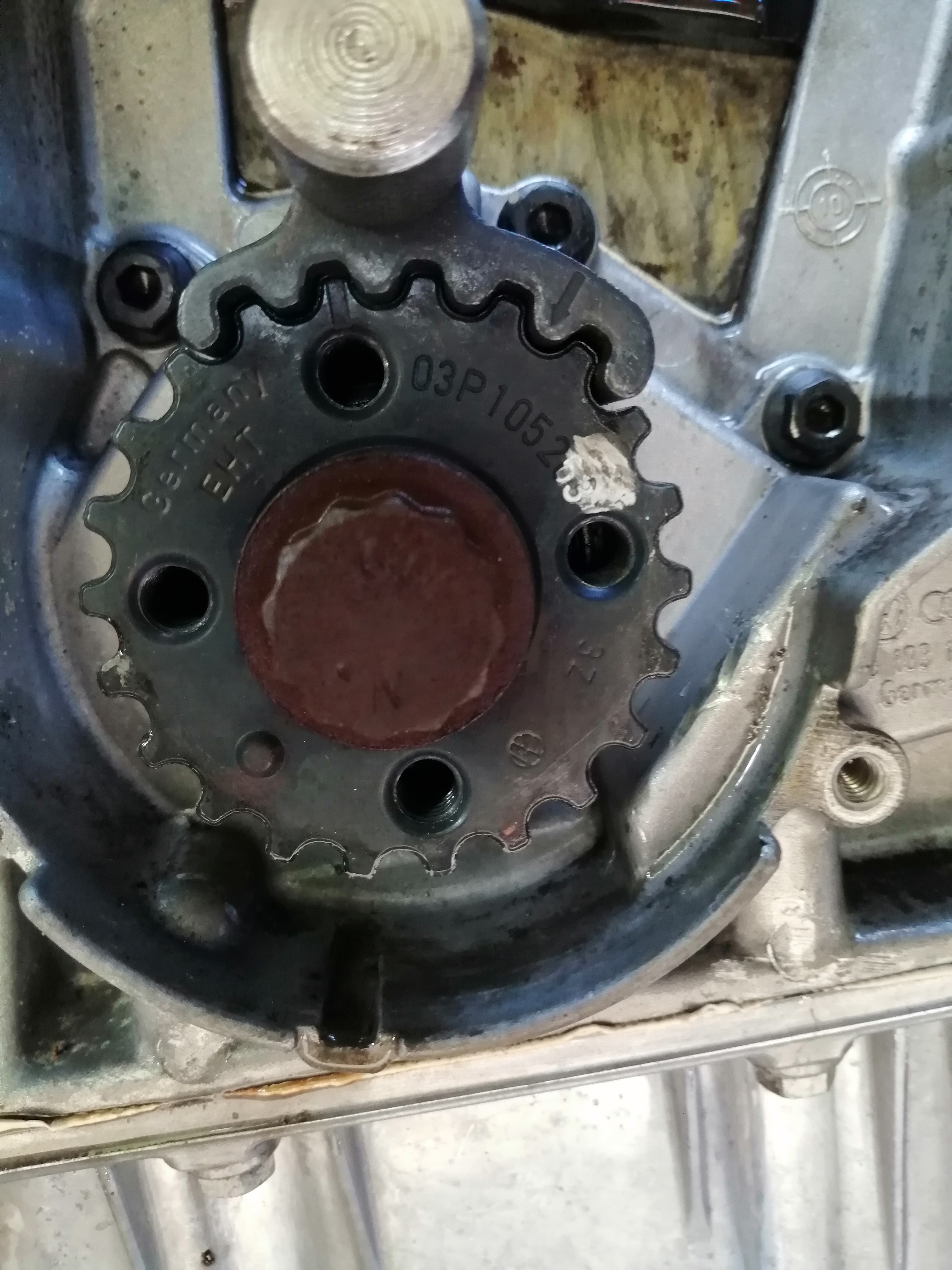

  19. Hi Well spent most of the day stripping it down, It was the water pump it collapsed shredding the belt I got the timing tools does the one on the crank look right?. also I am going to have to change the oil seal on the crank where the pully is what is that like to change?. it is leaking then its put the pump and the belt on see if I can rotate the crank with a spanner without any interference and fingers crossed see if it starts. What is the oil seal like to change on the crank pully?.
