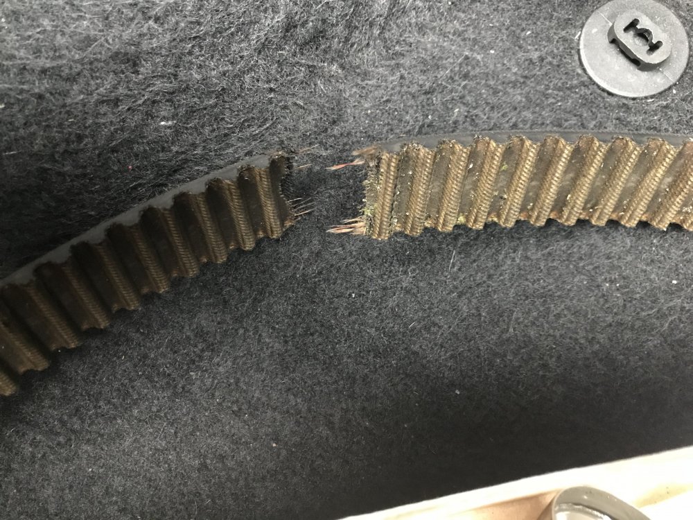

Hi yet another woe timing belt snapped!, had to get the car brought home with Greenflag, sat in the car at traffic lights and just cut out, tried to start but no go. What will need doing to get it fixed and how much does anyone think it will cost?, car only done 57.000 miles and belt and water pump was changed 3 years ago. 2010 1.6 diesel greenline.

I pulled the belt cover to see the belt and I could see it was broken, yes just sat at the lights and it made a funny noise and cut out. The belt was changed by an independent garage it was changed because the water pump was leaking at 9000 miles!.

OK so I have decided to have a go at stripping it tomorrow I've been looking at youtube videos doesn't look too bad a job, I don't have the timing tools but there is plenty of mobile mechanics out there when I strip it I will call one and ask them to fit the belt, I also know a couple of people in the trade that might do it, I was a time served mechanic I worked on Citroens  but that is nearly 50 years ago I have all the tools apart from the timing tools, as you say I might have got away with it, so get a belt kit and pump get it fitted start it up see what happens?.

Hi, I have got the timing tools, the only thing I don't know what to do is time the crank pully?, on youtube videos they show fitting the timing tool on the crank while the belt is still on obviously mine isn't I can't find any instructions is there any timing marks on the pully?, how do I time it. Thank You. Stripping it down today at least the weather is nice.
