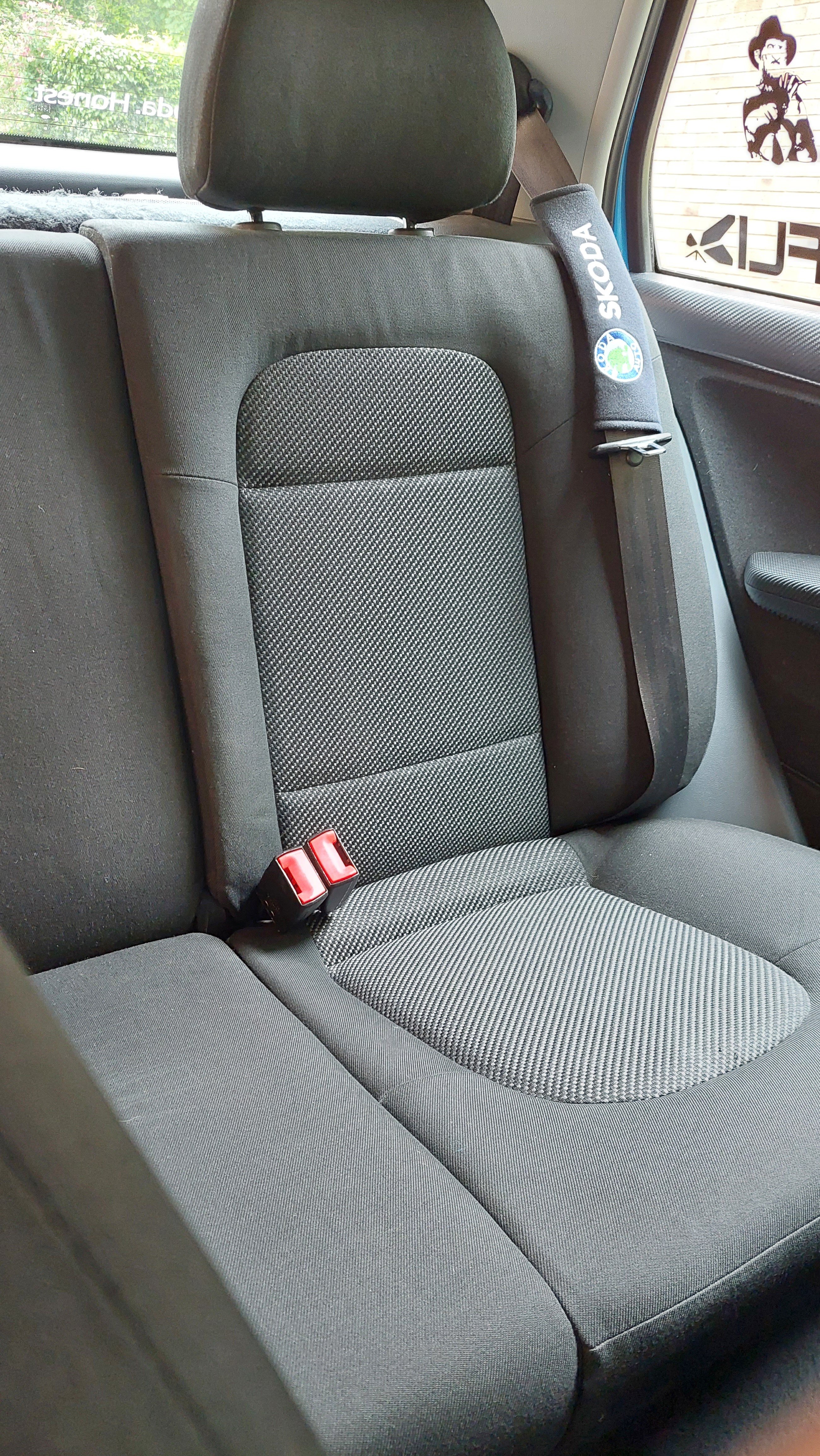

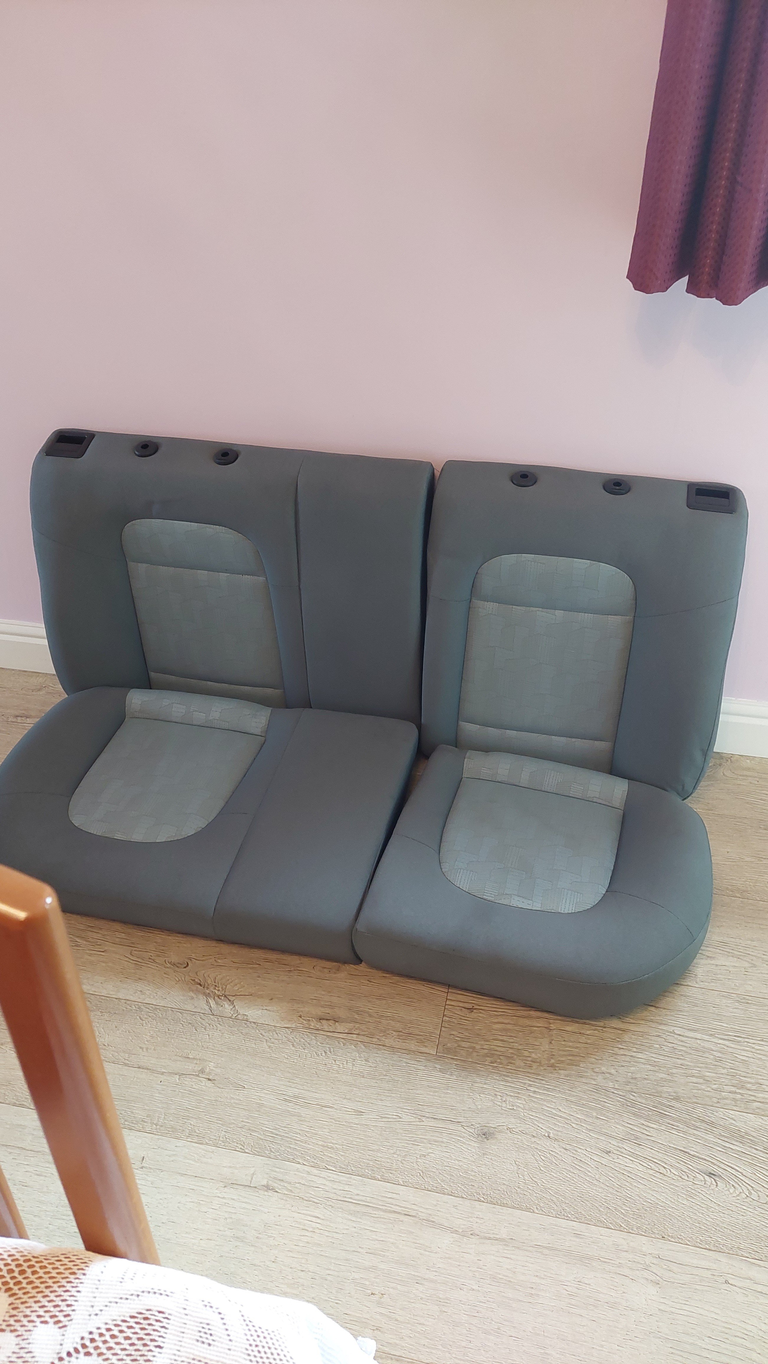

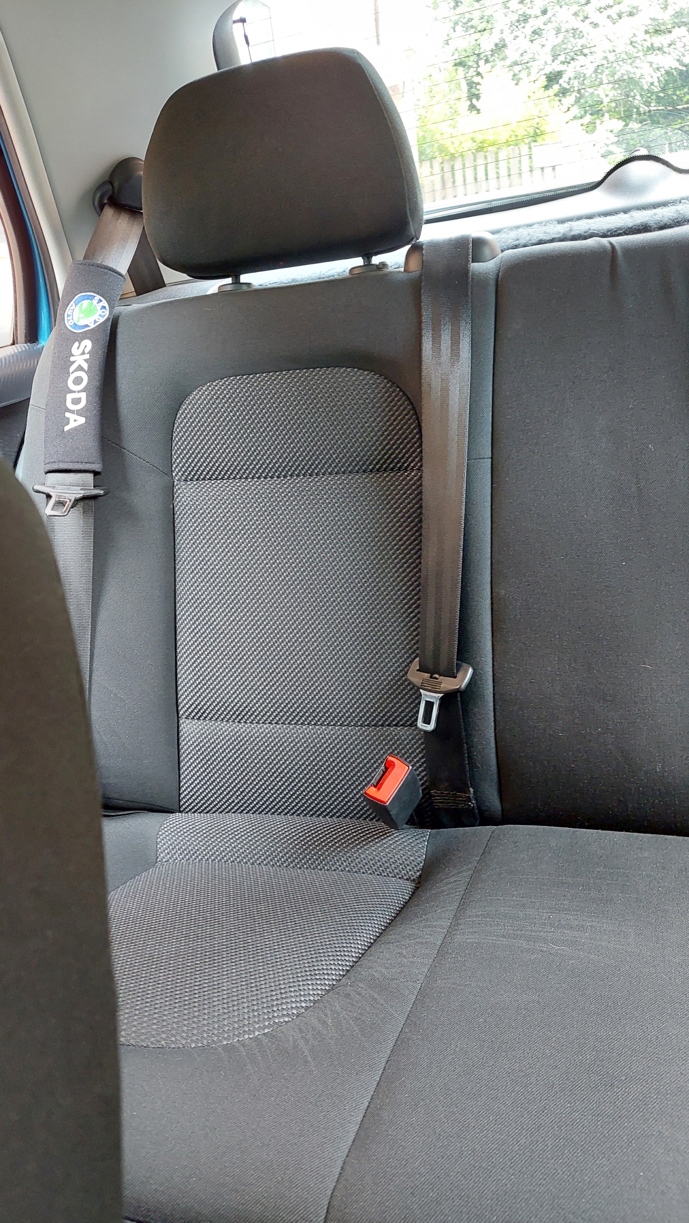

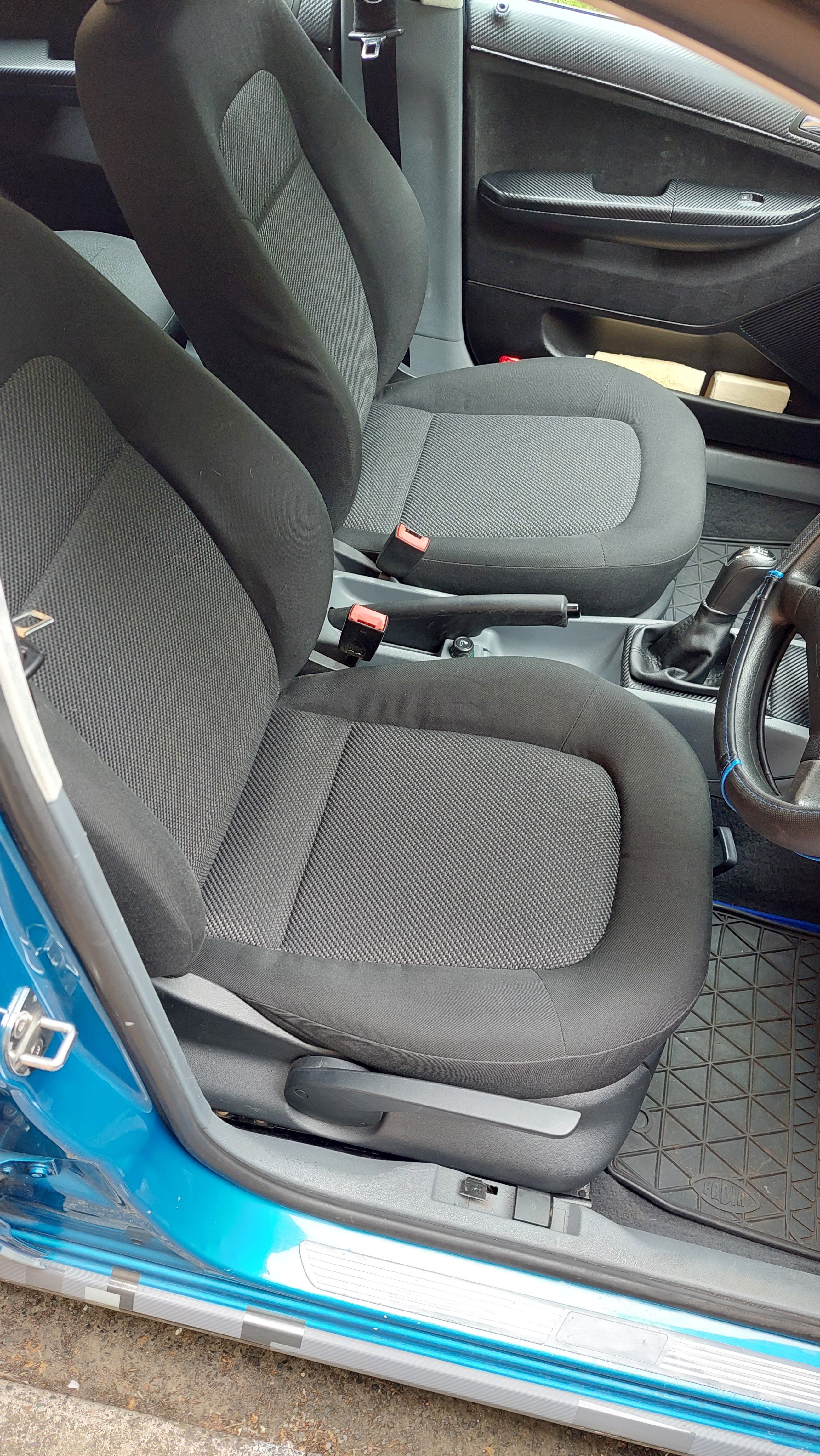

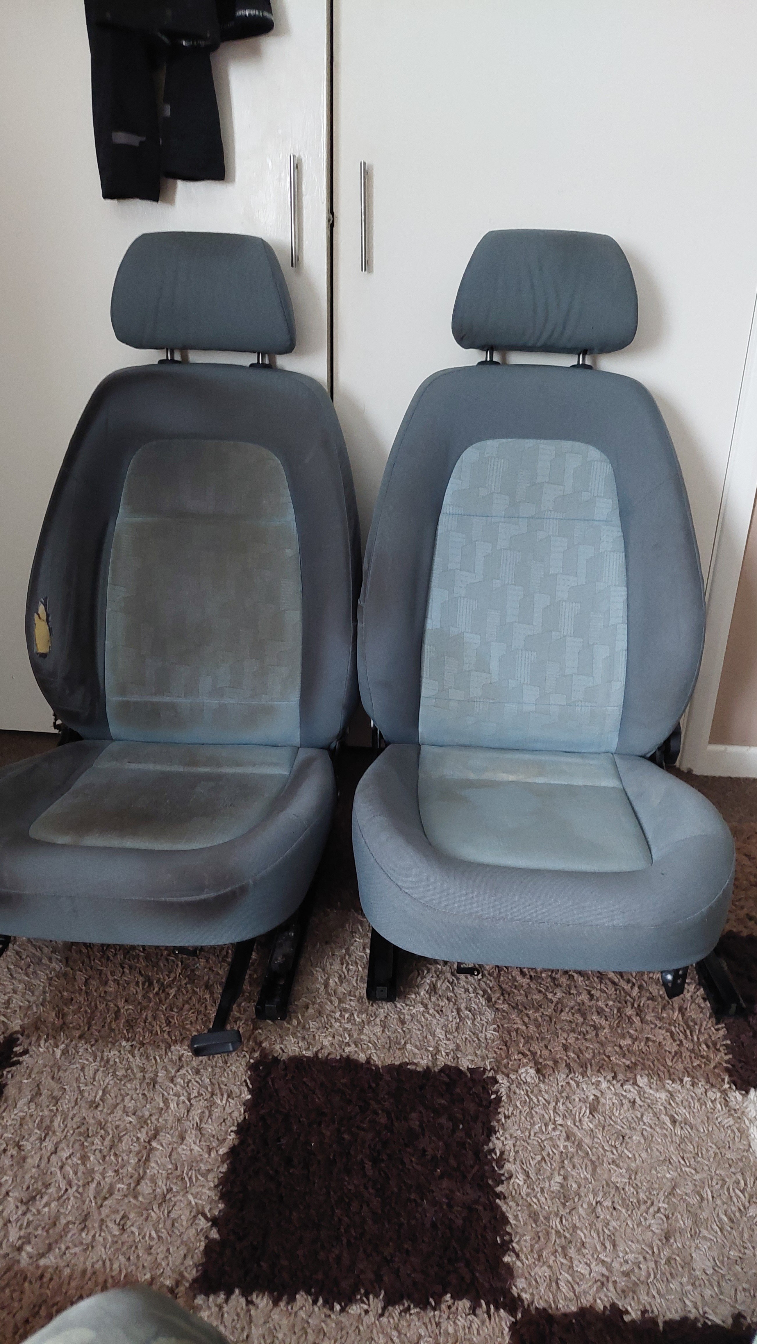

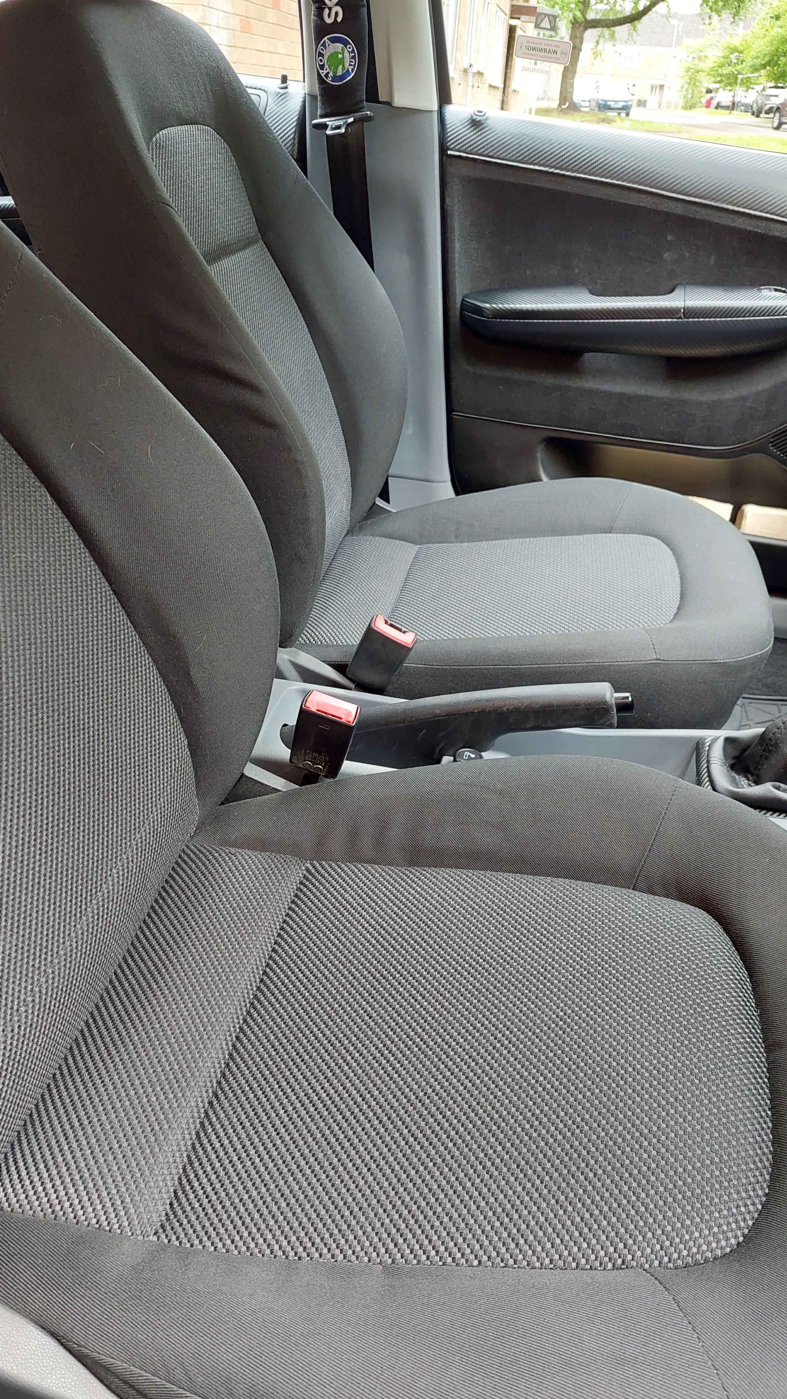

  1. Got you all looking lol misleading title. So took a 250 mile round trip to cardiff on sunday in the furby to buy a full set of seats from a guy. To say it turned out to be the bargain of a lifetime is an understatement, I was a bit worried as seemed to good to be true but as you will see in pics below mine were minging hence why when i brought the car there were seat covers already on. I think the previous owner may have been a swamp donkey or something lol. The new seats I have to say look and feel as though they have only been in a car maybe 12 months.
