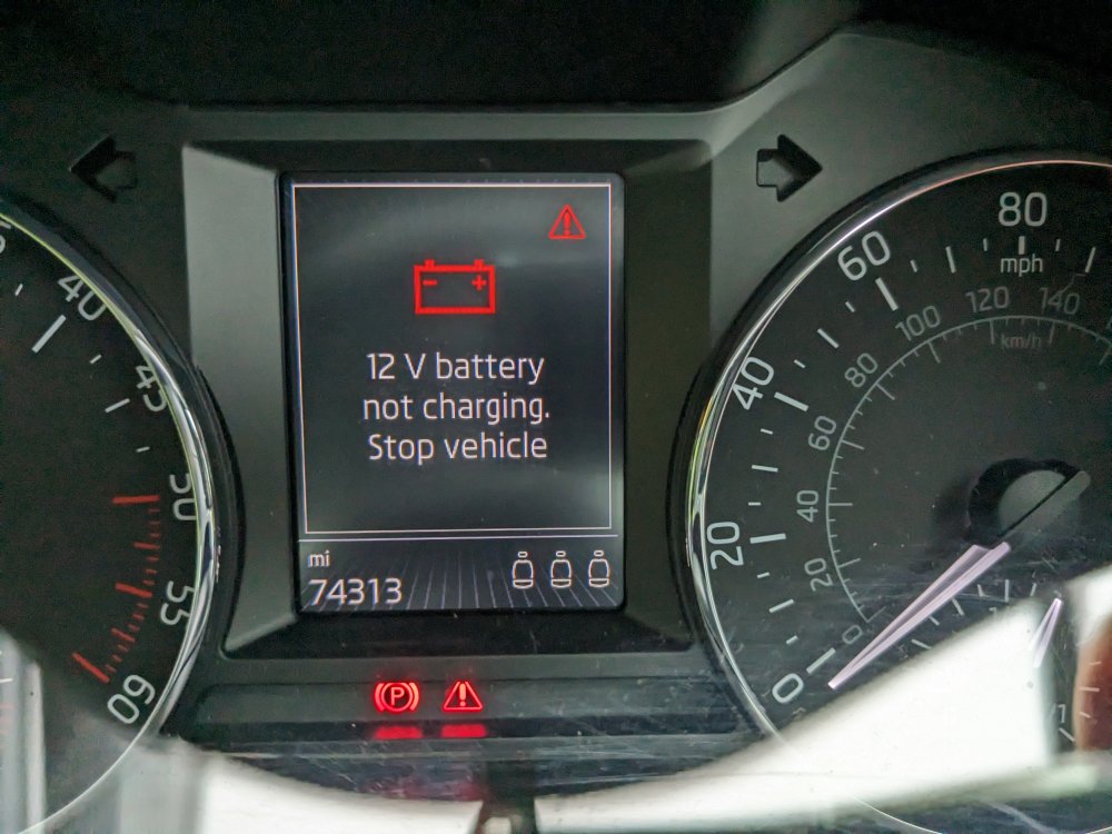

12 Volt System Not Charging. Stop Driving Now.
What a coincidence. I had the same this week. Got a warranty but Skoda weren't interested in even looking at it for 2 weeks as they were so busy. I swapped batteries first (no issue as it was on the original still anyway) and when that didn't fix it, I dropped it off at a local independent who diagnosed a failed alternator and replaced it. Had it back 2 days and so far so good. But thanks for the tip about the fuses and cables under the bonnet if it does come back.
