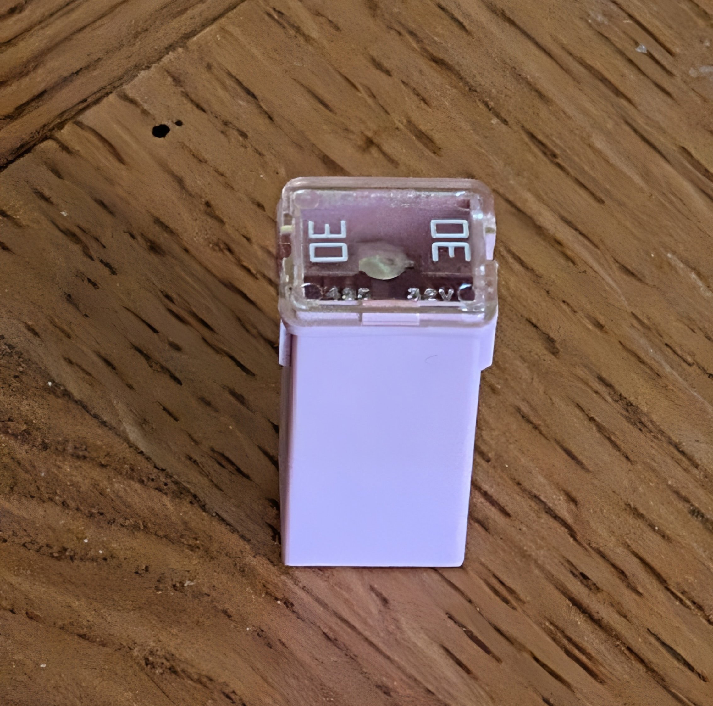

  18. I checked the unusual fuse and it was fine. (The hard part was putting the glove box back.) I plugged in my OBDEleven and apart from some minor errors there was no reference to interior lighting. I did find this thread on the site which suggested the switch in the assembly above the mirror maybe faulty. I don't think it's a microswitch in the driver's door as no door activates the courtesy lamp. I suspect the inspection/repair of the light switch assembly is above my pay grade. šŸ˜•
