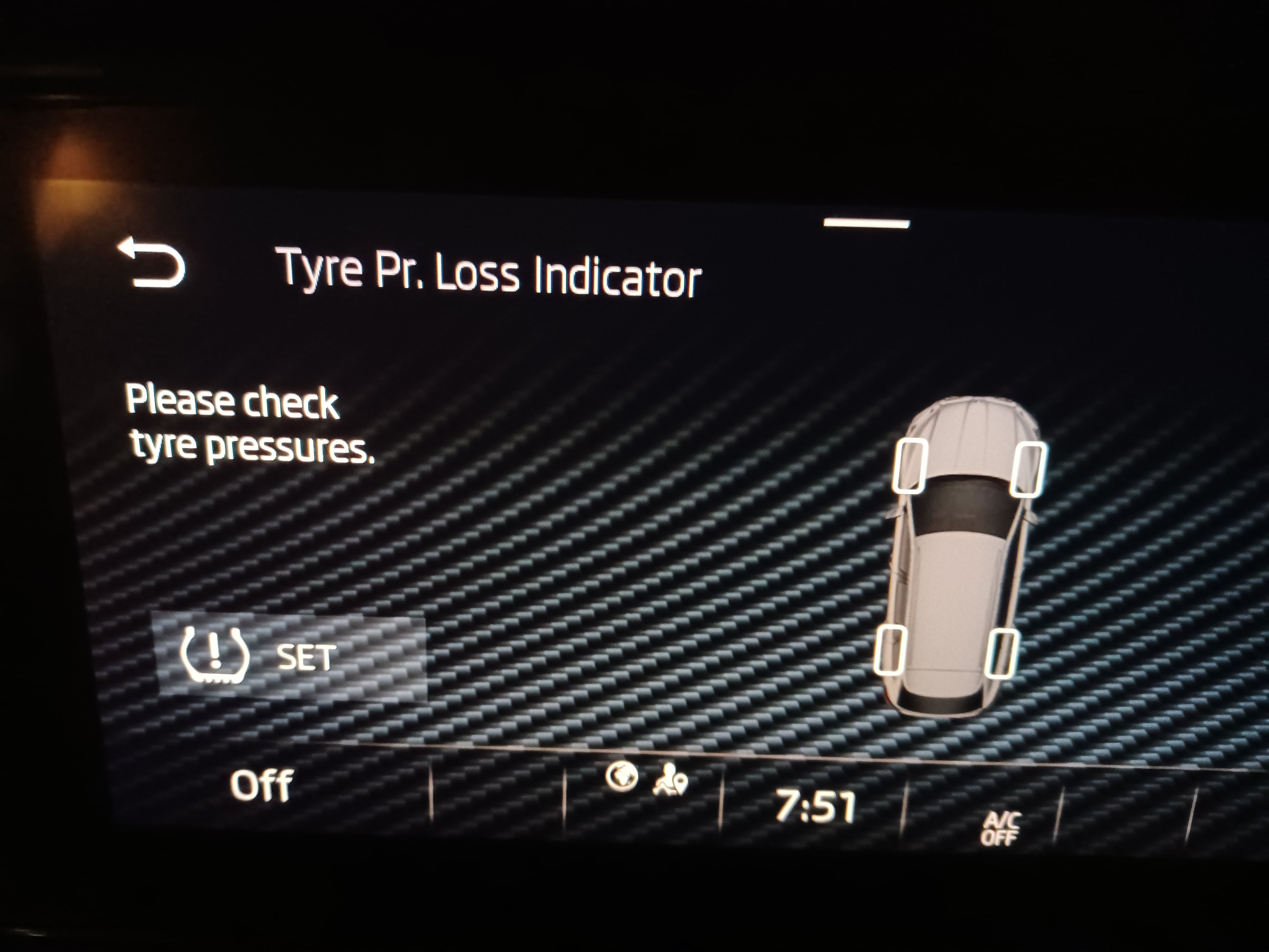

  22. Thanks for your comments guys, interesting! No wheel or tyre damage from what I can see. Also when the warning comes up there is no indication of a fault from any tyre. Tyres or brakes are not warm or hot, not normally been driving for long when the warning appears. My note about the fault codes came from comments from the technician last year when it was in for the Auto Hold and Electronic Handbrake release issue. Let's hope the dealership are more proactive when it's in for service in April. I have a few issues for them to look at.

  24. Hi everyone, Anyone had TPMS issues with their Octavia Mk 4s. There are many posts on the forum and the Internet regarding TPMS issues but nothing related to the Octavia Mk 4 in particular. Quite a few posts for VAG group as a whole, but no fixes published. Seeing as many of us are suffering Software issues with the Mk4, I thought I would add this post. I’ve been getting an INDIRECT TPMS warning quite regularly for the last couple of months, more or less every other day. Driving along I’m getting a warning about a TPMS error and a flashing warning light which stays on constantly after a minute or so. When the engine / Ignition are turned off and then back on the warning light disappears (as noted in the handbook), so I assume this is a spurious warning and not logged as a fault on the ECU? The central screen tells me to check pressures and the car picture / symbol shows amber illuminated tyres. If I go onto the next Tyre menu (the one with the small plan view of the car) none of the tyres are illuminated amber (seen a number of posts on the Internet where this shows the faulty tyre illuminated in Amber). To try and solve this I’ve done the following: · Checked all tyre pressures to the figures shown on the filler door label, 2.6 Bar Front & 2.7 Bar Rear (Normal driving). · Monitored tyre pressures daily – NO loss of pressure noted at any time, confirmed with two different tyre pressure gauges (I was off work with COVID last month, the car didn’t more for ten days, no loss in tyre pressure when rechecked)! · Checked the security of the valve cores (Simple tool for this as I had this issue on another car). · Monitored the outside air temperature to see what impact this has, basically none! (air temp during the period has been between -2⁰ and +12⁰ C.) · Obviously, checked the tyres for damage. · Reset the TPMS on the screen (advised to press the caption several times to ensure the new readings have been registered by the system). Doesn’t seem to give an audible warning to say it’s accepted the readings on mine. Car is due for it’s 1st service in April so I'll ask the dealer to look at it, but as I found last year with my sticking AUTO HOLD and the Parking Brake which were intermittent (previous post of mine), unless there is a Fault Code the dealer won’t do anything (I’m told Skoda will not authorise repairs without a Fault Code). I really want to like this car. Relatively affordable to buy and run, drives well, pulls the caravan OK, looks good, but I’m tired of the number of faults I’m getting on a new car. I’m still waiting to see if Skoda is going to repair the ‘iffy’ paint on the roof, reported to the dealer last September and again in October. Admit the issues don’t stop me using the car but it’s annoying and doesn’t inspire confidence in the product. Any TPMS comments folks would be greatly appreciated. All the best, Chris
