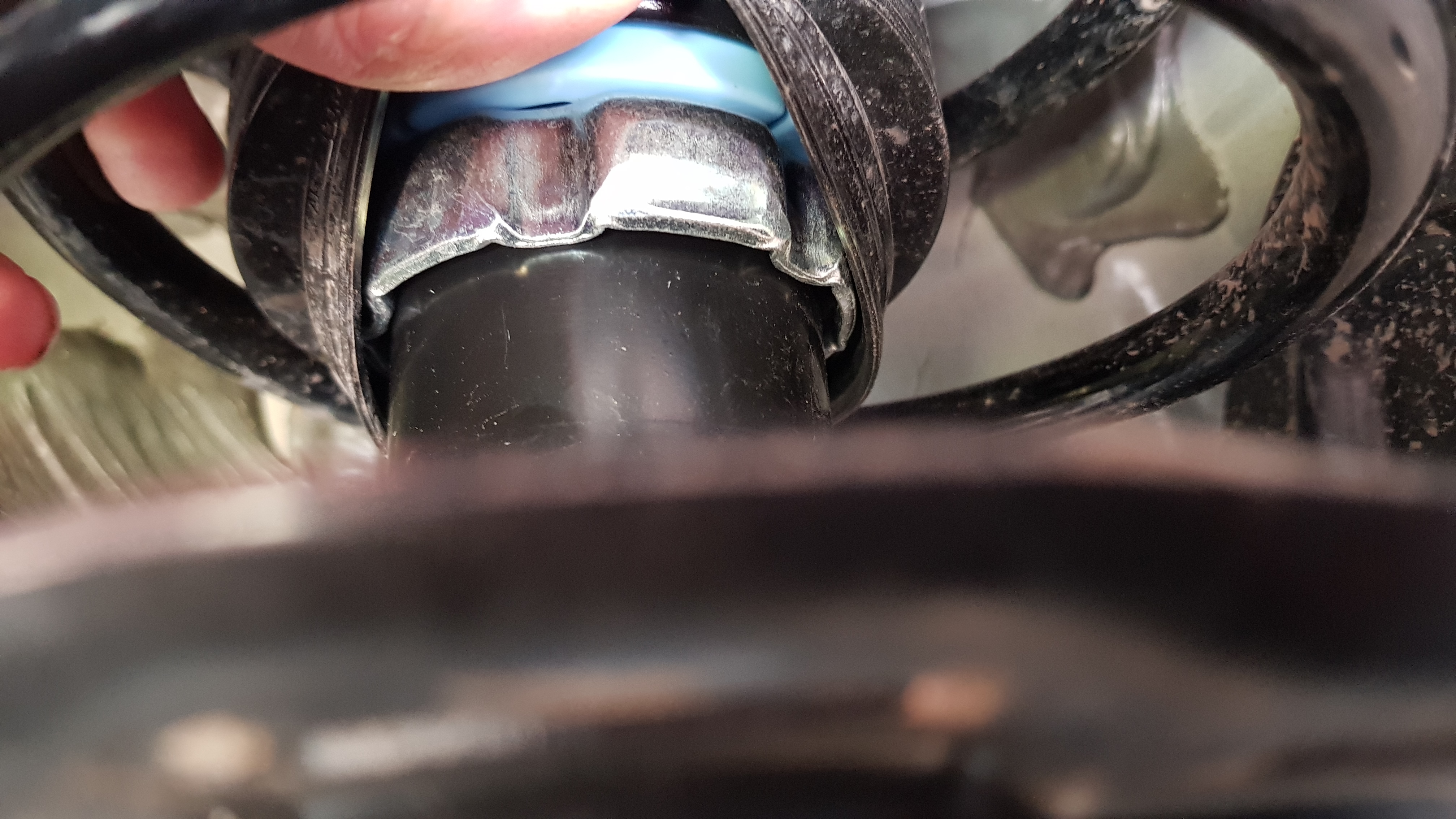

I don't have a jack available where I am at the moment but was able to check the front without jacking the car and sure enough you are right, it still has the transport blocks fitted on the front. Are these only fitted to the front suspension or do they have something similar on the rear?

Yep, sure enough the transport blocks are still fitted. Make me wonder what else has or hasn't been done such as checking wheel nut torque. I wonder if the anyone from Skoda would be happy to get on an aeroplane that has had the same level of service applied to the pre-flight inspection?

As per the title. I had a lease MkIV delivered yesterday and although I've only driven it a few miles it's as though it has four flat tyres on bumps and speed humps. By comparison, the MkIII which has just gone back floated over the same roads. It this what everyone else has experienced or should I take it to a dealers ASAP? The MkIV is a SE First Edition and it replaces a MkIII SE Technology, both on 16" wheels and I doubt the SE Tech had an upgraded suspension setup.
