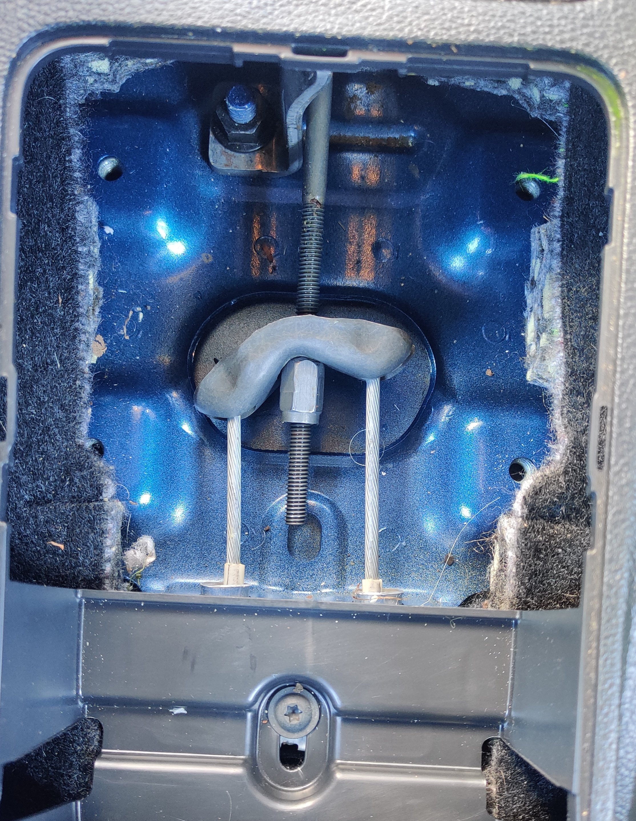

  2. Just back from hols. You were right about T bar being squint. I'll go back and get it sorted.

  4. I recently had the rear brakes (drums) cleaned and replaced. Ditto cylinders and spring kit. Ensured free play in self adjusters. Mechanic properly bled them and checked grip. The brake lever was very high but holds. However he said that the self-adjusters would bed in after a week and lever would lower. That's not happened yet. Before I try adjusting the cable via the hatch under the tray between front seats. I wanted to confirm that what I was told was correct.
