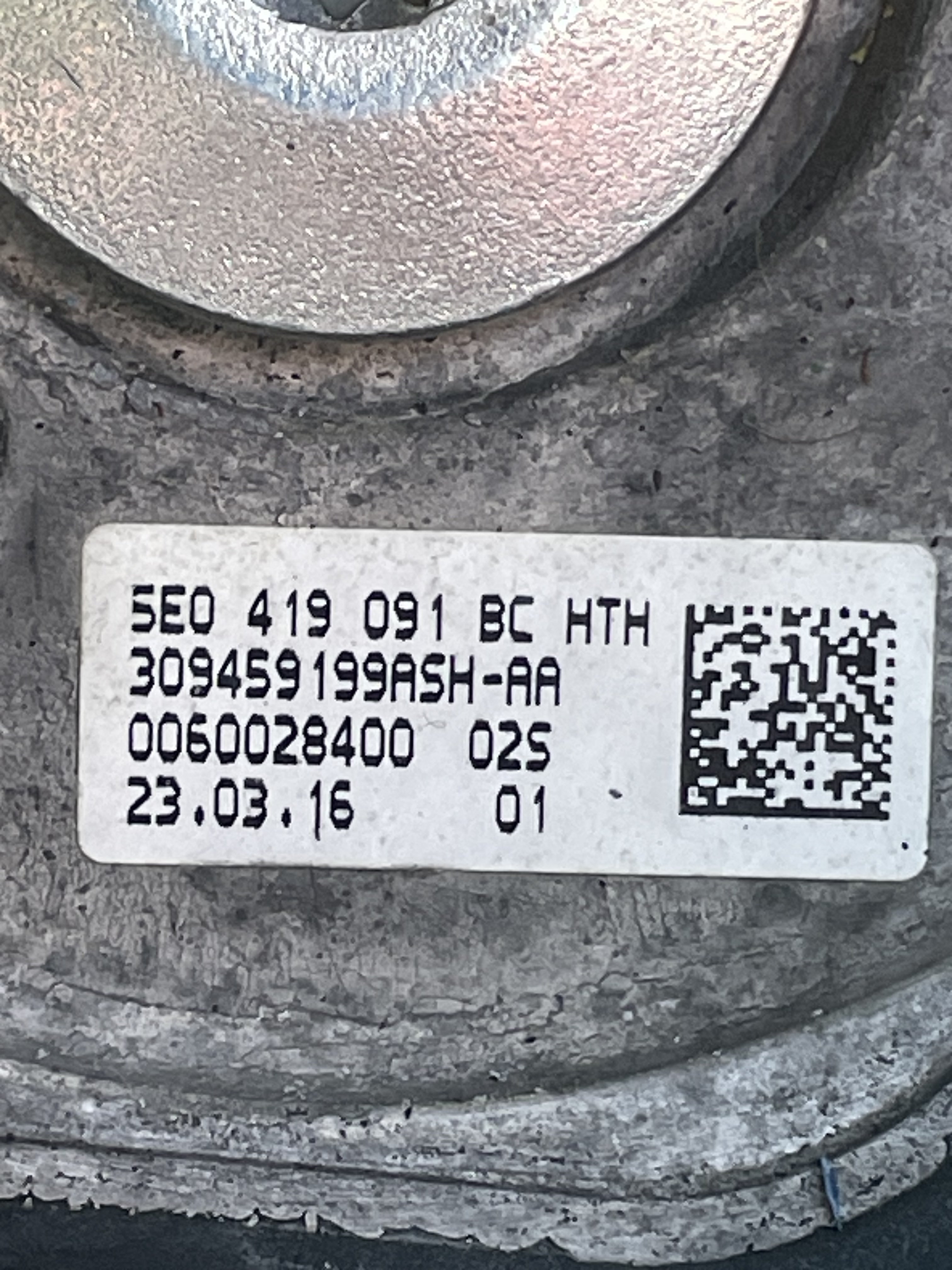

  2. Well I have just had to replace my 2018 Octavia hatch with a 2019 Combi, same engine and gearbox etc and went to put the flappy paddle steering wheel from my old car to my new. The wheel is a VRS wheel made in 2016, the change was easy but the air bag in my 2019 is a different size and shape to my old one. Does anybody know the part number for the air bag for the VRSwheel so I can buy the right one? I attached a photo of the steering wheel label if this of help. Cheers

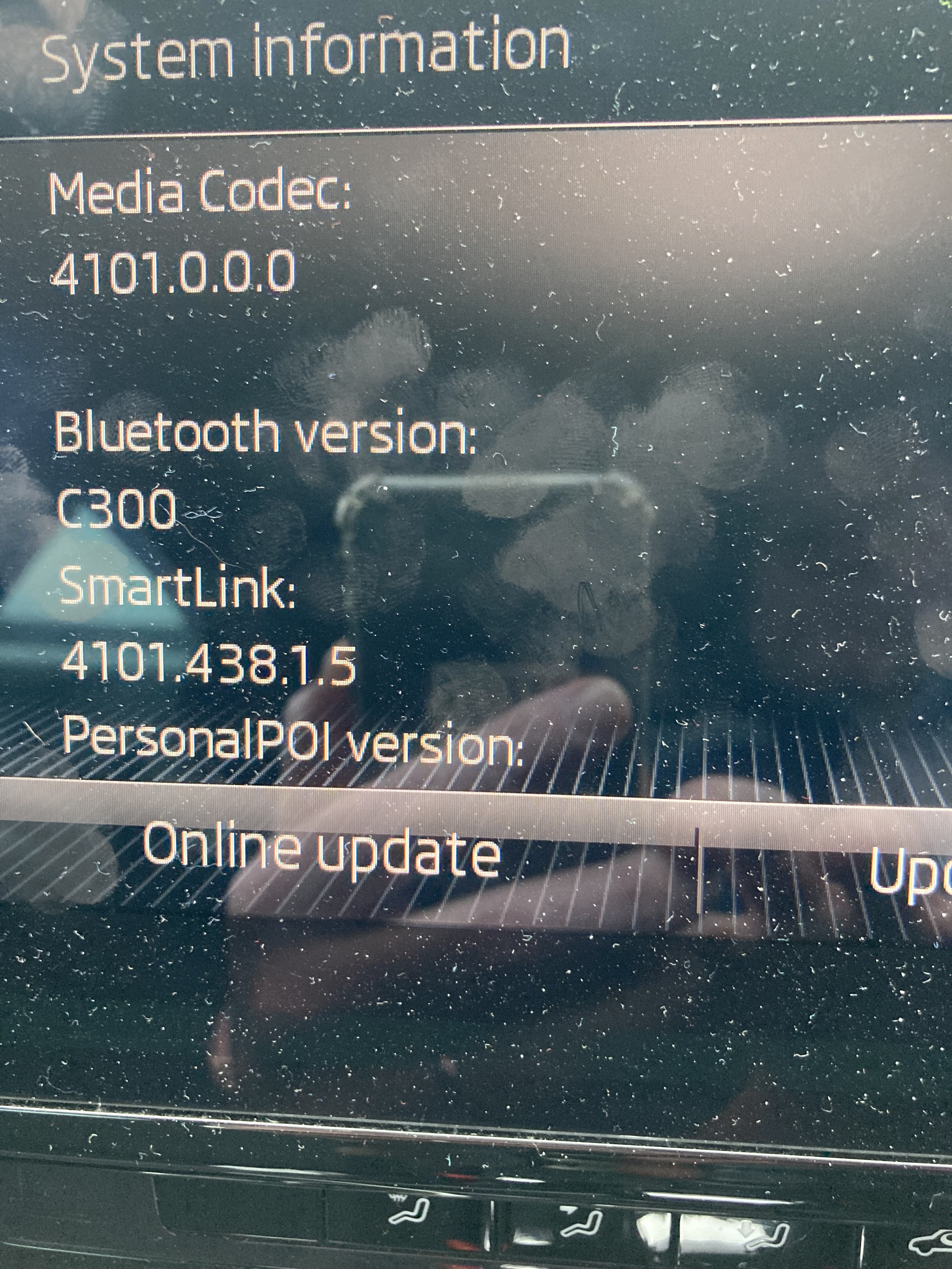

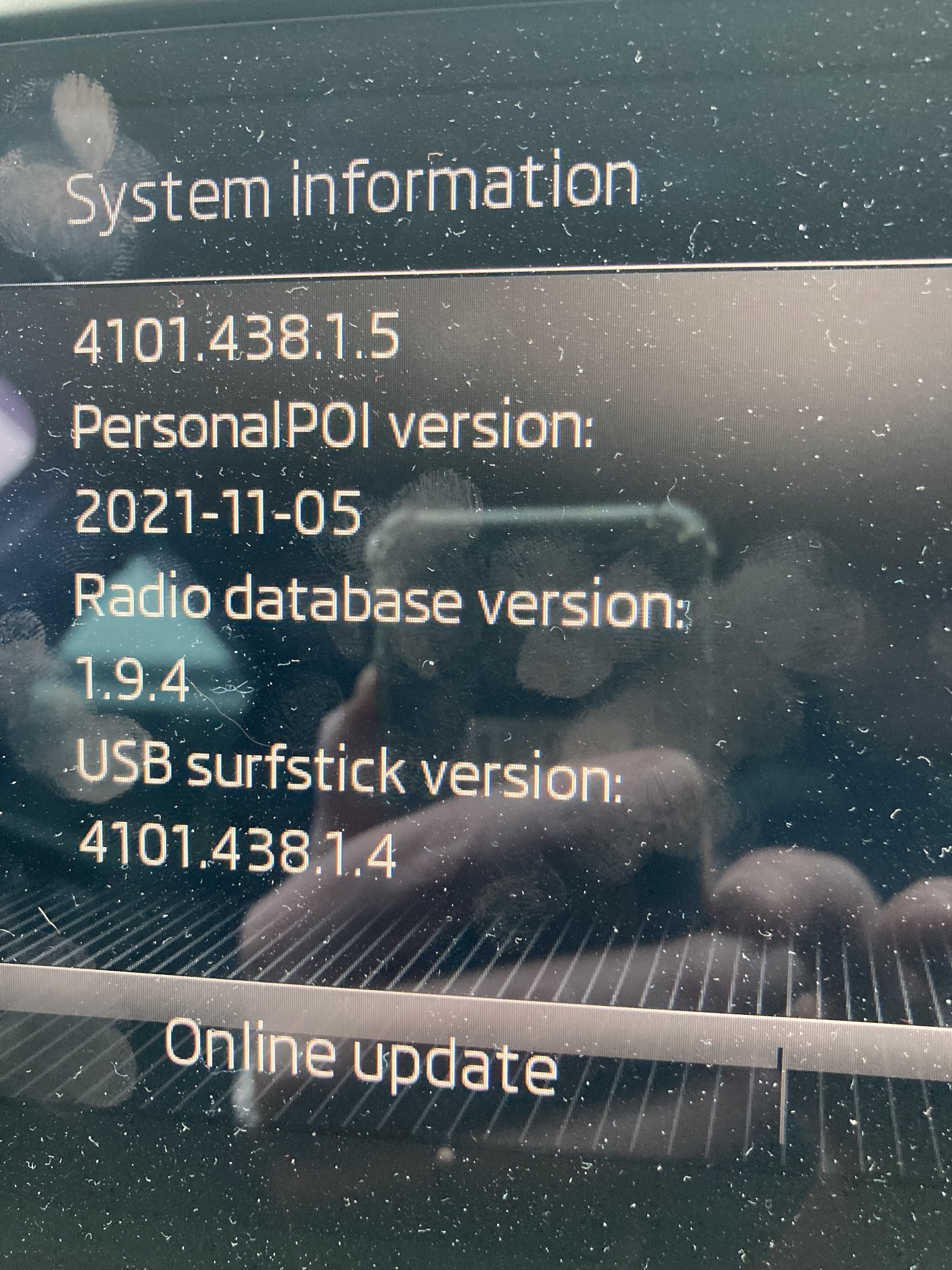

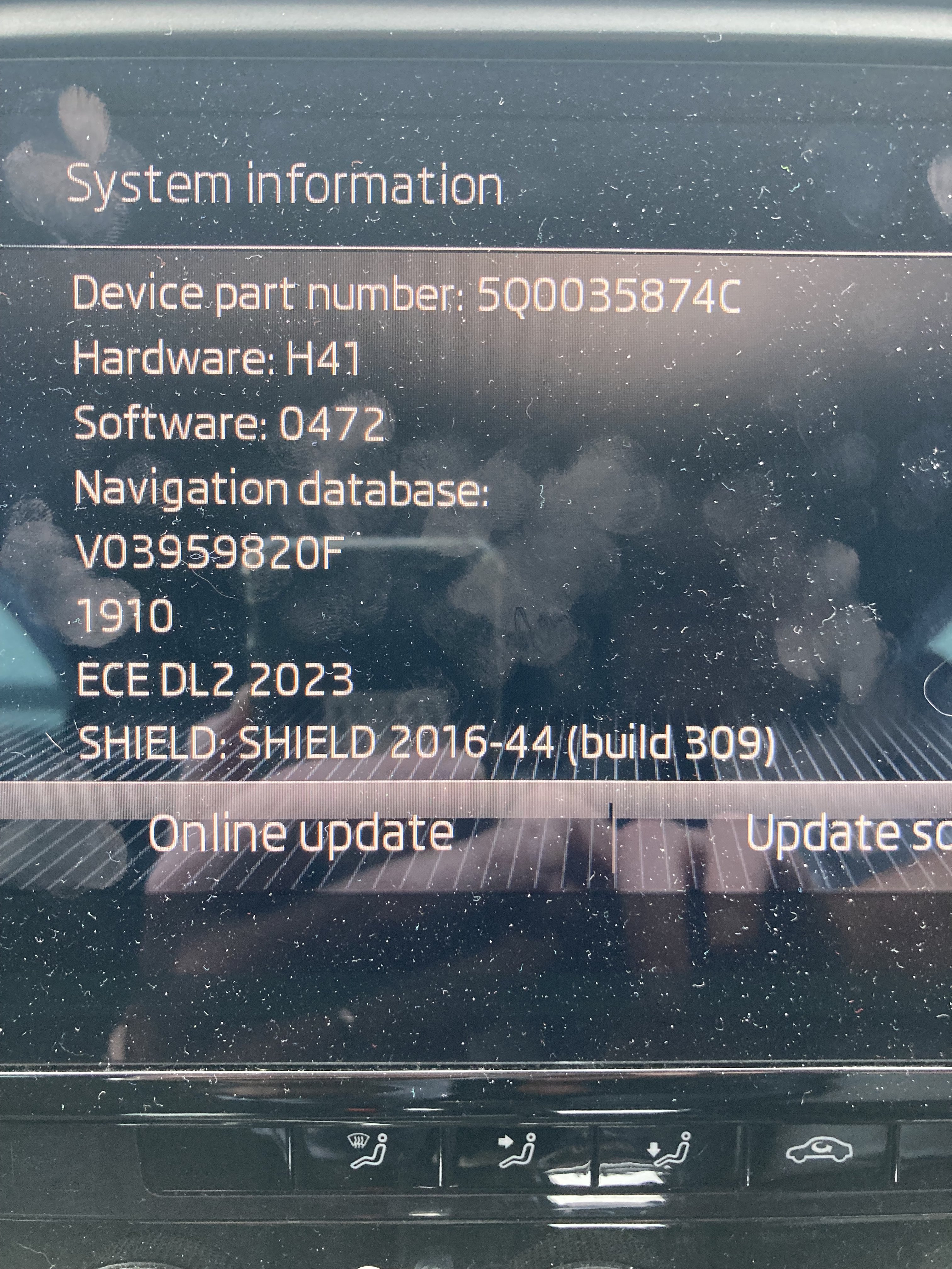

  4. Well that got complicated fast. So I ordered and received a genuine Skoda card, plugged it in and the system said no map data. I checked the card and it had full map data on it. I spoke with card supplier who told me to check various things and do a reset, no joy. In the end I sent photos of my system screen and memory card. My memory card was actually a VW card and the Skoda card was not compatible with my Skoda head unit! They sent me a VW card which works perfectly. I can only assume that the head unit has been changed at a VW dealers at some stage.
