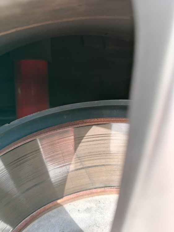

Hello again.
When I checked the rear discs and pads (which still have the ATE ceramic pads), I noticed they were cracked, with perpendicular cracks. I also noticed that the vibration when braking comes from the pedal and the floor, so I think the rear pads have also eaten away the original discs.
I've already ordered replacements with ATE discs and TRW pads. I don't know why I still trust ATE after such a mess.
