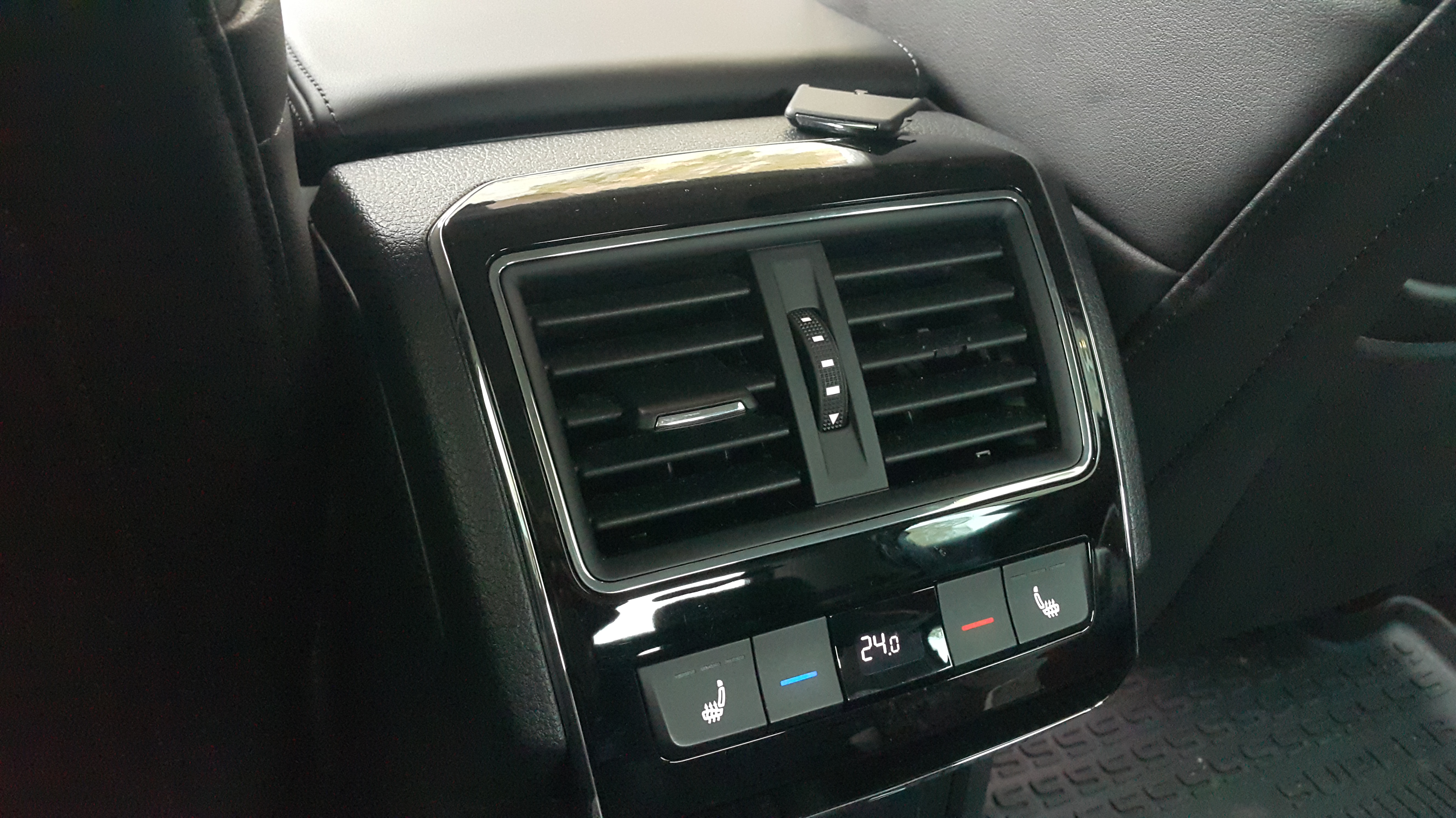

Colleagues, three exhuberant post football lads in the back had resulted in a broken rear passenger air vent (air outlet between the front seats, above the temp control and cigarette lighter). It pulls out, that's one piece of good ness and the light wire is simple to unclip. Also none of the broken bits fell inside. Does anyone know the part number please...or where I can find it? Any recommendations for a good source?

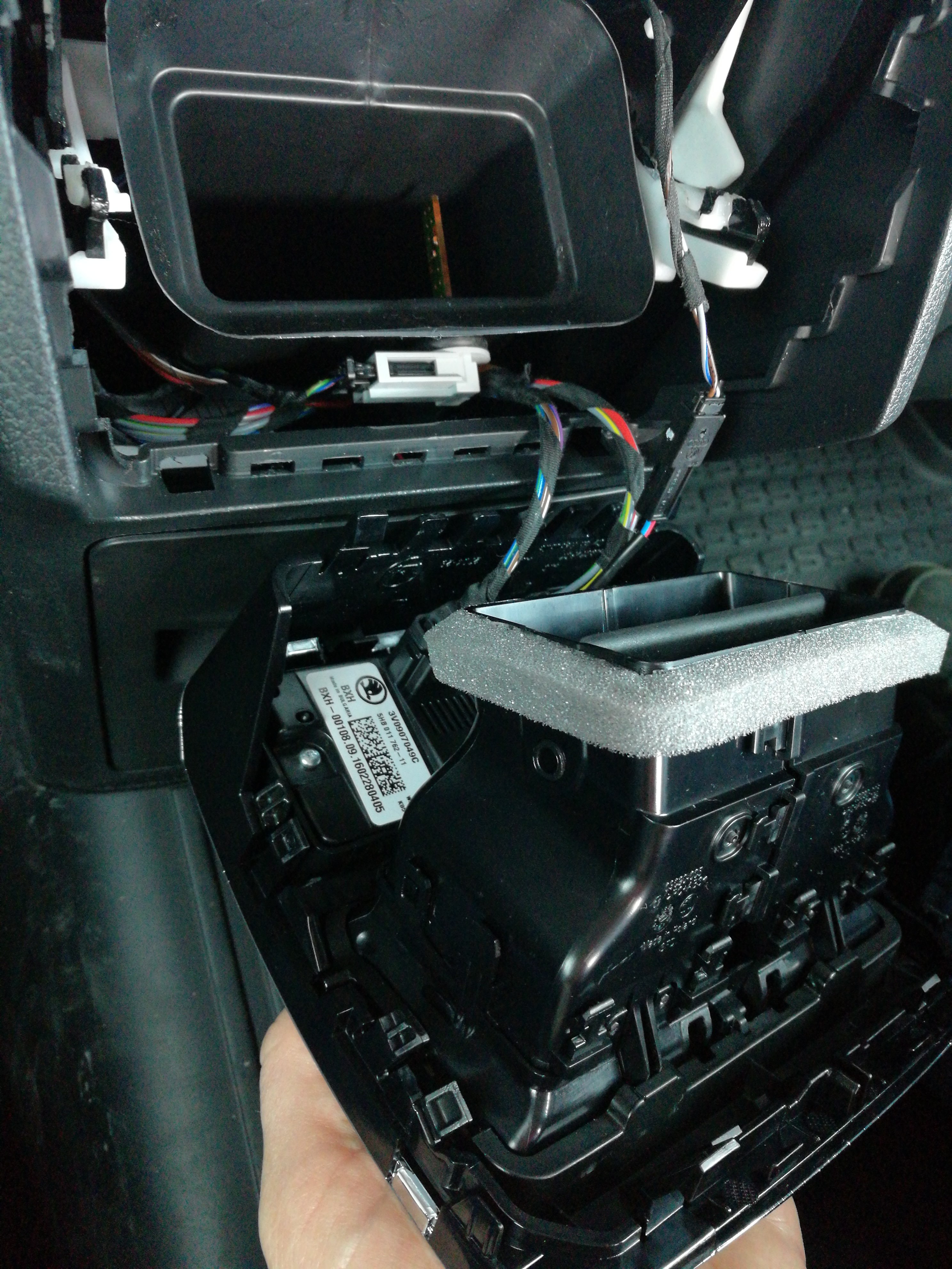

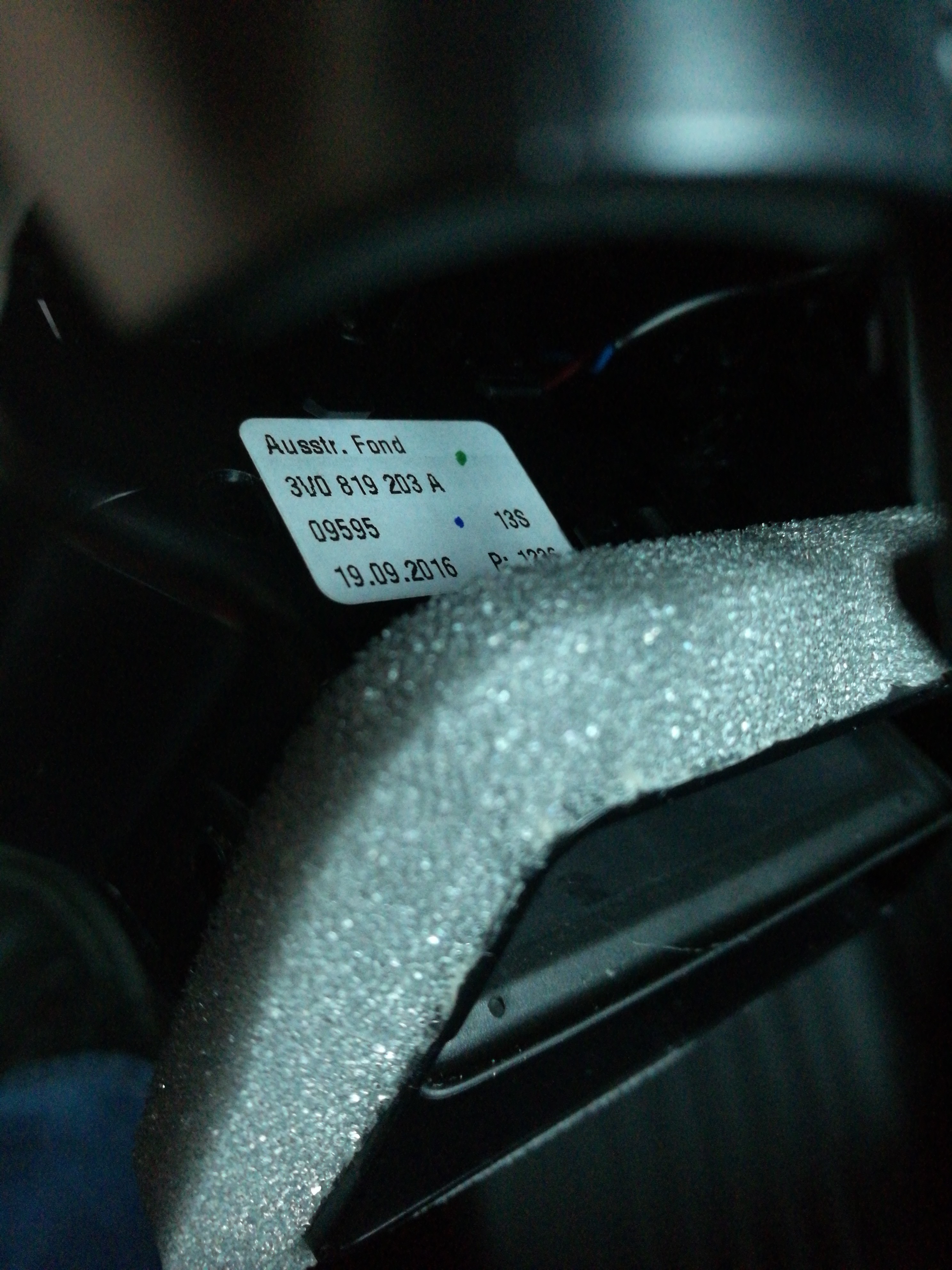

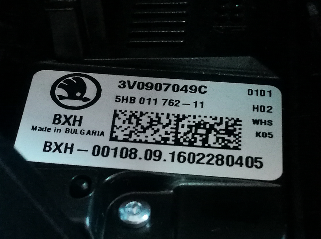

I had to remove the whole unit to fix it so I'll do that again when I get to the car and get the number for you. There were were different parts numbers though, one was the whole unit and another one was the actual air vent casing which slips out of the main unit
This is the part number I think of the main unit
Edited by BennyS3
And I think this is the internal part number of the actual air vent casing
Many thanks...feel silly now I know where to find it! Much appreciated...it's just the top I'll order.

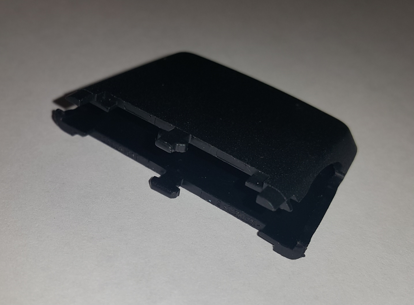

Just broke the slider 'thing' on the rear right hand side air vent and was hoping for a cheap fix or something.

Can someone be kind enough to share how this pops out?  My little ones have also knocked both sliders off the air vents and some pieces have fallen inside the unit... would like to try and fix this myself if possible.

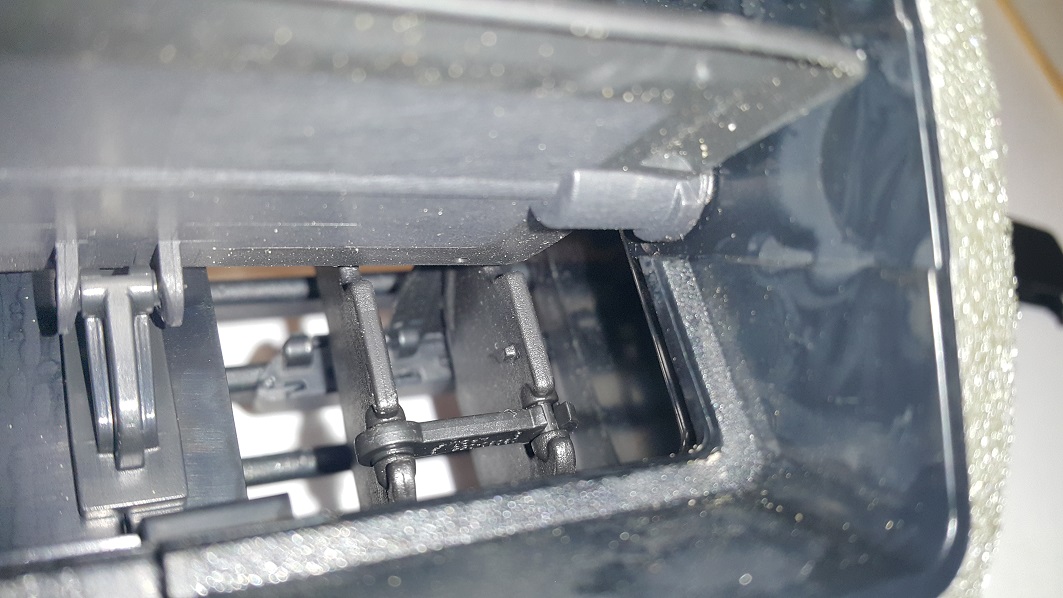

the bit you have there has little forks on it you need to start at the top there's two I think and more around the other ends it comes to bit quite easy really once you get the vents out you will need to retrieve the backs to the sliders from the heater pipe turn the temp sensor anti clockwise to release it
sharp tug on pipe to loosen and slowly remove so as not to loose backs of sliders
put it all back together take your time as the backs of the sliders are a pig to seat correctly patience is the key all told took  about 30 mins to complete

I've just got to try and recover the 2nd 'slider back' from the heater pipe and I'll be good to go!   Fingers crossed.

Ok well I had to remove the ashtray housing, undo 4 screws and then pull off the trim for the air pipe to come out horizontally.  Low & behold the back of the slider was waiting for me at the bottom of the pipe.  Which means I have now recovered all bits in order to fix the air vents.

6 year old boy pulled it out just by his fingers,
warranty repair were refused, dealer offered to order all the unit for €170 :(

Looks like you're missing a few small parts.  These have almost certainly dropped inside the unit if they are not on the floor of the car.   Unfortunately, you cannot order the smaller parts of the unit which is  why your dealer is suggesting a new unit.   Been there and tried rather frustratingly!  If you have the time & patience I would suggest you try and fix this yourself using the info posted by others in this very thread.
i have ordered €16 WiFi 3m Endoscope form Ali,
will try find missing part and solve by self

Just doing a bit of tidying up and noticed one of the sliders was hanging off the left rear vent. I’ve got the slider itself and a 10mm metal clip that was hanging off it. Am I missing anything else to attempt reassembly?

I've unlatched the ashtray front , disconnected the 12v socket and then I am left staring at this
https://photos.app.goo.gl/kkewSVgJFULtaNZ8A
I assume this comes out to get to the screws that @Shabbs mentiond further up
How do I get this out with damaging anything ???
