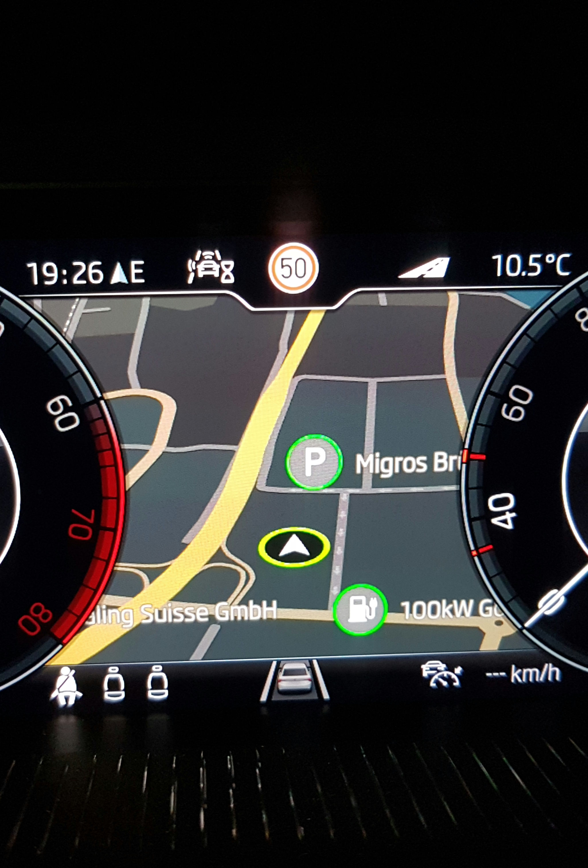

The update was done tonight and it works ! Yeah. I will take some picture of my Amundsen Software versions tomorrow. I can provide you with the garage details in a private message (they speak french and german) Best regards, Christophe
Kamiq Ambition + Admunsen Road Sign Recognition ?
Hi guys, I have received a call from my garage today and he said they have fixed the issue and an update will be installed on my vehicle when I get my winter wheels installed on the 19th of November. He said that it's my report that triggered them to investigate and that I will be the first one in Switzerland and probably in the EU to have this problem fixed So I'm impressed with the customer support so far also it shouldn't have happened in the first place I was told the update will take about an hour !
Ciao Pietro, I always had the sign on the setup screen of the "driving assistance" and I can configure the speed limit and the type of "alarm" I'm supposed to have (Visual or Sound or Both (with the exception of the exclamation mark I don't get an alarm). But still no way to have the traffic signs / alert show-up on the Virtual Cockpit (irrespective of the view I'm in). I've asked the "brand specialist" at my Amag garage for an update and he just told me that Skoda factory said they are investigating and will update us in 3 (!) weeks I'm keeping my expectations low.
