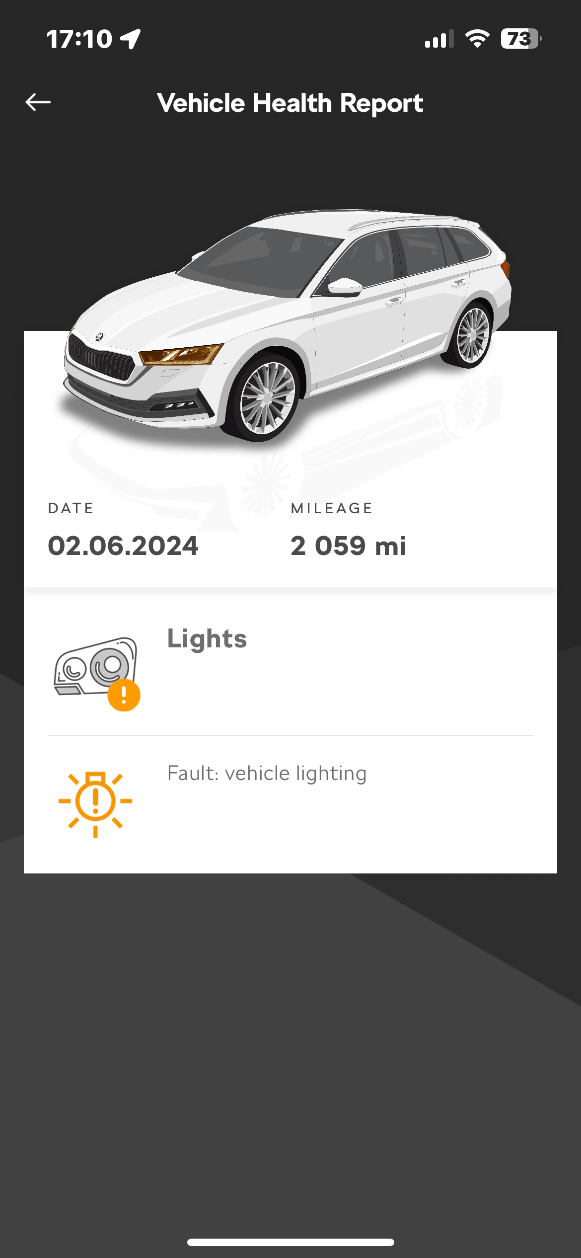

Headlight warning
We’re on software 1940 when this happened. Car is currently in at a dealer for an AC issue. I mentioned the fault and they said although 1941 doesn’t apply to our model technical have advised to update to it (which is interesting as others on here are applying 1969 themselves)

Headlight warning
Also had this fault, noticed at the same time the light switch ‘auto’ was no longer lit up and we had an error on the app. Dipped beam and sidelights were just stuck ‘on’ cleared after an hour or so switched off.

2024 SEL ‘exterior lighting error’ & ‘interior fan error’
Ours is a 1.5 e-tec so 12v battery is in the engine bay
Sadly had our first gremlin in our 2024 SEL estate at weekend. popped up on dash & in app ‘error exterior lighting fault!’ Lights were all stuck on with no means to operate the switches and then at same time the AC was on and fans blowing full chat on ‘lo’ setting on sync but no air coming out the vents. Left the car approx half hour, turned it back on, no difference all still faulty. Decided to go old school and disconnected battery for 15 mins. Went back to it all faults cleared all operating normally. Its running software 1940 any one heard of these issues? Hoping just a software update will resolve and not the start of a bigger issue??
