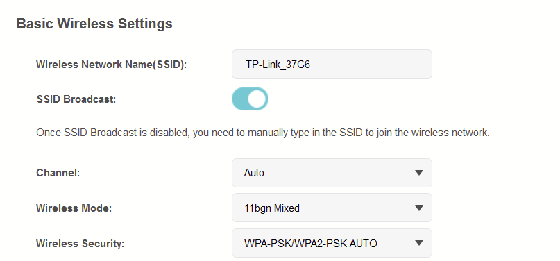

  1. It has only 3 options...the one on the picture + the same but with AES at the end + unsecured...tried all 3 and still nothing :-( might be the problem that it can't be set to WPA2 only? If so, I am going to return it Yep, it is
  2. unfortunatelly still no luck :-( here are my settings...prety basic but still Skoda cannot connect to it saying it`s not supported
  3. I will definitely try this one out, thank you
  4. Yes 😔 removed all dots, underscore etc. and it has like 8 digits...still no luck
  5. Thank you John, I tried that already but no luck...WPA2, WPA, no security at all...but unfortunately all the time my Superb showing its not supported connection 😔
  6. No probs....yes it connects my phones hotspot + also I can connect to the router via the phone as well. It's just the car does not want to connect
  7. Yes Phil, the router is set to WPA2...I turn it on, the car can see it but still crossed out as nit usable. I am lost wbat should I do....if I do hotspot from my phone, it connects fine
  8. Yeah that is what I thought, and it did not work :-( WPA, WPS, none works :-(
  9. Unfortunately not in the MIB3 anymore
  10. Hi team, hope you can help me out. I bought a TP-Link M7200 4G pocket wifi router with an O2 data sim card inserted to use it as a hotspot in my Superb iV. I could connect to it with my phone, it is working fine, but simply I cannot connect to it with my Superb IV. It recognizes the WiFi, I can see it in the list bit the Wifi icon is crossed with a red line and if I want to connect to it, it is showing me an error "this type of connection is not supported" Any idea what can be wrong? I tried with password required, free login, pin enabled/disabled but no luck. Thank you so much for your feedback
