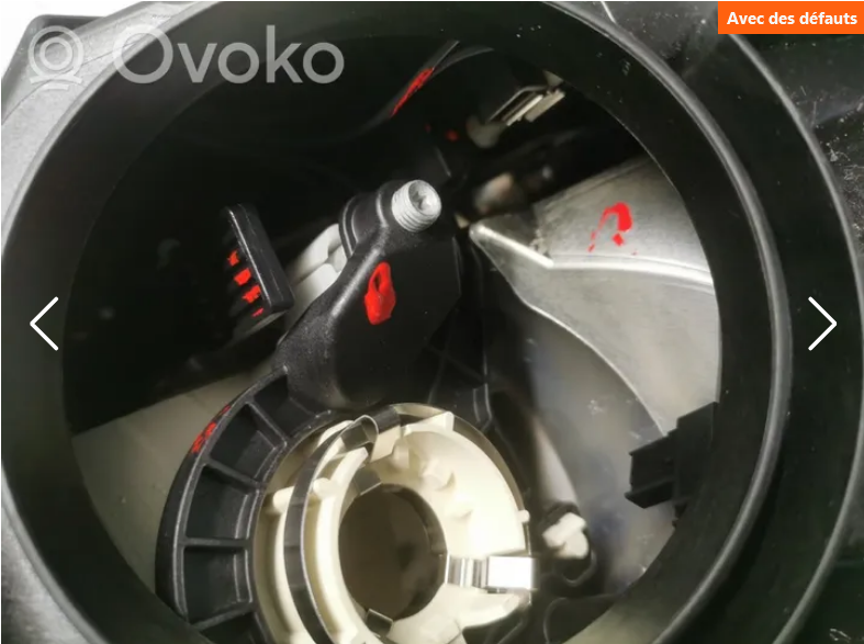

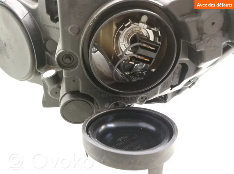

  12. Hello It seems that Skoda modifies the headlight bulb fixings according to the models. Here are photos of the headlights fitted to my 2020 Fabia Combi, with H7 bulbs. On the instructions, it is indicated that to take out the bulb, you must first press the base down, then take it out. Personally, I had difficulties, because the bulb got stuck. Eventually I pulled and pulled out the circular spring that holds the bulb, and had great difficulty getting everything back in place. (Google translation)
