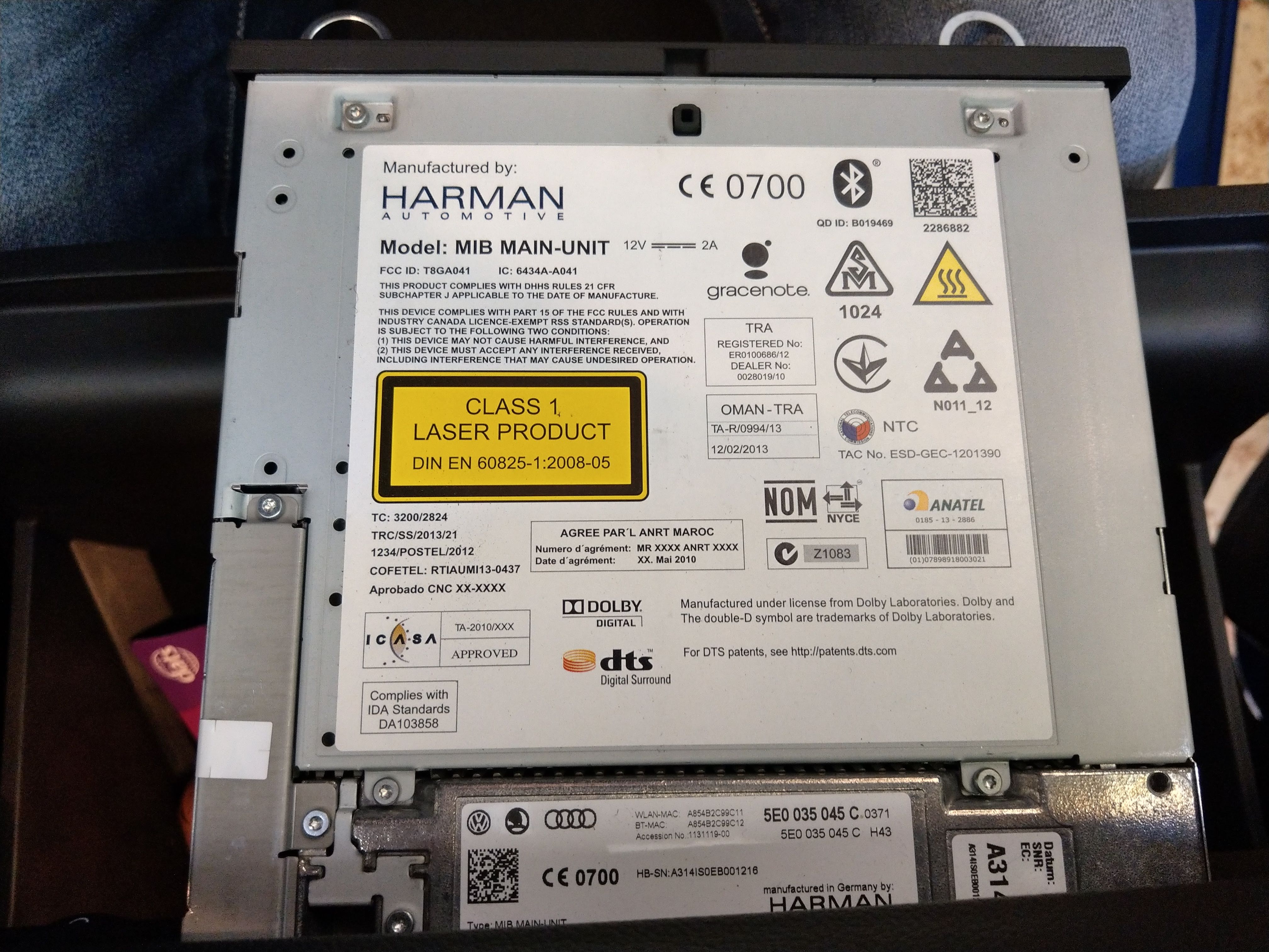

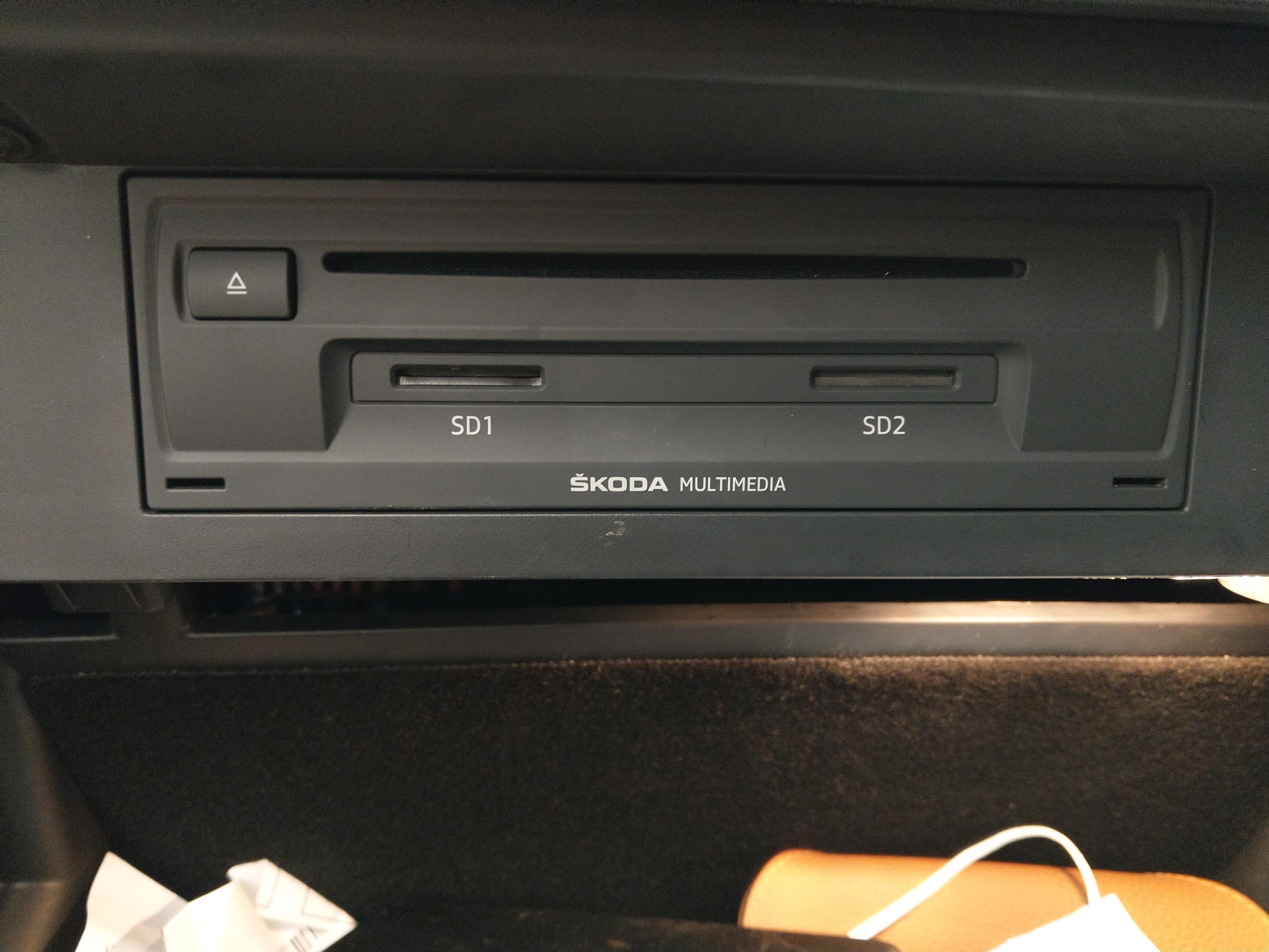

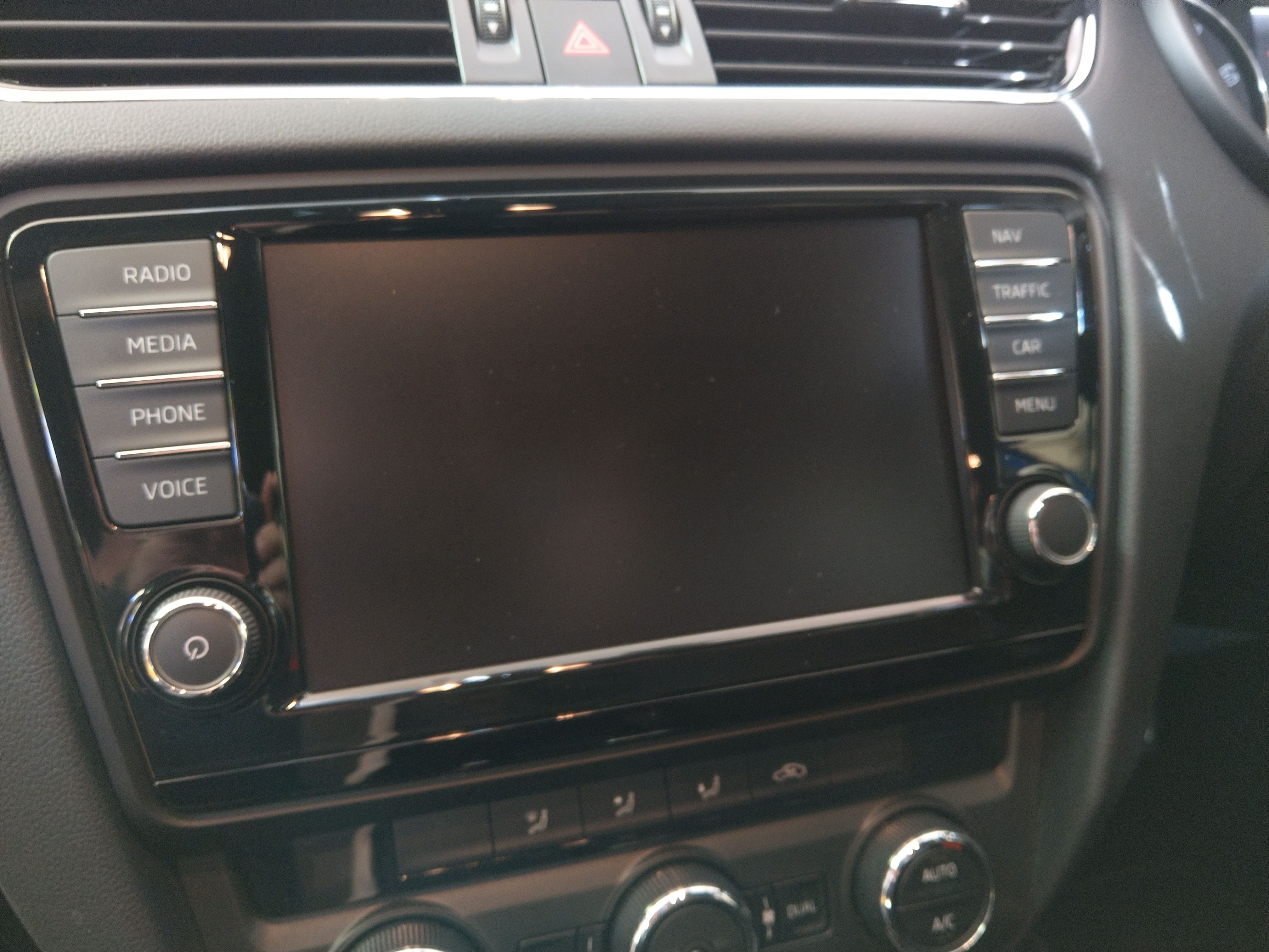

I used an android app called Car Scanner . It has a coding section and under multimedia was an option to enable Skoda surround sound. I clicked enable, heard a click from all of the speakers individually but it said that the coding failed. The unit then looked like it rebooted and now I have no volume options, almost like it is stuck in mute. I have tried factory reset, and long hold on power button to restart the unit. Turning the vol knob does nothing, ie the volume bar appears but does not go up and down. -
Have I broken the stereo?
OldAndyMac replied to OldAndyMac's topic in Skoda Octavia Mk III (2013 - 2020)
thanks for the quick reply. Sorry, I should have put more details in the first post. I think I have MIB1 Columbus so no external amp? hope the pics confirm this? -
So I was waiting for my daughter and started messing around with car scanner and tried to enable surround sound as I have read it improves things alot. Anyway, it didnt work saying that my blutooth dongle was not up to the job. I also enabled multimedia dev mode and then looked through that menu on the screen but changed nothing. Turned everything off, picked up my daughter and now there is no volume at all. Turning the vol knob brings up the volume bar but does nothing. There is no 'sound' option in the settings now, it is greyed out. I have tried doing a factory reset but it changes nothing. Everything still seems to work, nav etc but there is no sound. What have I done? any ideas? thanks guys 😞
