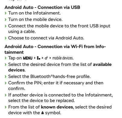

    and that both Bluetooth and WiFi are enabled on the phone.
From the owners manual;
so it looks like Android will work by both Wifi and USB cable.
Smashing thanks. That will be excellent, no more cables !
Nope. It doesn't work.
The option is there but it is not connecting.
I still haven't tried the cable approach.
