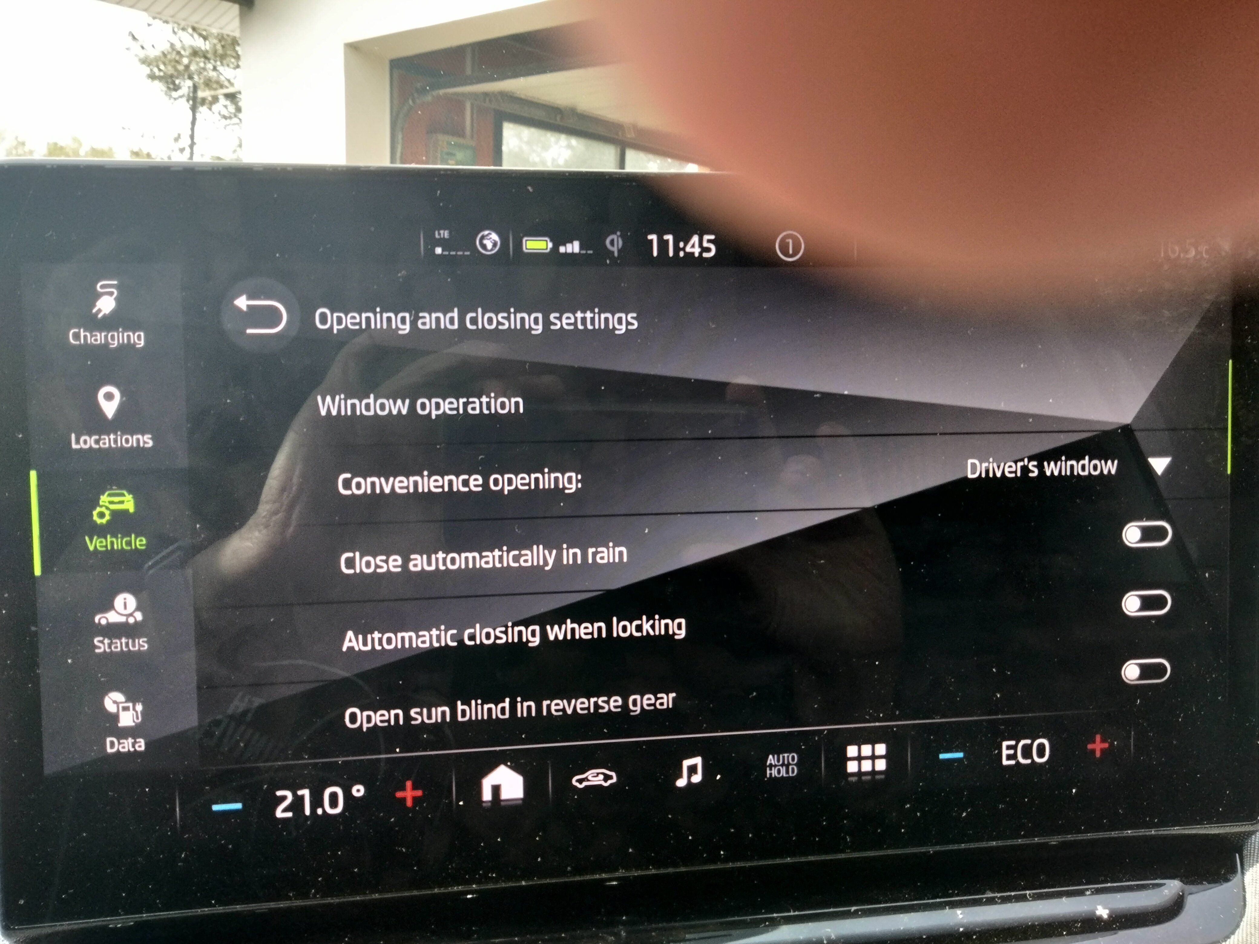

  12. Well the manual does not mention any of the actual setting options. I would doubt that it is any regional restriction - the manual heading does include the words Electrically operated. And troubleshooting includes instructions for reactivating window operation after battery disconnection. Might try that next trip. Just also checked the ID.4 manual (more detailed) not mentioned. Think perhaps the function was foreseen and planned but is incompatible with deep sleep.
  13. Here is the pic from Infotainment boot from deep sleep. Press start and it instantly changes.
  14. Try entering the car after it has been in deep sleep just after infotainment boots up.
