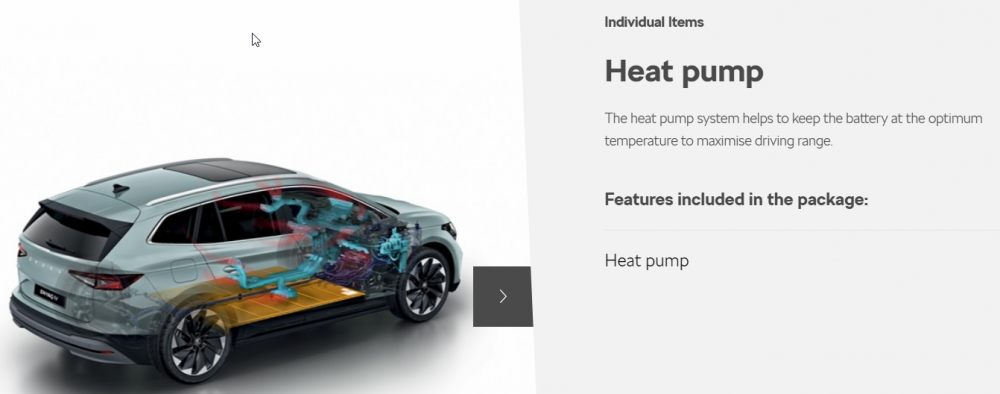

According to the Enyaq Skoda UK configurator, the Heat Pump assists with battery temperature control:
Strange then that the VW ID.3 information makes no mention of this, merely that the heat pump reduces battery load compared to the standard heating system.
Heat Pump | Electric Car Software & Tech | Volkswagen UK
Anyone one know whether the heat pump does actually assist with battery temperature control?

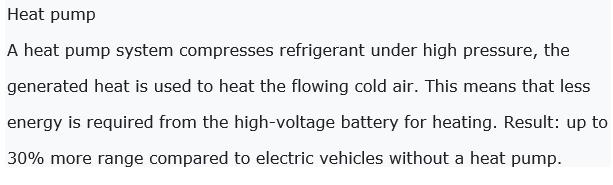

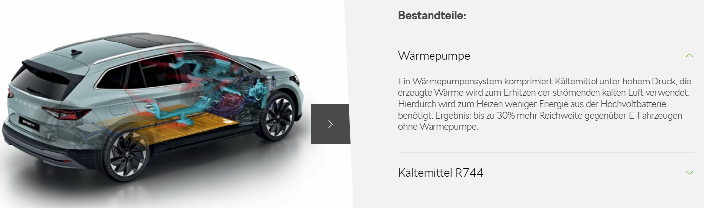

  • Well, to sort of answer my own question, from the German configurator          Which translates via Google to:     So, it would appear that either t
So, it would appear that either the UK spec heat pump has a different function or whoever writes Skoda UKs configurator is, er, perhaps wrong. I can guess which is the right answer...

I'm sure it will have an effect on the range in cold temps, what I'm not convinced about is Skoda UK's claim that the heat pump optimises the battery temperature (with no mention of it being a more efficient method of heating the car's interior).....
Well if it's a decent implementation it should do both. Both Jaguar's and Tesla's heat pump systems scavenge heat from the battery and drive train to heat the cabin and vice versa. Heat is also claimed from outside air to heat the systems in the car.
I think if the heat pump option was used for battery conditioning, VW and Skoda would have made something of it - another selling point to the system. Skoda UK mention it - but don't mention the use of the heat pump for heating the cabin...

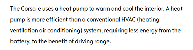

The Heat Pump works very well on the PSA Group EV's, they all have it.

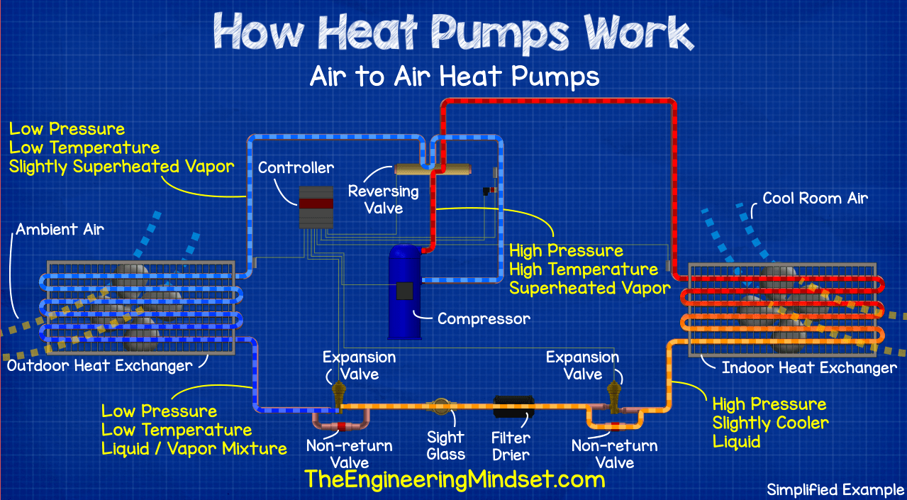

If it's a refrigerant heat pump system I'm guessing this would be using the car AC system & running it in reverse to produce heat inside the vehicle or battery compartment i.e. the a/c condenser becomes the evaporator & the evaporator becomes the condenser. In heating Hot gas from the compressor goes to the indoor coil for heating instead of the outdoor coil in normal cooling mode. This is normally controlled by a 4 way solenoid valve. Heat pumps are up to 350% more efficient than direct electric heating i.e. 1kw electric input = 3.5kW heat output.
Millions of Heat Pumps (air to air type) are sold for use in commercial & residential A/C systems around the world where they can cool in summer & heat in winter.  I have one in my conservatory.
99% of all modern air to air A/C systems are heat pumps. Heating only air to water heat pumps (no cooling) are now being installed in houses & commercial buildings to replace / avoid the need for gas / oil fired boilers. You can also buy heat pump tumble driers these days. It's all about reducing carbon emissions.
Below is an air to air heat pump system in heating mode.
Same system now in cooling mode.
Heat pump schematic - In cooling mode
