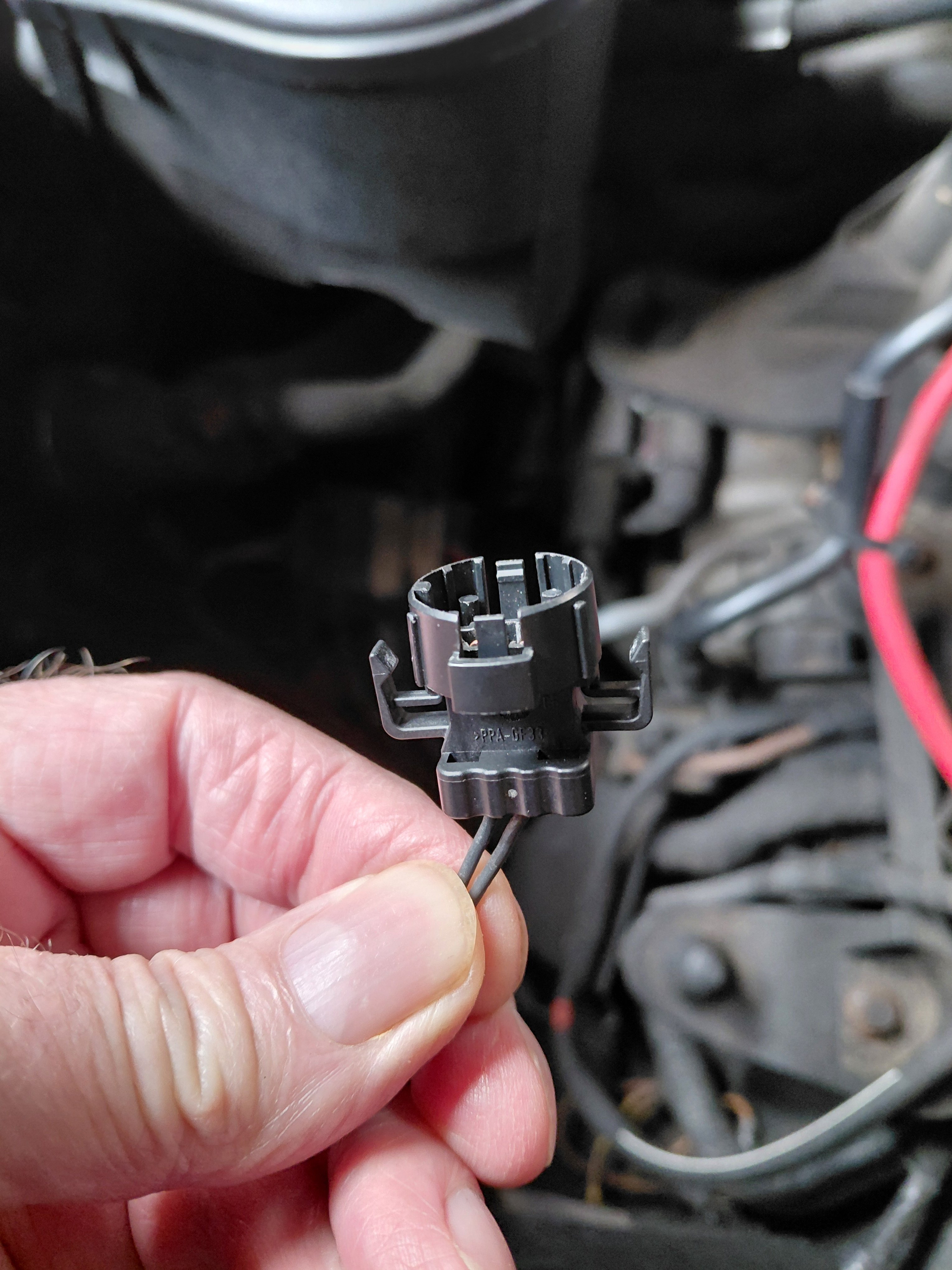

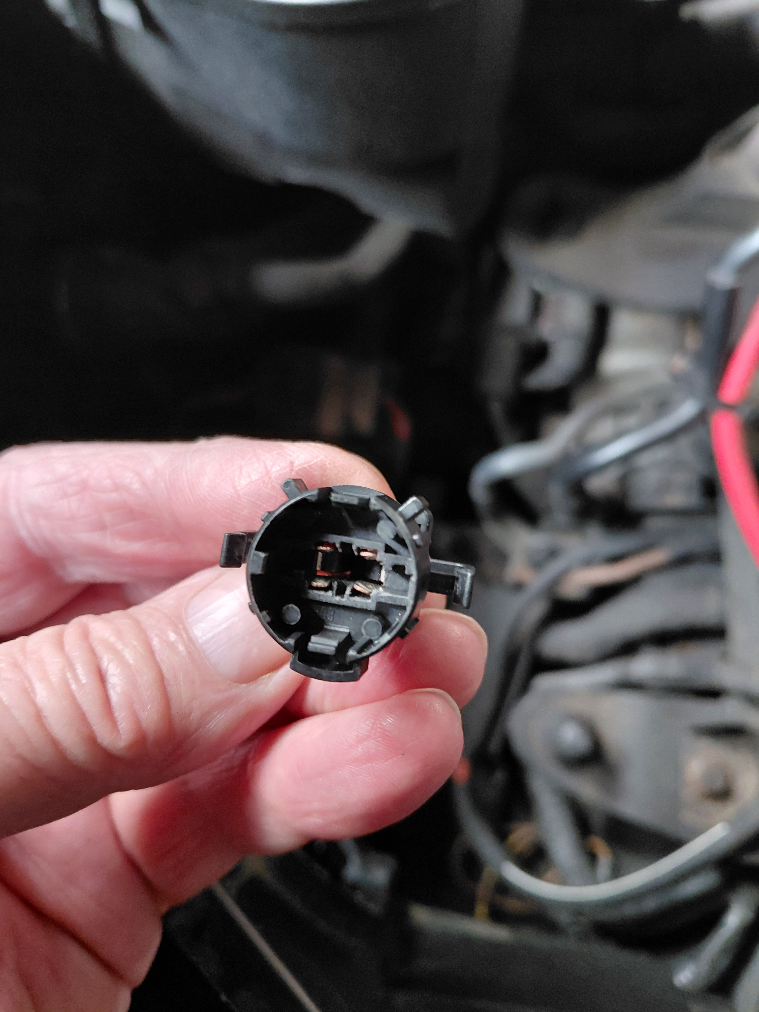

  1. OK....I've had to do some deep digging here. The bulb holder is NOT available as a separate part !! You need to buy what Skoda call an Electrical installation wiring bundle for the Front Halogen headlights intended for vehicles manufactured after MR2014 (face-lift model). The PART NUMBER is 5LO 941 813D Cost is around £40. I've ordered one, and will cut off and splice the new holder into the existing wiring, as otherwise it means stripping back the loom which I'm reluctant to do. It's only a simple 2 wire connection. For those of you who may get the same issue.... here's the culprit !!
  2. Hi As the title suggests, my 2017 Yeti has a defective n/s Front indicator bulb holder. The bulb itself is a Philips PWY24W 12V 24W - Single Bulb The bulb is fine, but somewhere within the bulb holder there is a bad connection. The bulb holder itself has two vertically aligned clips holding it in place with a square plastic alignment tab on the side and two double contacts within for the bulb, which end up with 2 grey wires running into the loom. Does anyone have a Part Number for that bulb holder please? I am having a real struggle trying to identify the part. Thanks in hope.

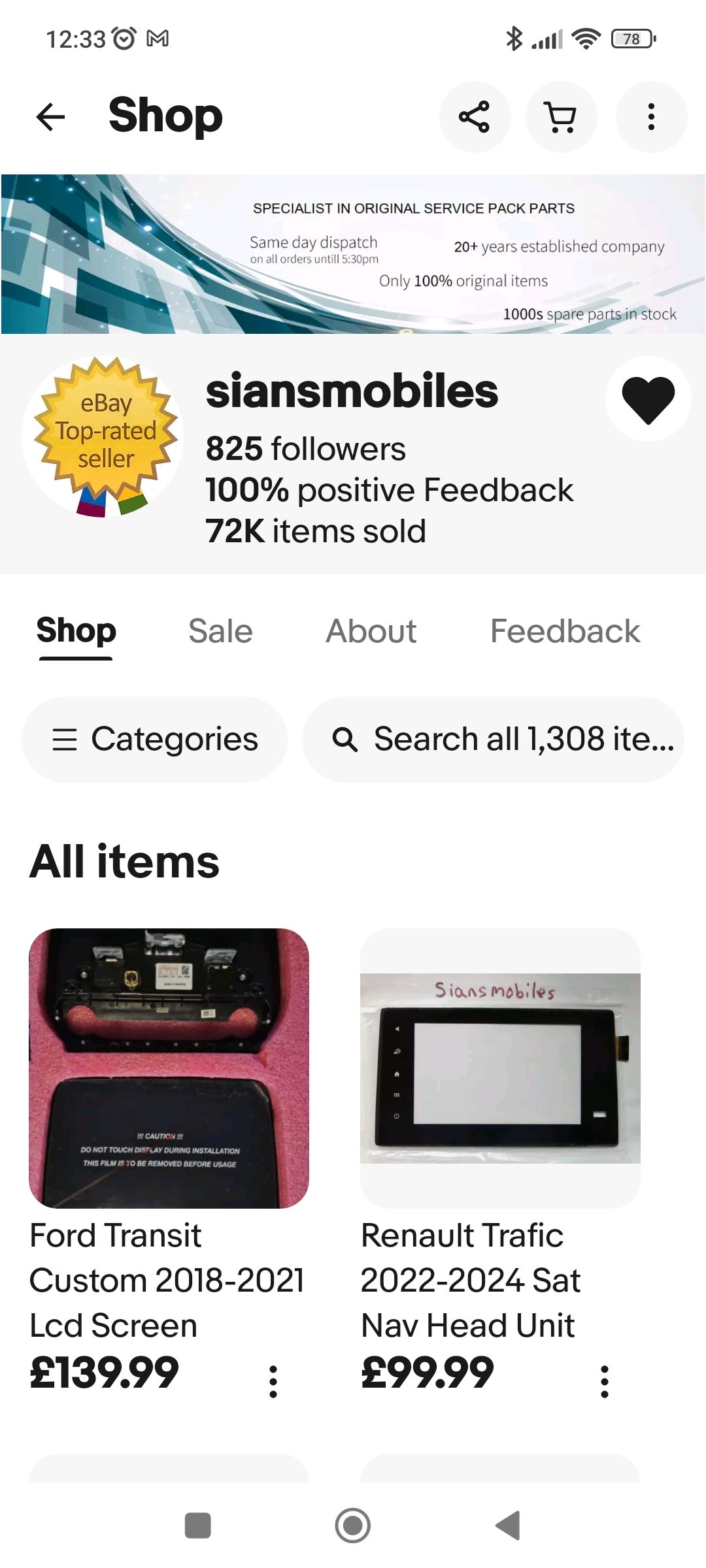

  10. You Tube is your friend here. There are numerous videos of VW radio units as fitted to Skodas, Audis, and many other makes. Type in "VW Radio touch screen repair" and you'll find them. Watch the videos until you're absolutely sure of how to do the screen replacement. Then go ahead. I'd allow a couple of hours, work slowly and take notes as you go. I used SIANSMOBILES on Ebay for my replacement screen.
  11. Hi Tycho Thanks for the pictures which give a positive identification of your radio/satnav unit. Sorry, when you said Skoda Estate, I assumed wrongly that you had a Yeti... But generally, if it's just the touch screen that's failed, they are repairable by simply replacing the touch screen front ( called the digitiser screen). There's a guy on Ebay called SIANSMOBILES who sells these screens. So don't give up with the one you have if that's your problem. Post in the Fabia forum for details of how to remove your unit. They generally come out very easily though. You'll need to get your unit out to positively identify which digitiser screen you'll need. I can't advise on alternative units. I don't use Apple at all, so have no idea. But replacing the digitiser will be your cheapest option.
  12. About this time a year ago, the touchscreen failed on my fitted 2017 Yeti Amundsen Mib2 radio satnav unit. I got great advice from a number of members, and eventually my wife and I decided to replace it with a non touchscreen Kenwood DPX 7300 Dab unit. What a NAIL of a unit! Well, what a mistake THAT was... The manual might as well have been written in Swahili, the customer service was a shambles, none of the steering wheel controls worked, and operating the unit was a nightmare. It was a SHAMBLES! Complete waste of money.. So the other week, I fished our Amundsen Unit out of the cupboard and decided that I would get hold of a Digitiser screen and attempt to fit it. I had always been very hesitant about this. I am no techie on audio equipment. So I bought one from Jonathan at Siansmobiles on Ebay, and set to work. Two hours later, and I had a fully working radio satnav unit back in the car. Success. So really, this is just a heads up.... If YOU have suffered the dreaded non working touch screen issue, don't give up..... do as I did above. With reasonable care, some spare time, and a few small tools You CAN do this yourself and avoid the absolutely ridiculous prices quoted by main stealers. Make sure you order the right Digitiser screen and it really isn't difficult. I'm just turned 78...I did it! 😂 I don't know why I was frightened of doing it to be honest.
