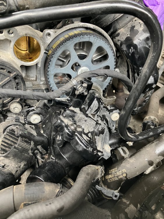

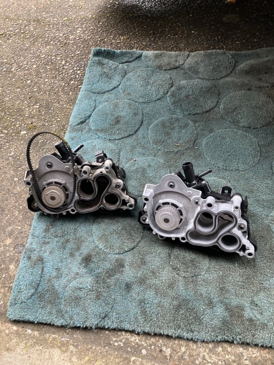

The actual pump part is alloy. Once I got it off I could see it was actually leaking from the impeller seal and then running along and appearing more or less where yours is.
1.4 TSI Coolant Leak From Water Pump

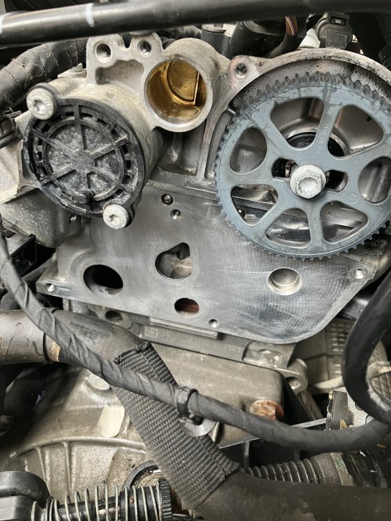

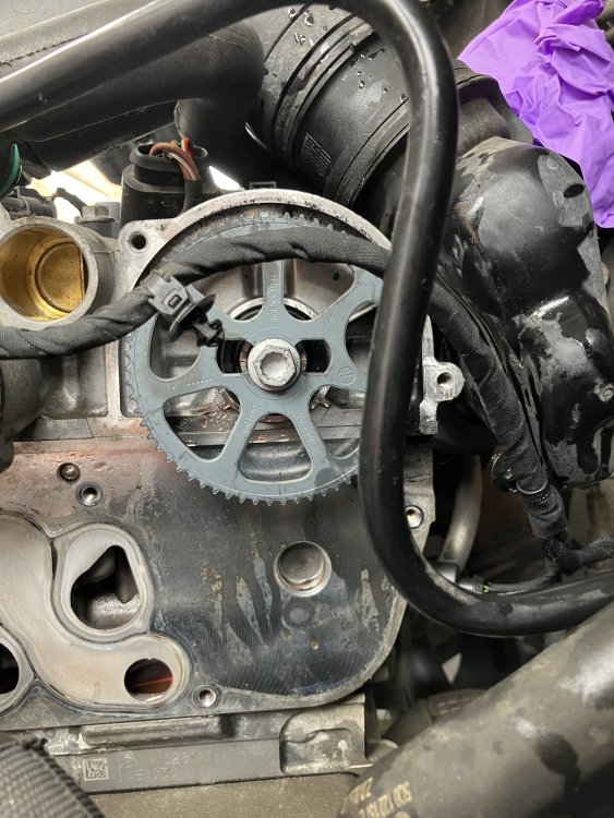

I fitted a new water pump to mine last year for pretty much the same leak. I fitted a new genuine Skoda water pump which is the whole thing including thermostats and housing. I paid £243.80 inc vat for the pump, belt and 5 litres of premixed coolant. You can buy just the pump part from motor factors but I decided it was better to just change the whole thing as it all has to come off anyway. It isn’t too bad of a job which took me about 2 hours. You have to remove the battery and battery tray and air intake pipe to the turbo to get access and you need to use a torque wrench to put the correct tension on the belt. couple of pics from when it was apart, 3rd photo is the old pump with the belt cover removed ;
