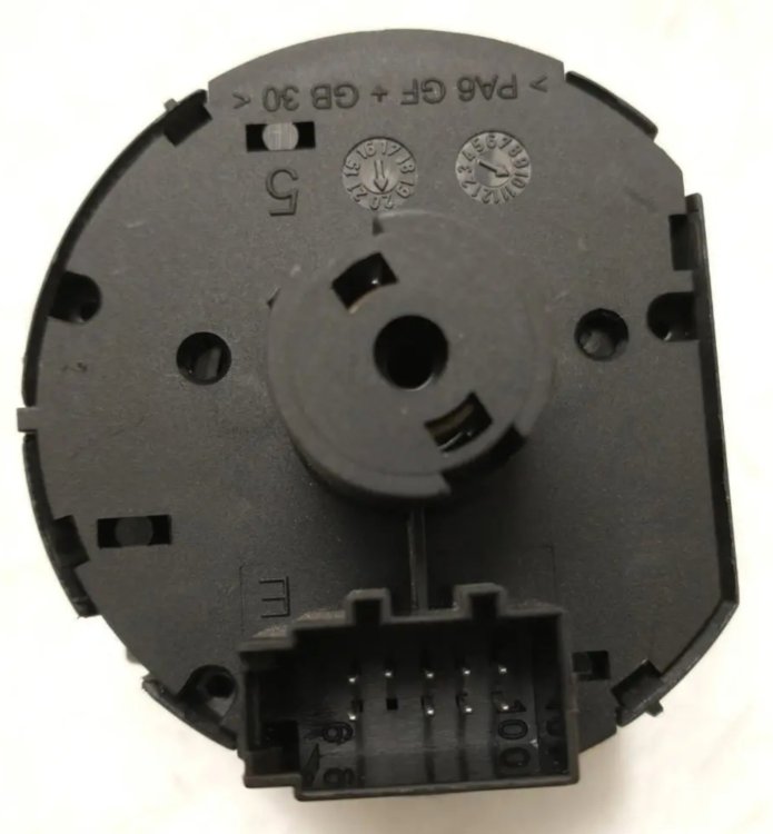

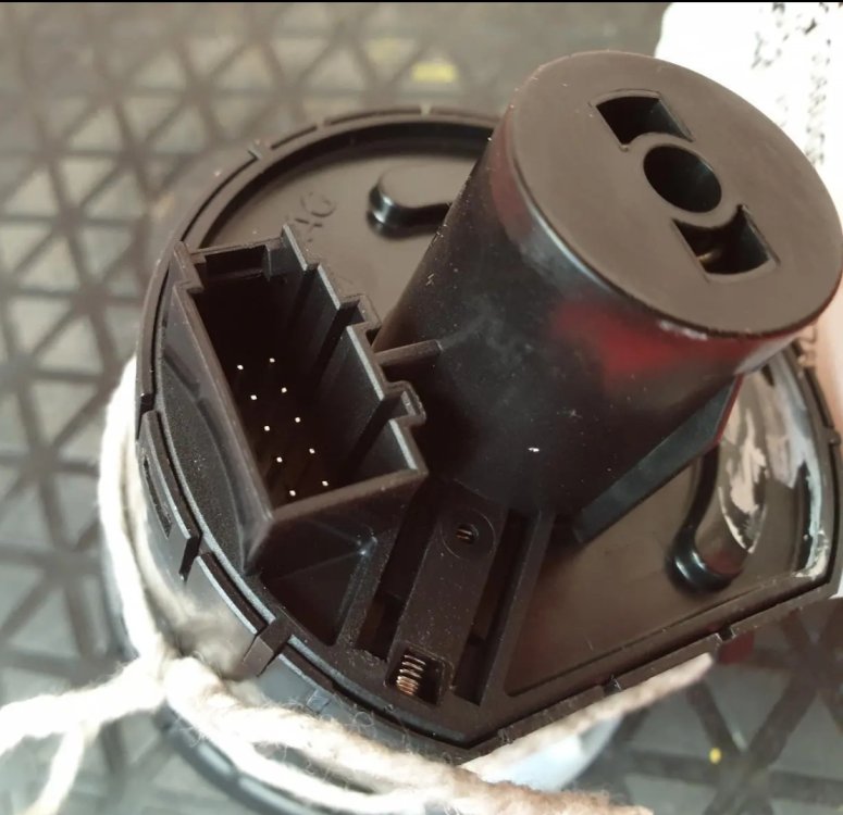

  17. Just check how many wires you have on your wiring loom, not the old switch. My switch has 10 pins but the loom has 9 wires. The switch I bought is part number 3V0941431 and seems to work perfectly.

  19. A small interior mod, a Superb MK3 light switch with added chromey bling. It is white and green instead of all green. It was all of £23 from eBay, I just confirmed I matched up functions and number of pins. I started looking at other items, such as Golf mirror adjuster, window switches and facelift climate control. I also looked at a frameless Golf interior mirror. I decided against all of it due to the level of work and that the mirror won't fit due to the connection. Also, I seem to have a combination of white and green already, my steering wheel buttons are white but everything else is green. I also really need to get other bits sorted so I'm looking at ball joints for the front end. Does anyone know the ball joint size for VRS'? On Autodoc there is multiple sizes, M12 x 1.5mm or M10 x 1.5.

  21. Hey all, I am wanting to install a headlight switch with a silver trim and keep the green illumination. Simple things to smarten up the interior. I figured I could get this from a MK3 Superb. The issue I am having is I currently have a 10 pin switch and I can only find 9 pin switches in the configuration I would like. I've included photos below for reference. I can't imagine VAG putting a pin in if they don't need it, but what are the likely differences/what would I be missing? Mine has Auto wipers, front and rear fogs, winter pack, non cruise radar, satnav, etc. Thanks in advance.
