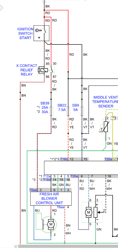

  15. Dealer took the car in about 16:00 and phoned me at 21:00 to say the blower motor is defective and he has ordered a replacement. He offered to put the car back together, so I could use it until the part arrived, but as it was a pig to get out I told him just to keep the car until it is repaired. It is not though I need it.
  16. Thanks I will do. Managed to get the car taxed today now that the DVLA has reopened so was able to go for a short drive and fill up with petrol. The car was a delight to drive with incredibly light steering after the Jazz (with Honda's first foray into EPS).
  17. This morning I took the opportunity of the good weather to dive back into the fuse box and check the voltage. With the ignition on there is 12v at the fuse so the X Contact Relief Relay is energising and switching. That only leaves the Fresh Air Blower Control Unit and the fan motor. I will leave the rest to the dealer to sort out. I am beginning wish I had never bought this car. I know all cars have issues, especially old ones but I have not even had it out on the road yet, and I am scunnered of it already.
  18. The Climatronic is the fully automatic system so you have no "4" setting. The system has been working since I got the car and then yesterday, without changing anything, it didn't. The fuse information in the manual and the Haynes manual match and there is a 30A fuse where I would expect a 30A fuse What I did notice for the first time yesterday was an intermittent click from behind the dashboard. Thinking about it, I wonder if the X Contact Relief Relay is trying to pull in but not managing. I tried the pollen filter advice from rum4mo but I am too old and stiff to get up under the dashboard. Tomorrow, which is forecast dry, I will get my multi-meter out and see if there is 12v reaching the fuse. This is the part I am interested in:
  19. Thanks. I will try that. I have had a look at the circuit diagram and the X Contact Relief Relay comes before the fuse so that not operating would stop the fan from getting power. I will check to see if I am getting 12v at the fuse in the next couple of days. That should isolate it to the relay or the motor. An acquaintance had to replace the fan motor in his Ibiza at the same sort of mileage. I hope it is not the motor as that appears to be a dashboard out job.
  20. 2009 Fabia 1.4 16V. Went out to start the car this morning and the blower fan is not working. Car has the Climatronic system. The control panel is working, I can hear the air flow valves working. Just no fan. I checked the 30 Amp blower fuse (Fuse 39) in the under dash panel and it is okay. What can I check next before returning it to the dealer?
