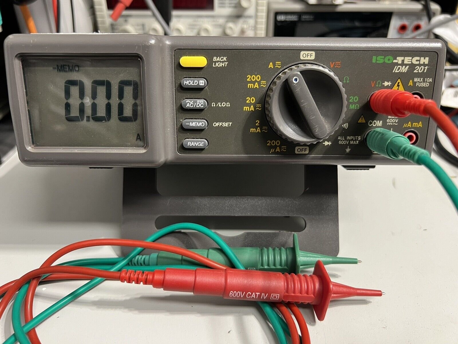

1.6 TDI FABIA 2011 PLATE: fusebox layout and missing fuses rear wiper not working
To measure voltages you don't disconnect leads. Leave everything connected up and measure the voltage across the battery terminals. A good battery should be 12.6v. Your reading of 12.3 volts suggests to me the battery is not great. 0.01 on the 2mA range on your meter is just noise. If you have a simple circuit of a 12v battery, a switch and a lamp all connected in series (wire from battery + to switch, switch to one side of the lamp, the other side of the lamp to the battery - ) then you will measure 12v across the battery and everywhere up to the switch. Close the switch and you will get 12 volts everywhere up to the lamp. This will still be the case even if you remove the bulb. To measure current you have to break the circuit and put the meter into the circuit. If you did you would not get current flow when you opened the switch or removed the bulb. You do get meters that clamp around a cable and measure the current flow but these are usually for large currents and impractical for measuring small current flows. You cannot restore a sulphated battery. A sulfated battery has a buildup of lead sulfate crystals and is the number one cause of early battery failure in lead-acid batteries. Eventually, a battery starts to draw current internally hence the reason a fully charged battery, left overnight, even if not connected, can be discharged in the morning. It sounds like your starter and alternator are both fine. I still think both batteries are knackered.
"I went through all the fuses touching all the test points on the top of the fuse bodies to see if any of them were carrying a current". That does not tell you a fuse is drawing current. It only tells you if there is a supply voltage to the fuse, at that time. You do not get Voltage drain, you can get a voltage drop across a component or a current drain through a circuit. if the voltage across a battery drops when you put a load on it it must be drawing a lot of current or the battery is duff. The X relay is a relay that has contacts in several unrelated circuits. I too use an intelligent charger, an AA 4A which has a Recovery mode which will charge a deeply discharged or sulphated 12V battery using pulse charging. It will charge a 12v battery showing only 2v. I used that on my battery and the car would start great. But next morning it was as dead as ever. I fitted the new battery on Wednesday and the car has been great ever since. As a retired electrical engineer with over 50 years experience, I love to get back into fault finding in simple circuits like cars. It has been a while since I had my multimeter out. I use an old Iso Tech IDM203, similar to this 201.

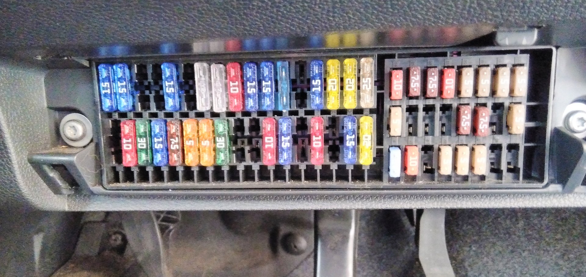

This is the fuseboard from my 2009 Fabia Elegance Hatchback. It has a 1.4 16v petrol engine. I hope it is of use to you. My limited experience with the fuse diagram in the Haynes manual has so far been positive. I do however think you are barking up the wrong tree. In theory, a 60 Ah battery should deliver 60 amps for 1 hour, 1 amp for 60 hours, or 200mA for 300 hours (12 days). In theory. A 3W bulb draws the current you measured. I take it you made the measurement with all the doors closed, the bonnet closed and the car locked. Just the boot/tailgate open would give you that current draw. If you are driving the car then the alternator should happily replace that use in a few minutes running. The alternator pumps out 50+ amps. Check the alternator is working by measuring the voltage across the battery with the engine running. I checked mine this week and it showed 14.5 volts. Personally, particularly with my experience this week (I had to buy a new battery), I think the original battery is done and the one you replaced it with is also kaput.
