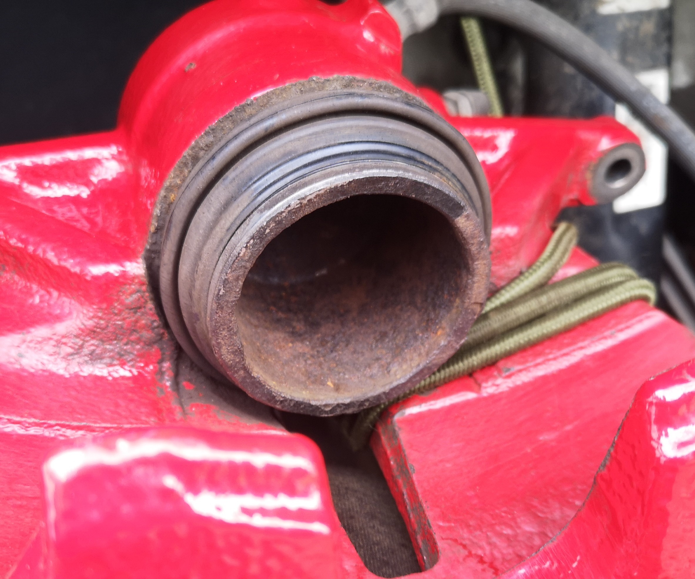

  12. These look really good. With buying wrong sized discs. I've waited longer to get calipers off. And upon removal.. Seen the condition of mine.. 😕 Can anyone say that this looks like a healthy piston. To me it looks shot.
