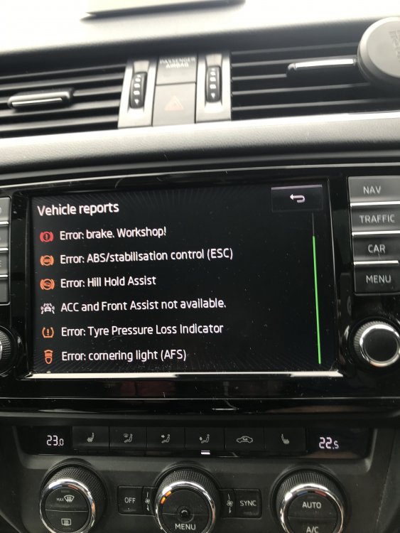

Multiple error/warning lights - ABS Wheel Speed Sensor issue?
Hi all, long time since I've been on here as touch wood have been enjoying many issue free miles in my Octavia.
Last week whilst returning home from a local trip I suddenly got a warning light and a chime,
Error: ABS/stabilisation control (ESC)
several second later I got another,
Error: Tyre Pressure Monitoring System
several seconds later, another...
Error: bend lighting (AFS)
when I slowed at the next junction I received a further warning
Error: Start/Stop system
I pulled onto my drive way and turned off, restarting the car all  errors disappeared the following day about 30 miles into my journey, they started to come up again one after another, a mile down the road they disappeared again, then nothing for a week. This week it's happened again about 4 times.

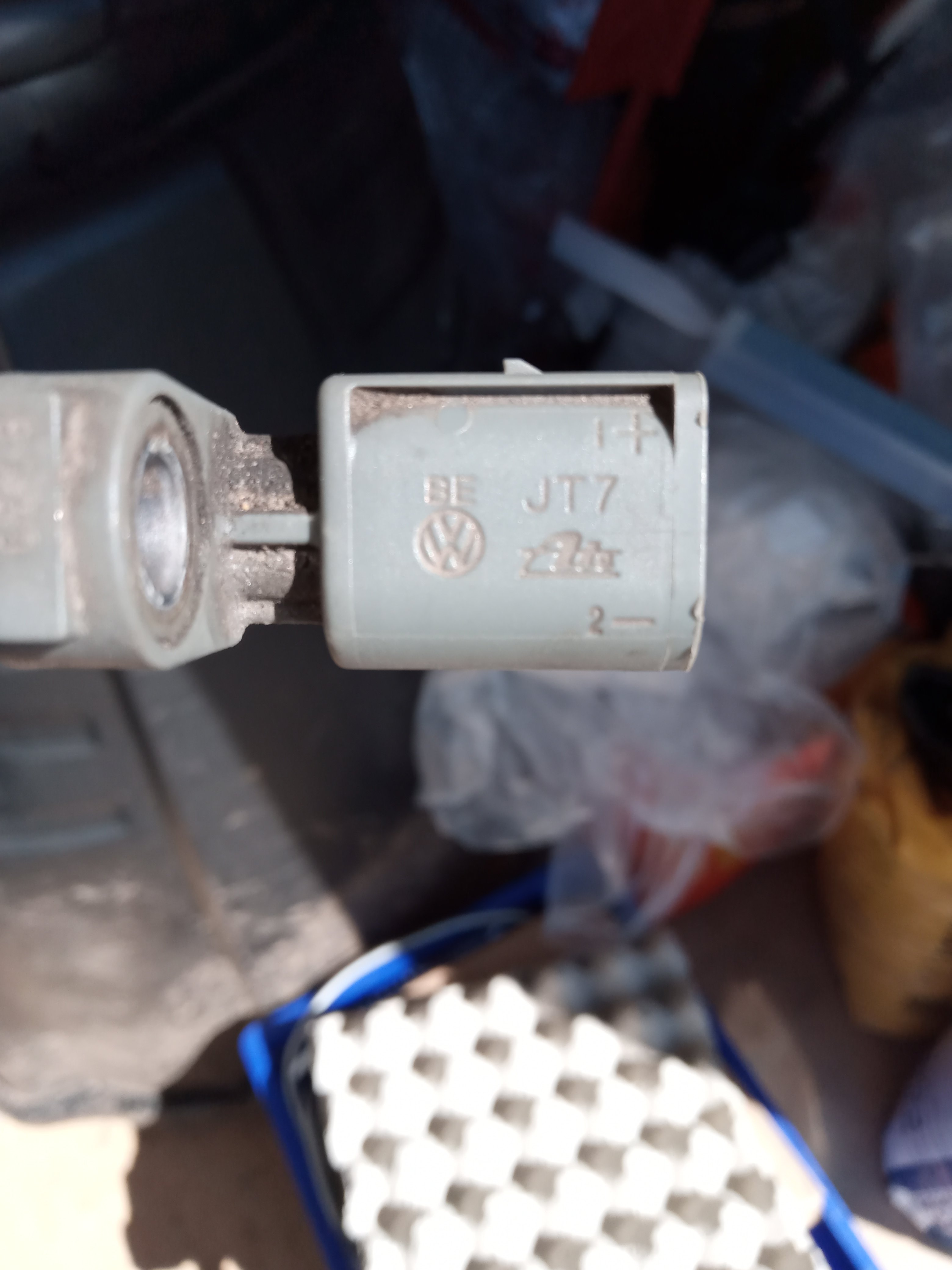

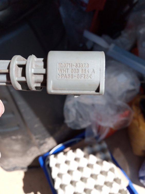

In case anyone is reading this with the same symptoms.
I purchased an OEM sensor https://www.onlinecarparts.co.uk/ate-7618461.html for £38 inc delivery, arrived from Lithuania 2 days later.
Part number for car with self parking is WHT 003 864 A, there are loads of manufacturers on this site but I went for the ATe one as this was the same as the ones originally fitted.

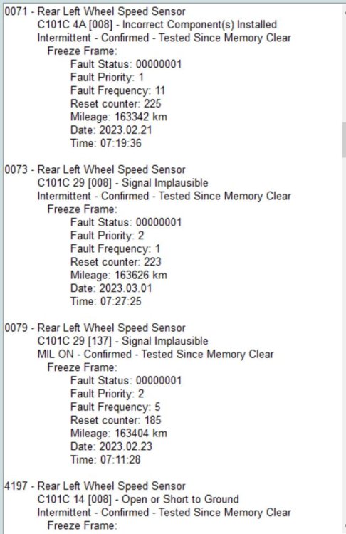

Hi all.
I'm not getting the same symptoms. Is it as simple as replacing the abs sensor and the car recognizes it itself??
My dash shows front right tyre pressure low. I've reset via radio etc
My odbeleven shows this..
I saw your PM before I saw this … I’d definitely give it a go with a new sensor. Easy job and the car should immediately recognize the fault as being fixed (if it has fixed it!)
Certainly the starting point, especially if you are not getting all the other dash lights
