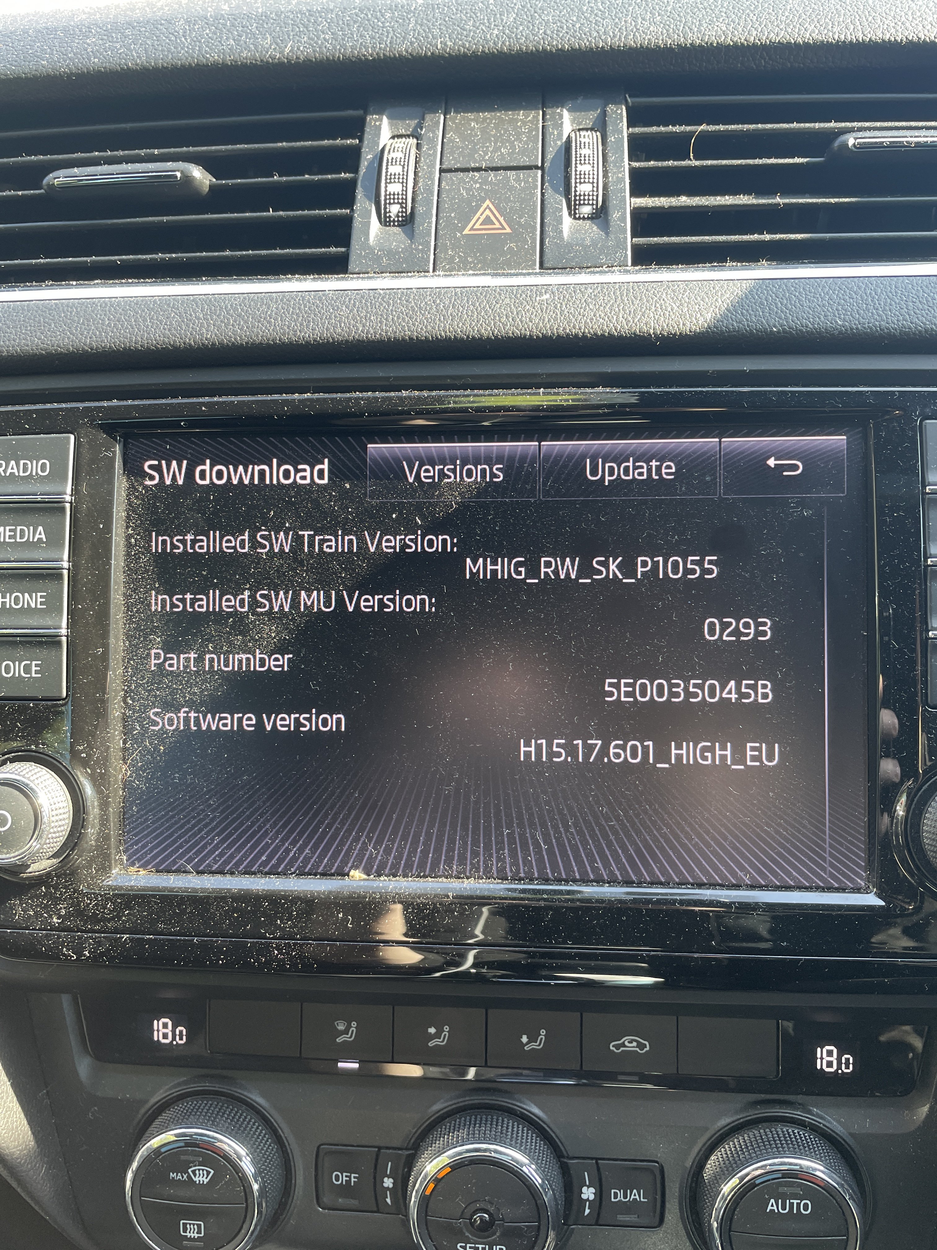

  22. Hi guys, I have the same setup here, a MIB1 system 5E0035045B here that has the intermittent sound issue. Skoda repairer said they updated the firmware which didn't fix it but it's saying it's only version 293. I have noticed a few people look to have had some luck fixing this issue with a v411 update. Can anyone help me? Screenshot of version display attached. Much appreciated.
