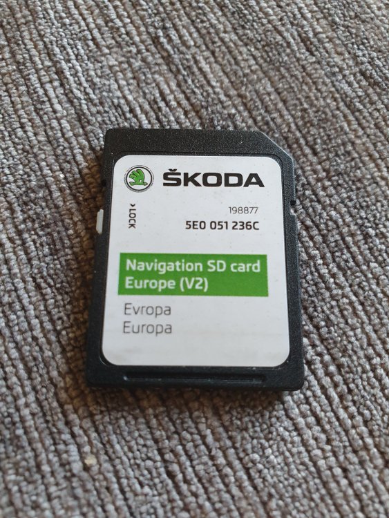

I'm struggling with my Sat nav in Mt mkIII Octavia. I believe that it's an Amundsen MIB 1.
And comes with a 5E0051236C card.
The questions are:
1. How do I use Post codes for navigation?
2. How can I update the card?
Thanks.16507942197782783263447223873749.thumb.jpg.97da2bee60b072856694c9c81ec3433c.jpg

1. There is a button labelled 'PTCD' (in the lower left IIRC) that appears when you are entering a destination.
2. Map updates can be downloaded from the Skoda portal (or from direct links posted on here), make sure you download the Amundsen MIB1 update that includes the UK. I always save the contents of the SD card to a PC hard drive, then quick format the card (FAT32 with 2K cluster size) and having unzipped the downloaded file copy all the unzipped contents onto the SD card. Insert the SD card into either of the SD slots in the glovebox and wait - sometimes I had to remove and reinsert the SD card for the Amundsen to correctly identify it as maps.

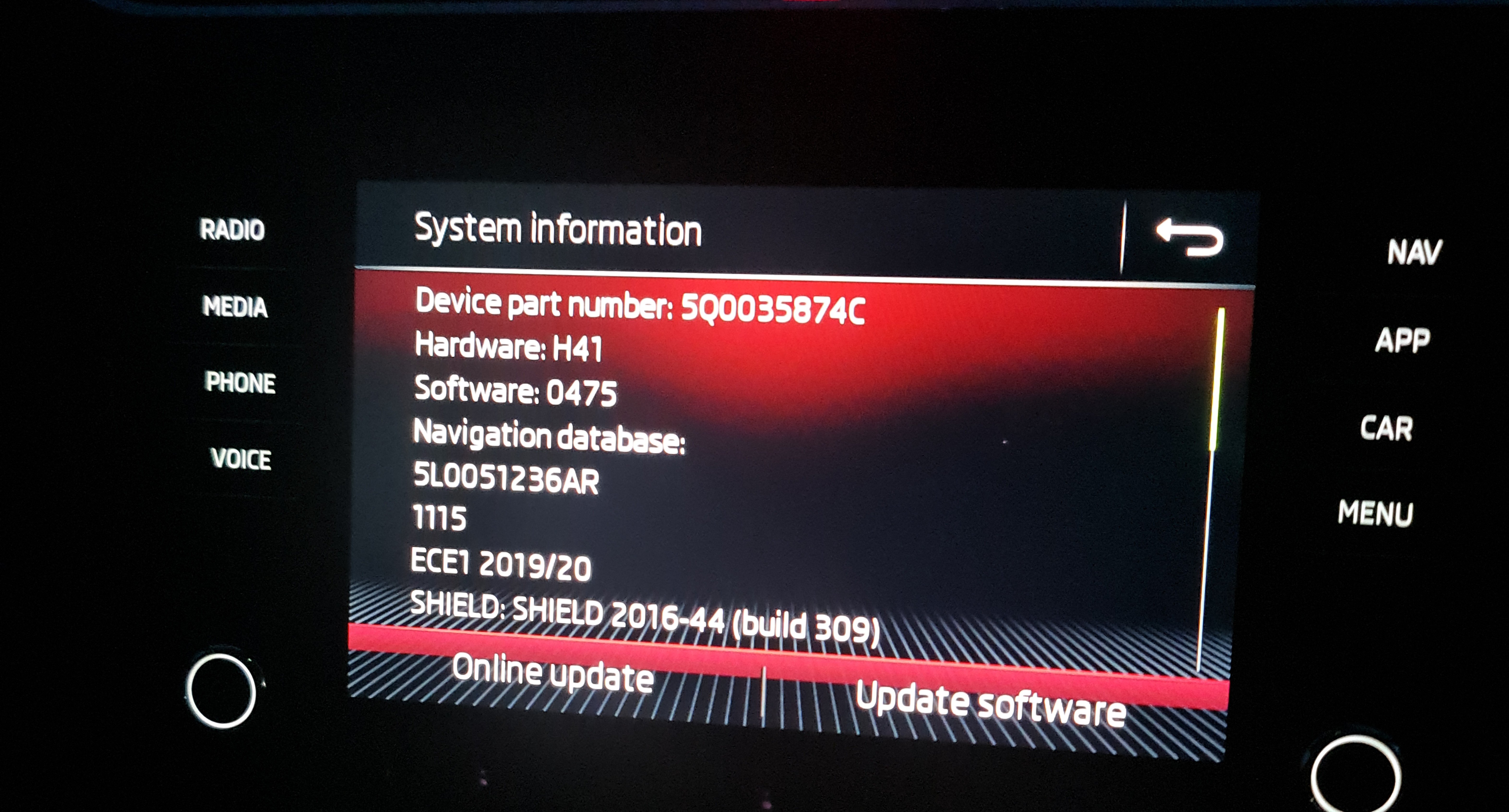

I am very new here and just purchased mk3 2019 VRS 245HP. I have been reading through some threads and unsure if all my firmware is up to date. Can someone point me in the right direction, with a guide on how to do it.
If I use online update nothing seems to happen.
@pab567 is it possible for PM and info on updating firmware, I have figured out the maps through Skoda website 😊

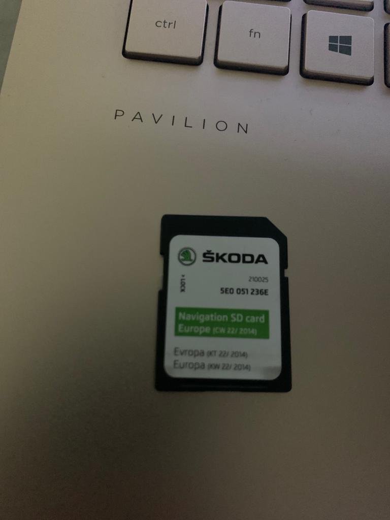

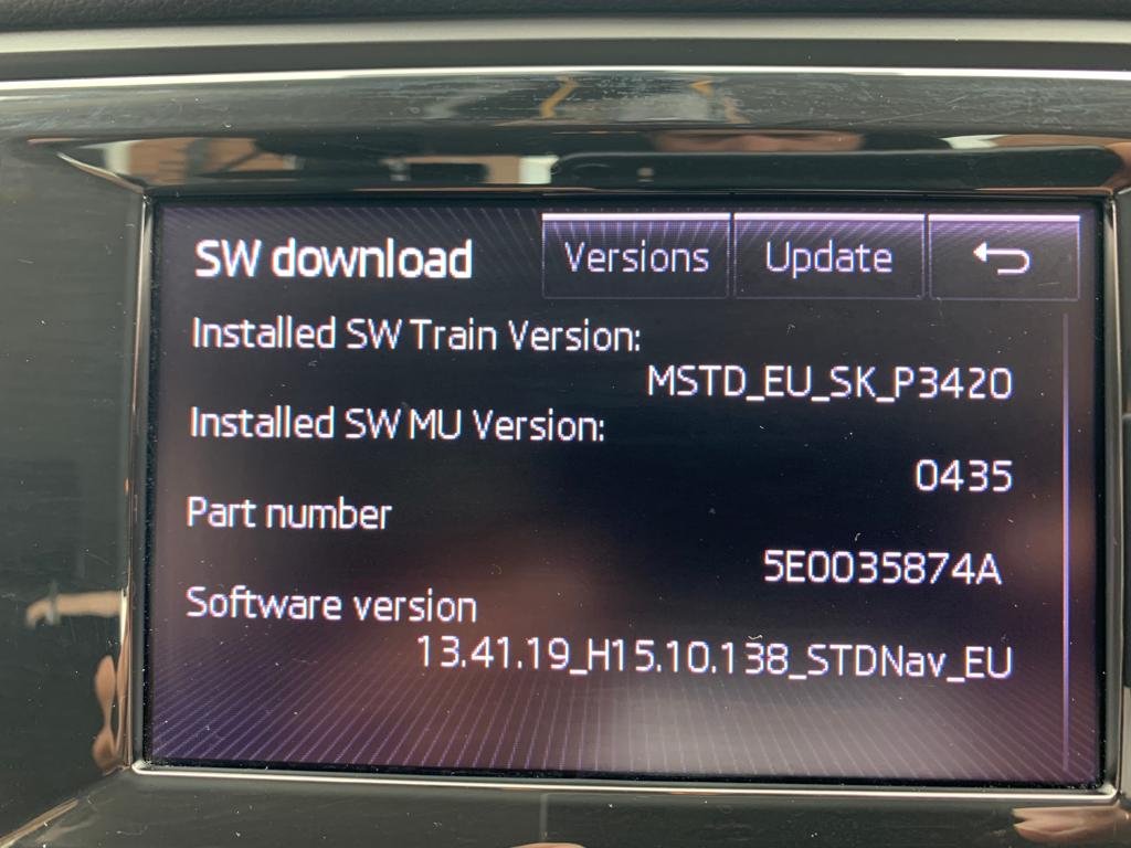

Good evening
i have memory card
the code writen on it is    5EO 051 236E
and i post the picture of head unit as well.
So what update i need.
Thanks very much

The SD card is navigation only not for updating the infotainment unit. You can login in to the Skoda portal with your VIN to update maps. You have to use Skoda format SD card for this, any other will not work.

You can update the firmware from
MSTD_EU_SK_P3420 (0435)
to
MSTD_EU_SK_P6230 (0490)
Maps answered above by @FrankNicklin
