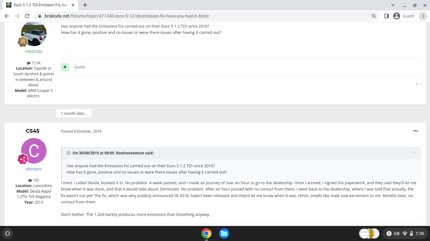

Some were the first VW engines to get The Fix, and were really messed up.  The 1.6 TDI fix was delayed.  Air Flow device & Software.
As it turns out, there were those that took in 1.2 TDI,s or asked about The Fix and said not required even though they showed on the VIN Checker and they got a letter.
There were ones that were never done but maybe the Dealership was paid when the VIN checker changed to not required.
