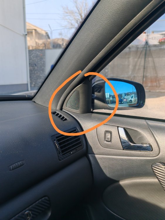

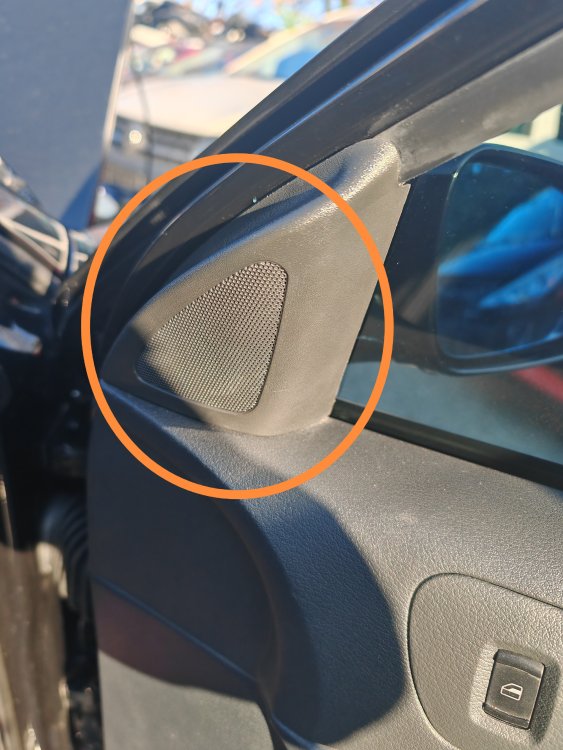

  23. Hi guys I need ASAP 1U0 837 994 47H ONYX (black) front right door tweeter cover They are discontinued and can't find them anywhere. Need it for custom speaker installation. Mine has one broken clip. Help please.
  24. Please ASAP They are discontinued and can't find them anywhere and on 12. February I have scheduled music installation. Please help me with that. My has one clip broken so it doesn't sit flat
