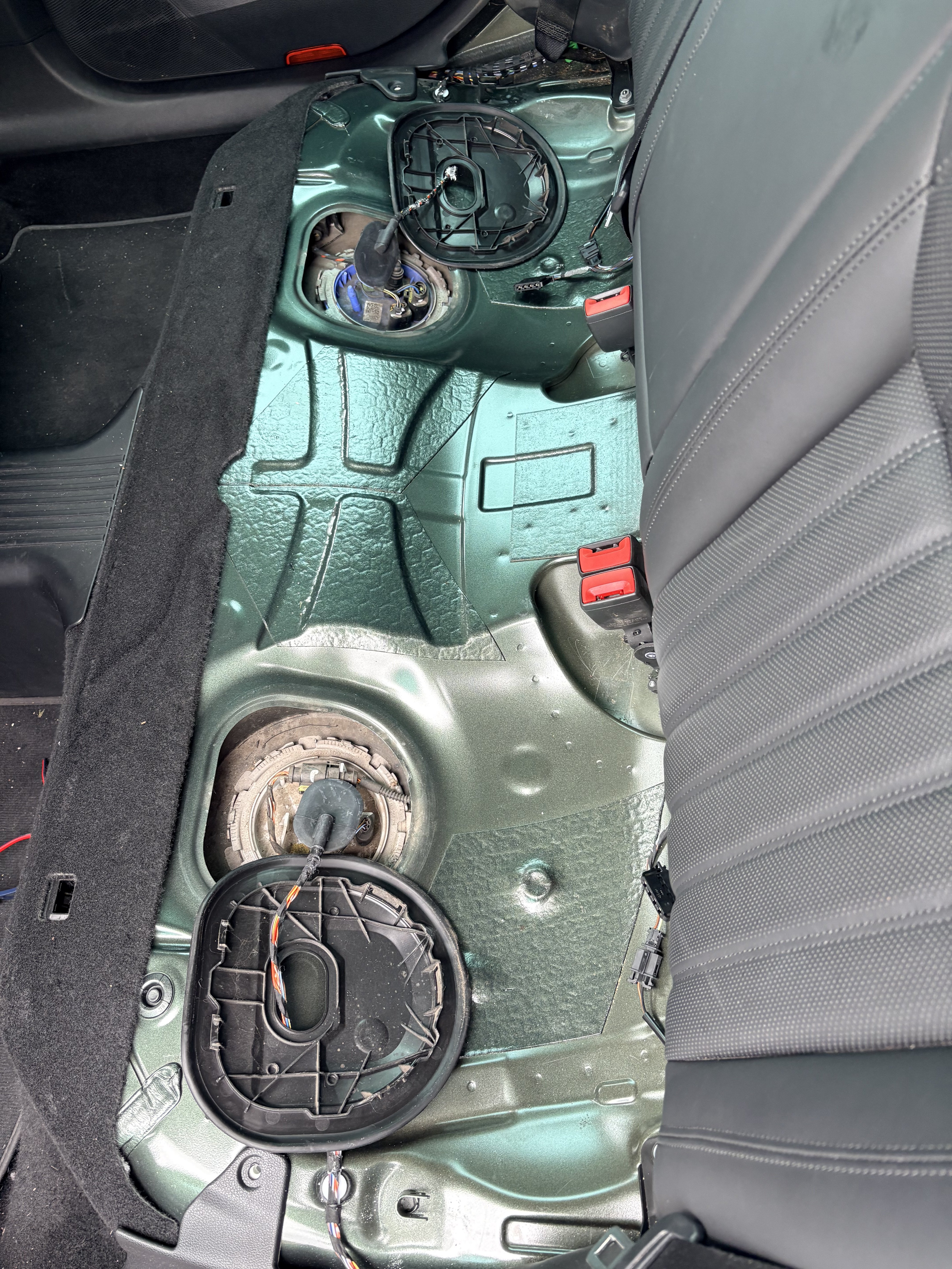

In case anyone is interested in how this was resolved. I read that on the 4x4 saddle tank the secondary pickup on the LHS drains the left side of the fuel tank first, once that’s empty it drains the RHS. LHS is just a pickup & a float sensor while the RHS has a pump and another float sensor. The tank was only registering a drop in level after about 200 miles indicating it was the LHS that was at fault. So after a couple of false starts I sourced the correct parts. I got the RHS float sensor from Skoda for about £110, part number 3Q0-919-673-K, I figured I may as well change it at the same time. I could only get the whole LHS assembly, I picked one up on eBay for £100, part number 3Q0-919-098-B I also invested in a fuel pump ring removal tool which made life a lot easier than using a chisel to get the pumps out. LHS side first, I popped the pickup unit out and just unclipped the whole thing from the hose and replaced it with the new one. On the other side I just unclipped the float sensor, popped it out and replaced it making sure the wires were rerouted the same way. On opening up the suspect float sensor the pickups were very worn and was showing intermittent resistance so definitely where the fault was coming from. On the plus side the fuel gauge appears to be working properly again.

I filled the tank and managed to get 58 litres in on the first click. So if the 4x4 tank holds 65 litres, that means the trip computer and fuel gauge is definitely still over reading by some margin. I had the RHS pump out the other day but when I saw the extra pipework disappearing off to the 2nd off take I admitted defeat and put it all back without any further tinkering. I have a service coming up so I might just get the readers replaced at the same time….

So with no other option I hooked everything up again and gave both pumps a good wallop with a rubber mallet. That resulted in this: I don’t know if that’s freed something off, gauge is still reading full but I’ll see if it moves at all next time I use the car.

Got the RHS side tank open, realised it was fuller than I thought and quickly sealed it up again while petrol ****ed all over the driveway. That resulted in another code which I cleared.

Bit of an update. Got my hands on a VCDS cable. Managed to get my road signs activated & change my throttle pedal to Audi to make it work so the car goes forward when you press it, cleared all the codes from where the battery went flat & did a couple of other bits. Then turned my attention to the fuel tank. Here’s what the gauges were reading beforehand.

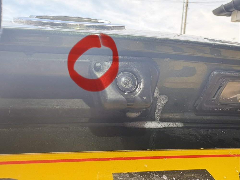

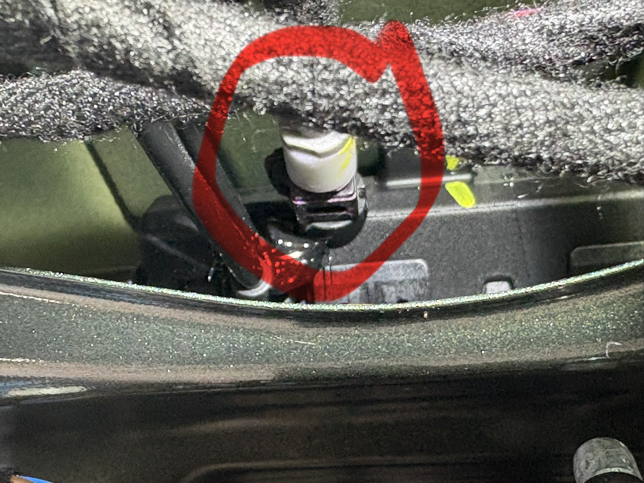

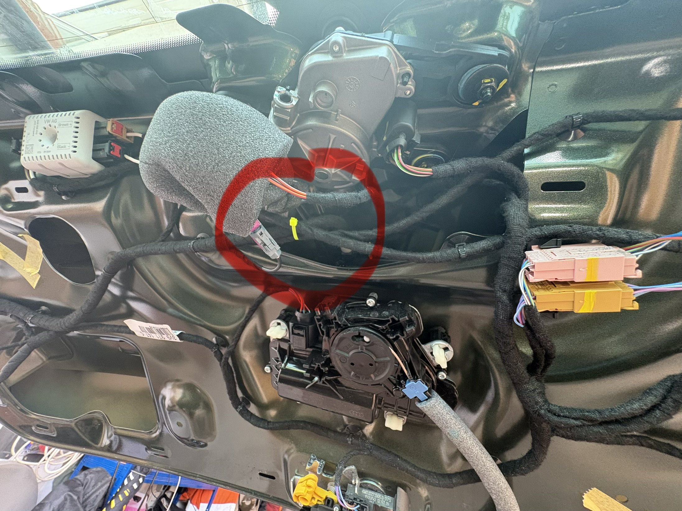

Rear Washer Leak Through Tailgate
Because I’m always very grateful to find answers to car issues on the net, allowing me to fix them myself… A couple of times recently my ‘door open indicator’ started to go crazy, beeping constantly, and I could hear the rear latch cycling. Upon opening the tailgate I found washer fluid leaking through the latch mechanism. On taking off the rear panel I found a squirter jet flapping about. (No photo sorry) As mentioned above the reversing camera has a washer which protrudes slightly from the rear tailgate release. It looks like the nozzle had been pushed in, probably by someone over enthusistically hunting for the button. All I needed to do was clip it back in the hole… And secure the pipe with a zip tie to hopefully stop it happening again. Hopefully that’ll sort the issue….
