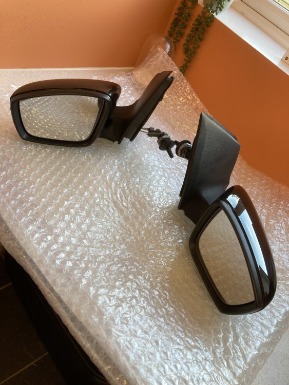

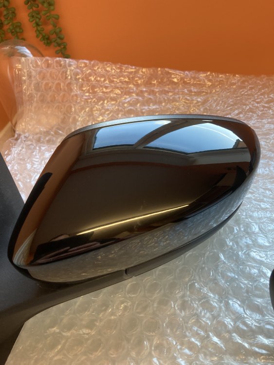

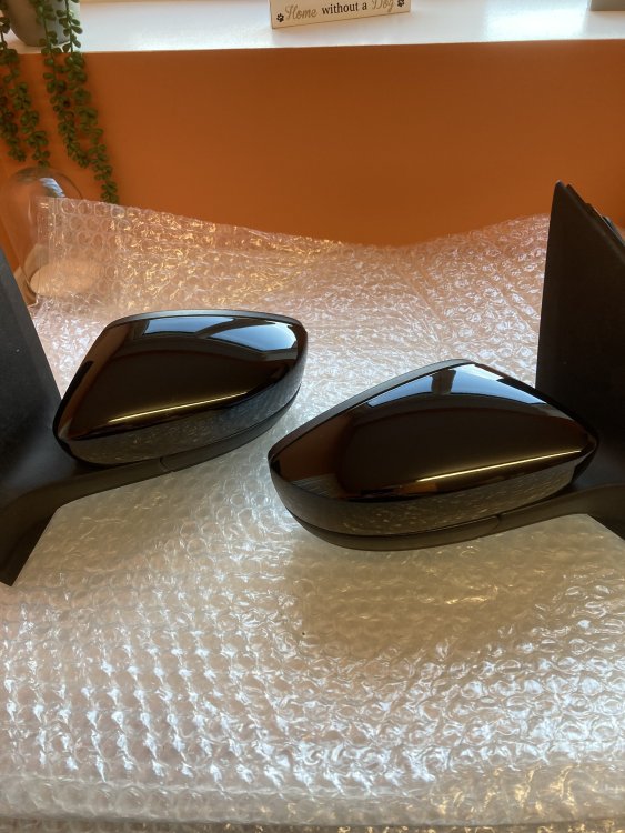

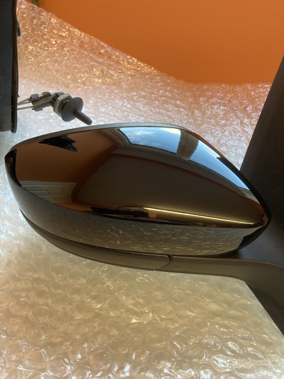

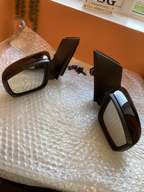

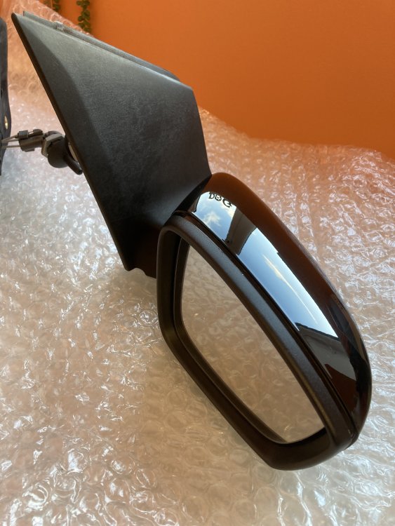

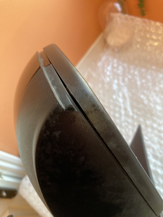

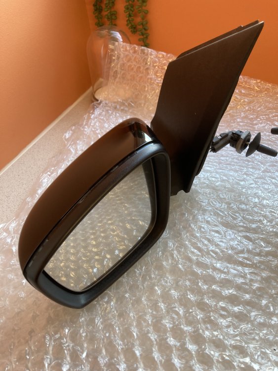

Citigo mirrors black complete
Both sides manual adjusters, caps were both new in October off the rock up, and immaculate still one outer black plastic cover has a slight gap at bottom but doesn’t affect anything, and not noticeable once fitted Located york £100 pair or £60 each
