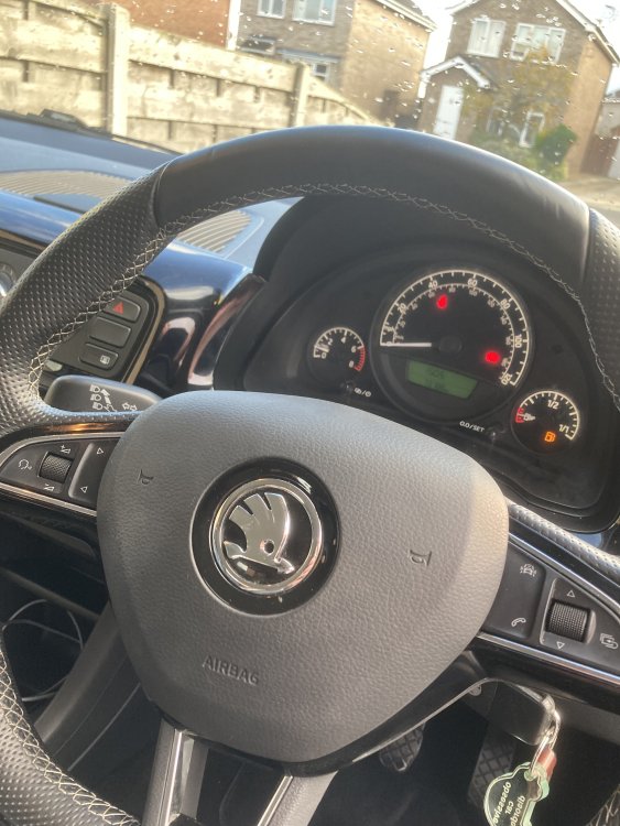

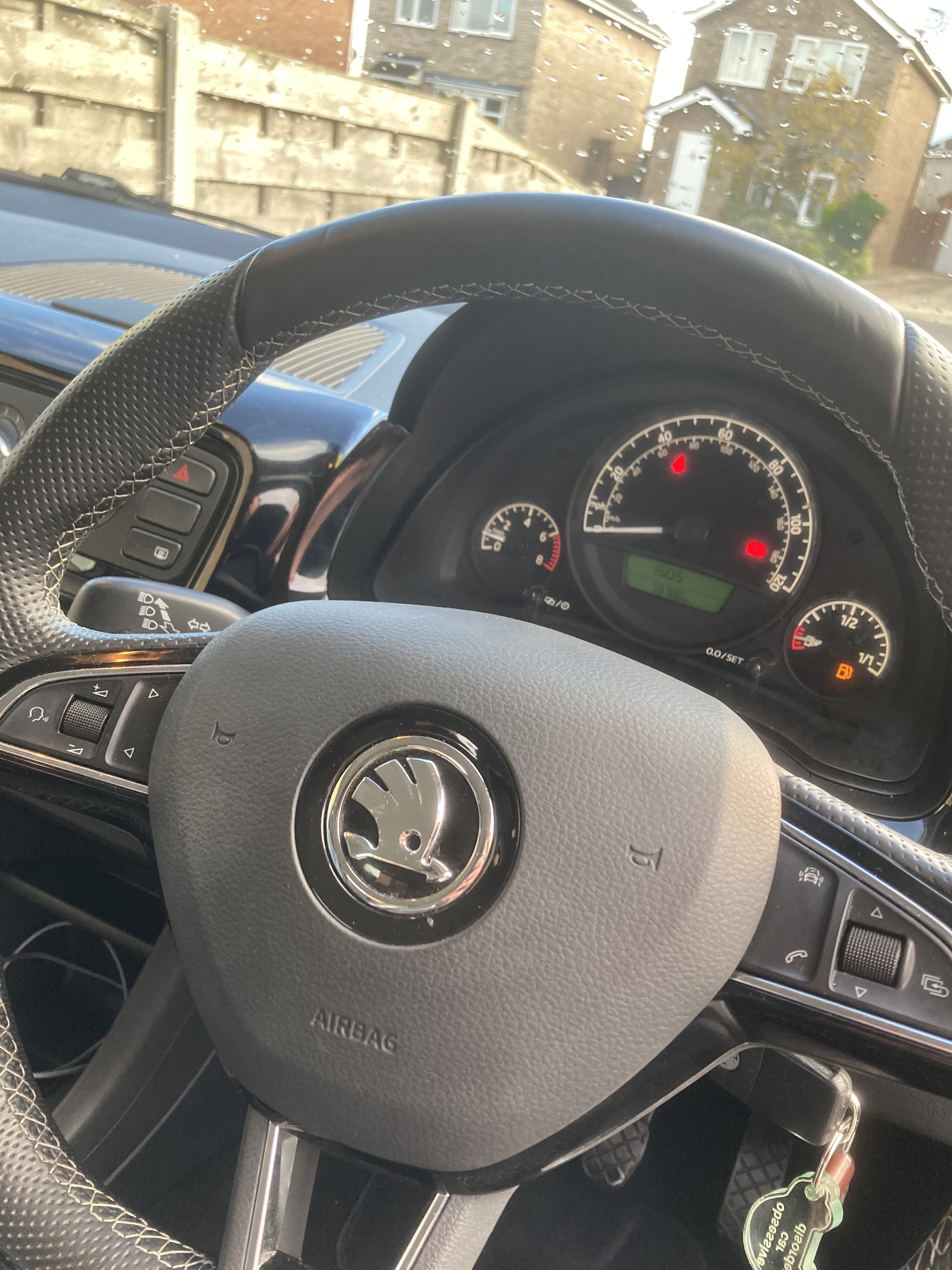

Finally got my last two warning lights out today, due to a crash detected fault in steering column control unit I originally had a red power steering light and power steering wasn’t working. I managed to get steering working by resetting the control unit to factory settings although still had yellow steering light and traction control light on due to basic settings not being carried out. No matter what I tried I couldn’t get basic settings to adapt. Booked in with a local independent with access to Odis which is a vw guided way of diagnosing faults and straight access to the factory. Luckily this sorted the light out and managed to reset the steering, and all sorted in less than an hour . IMG_1650.MOV

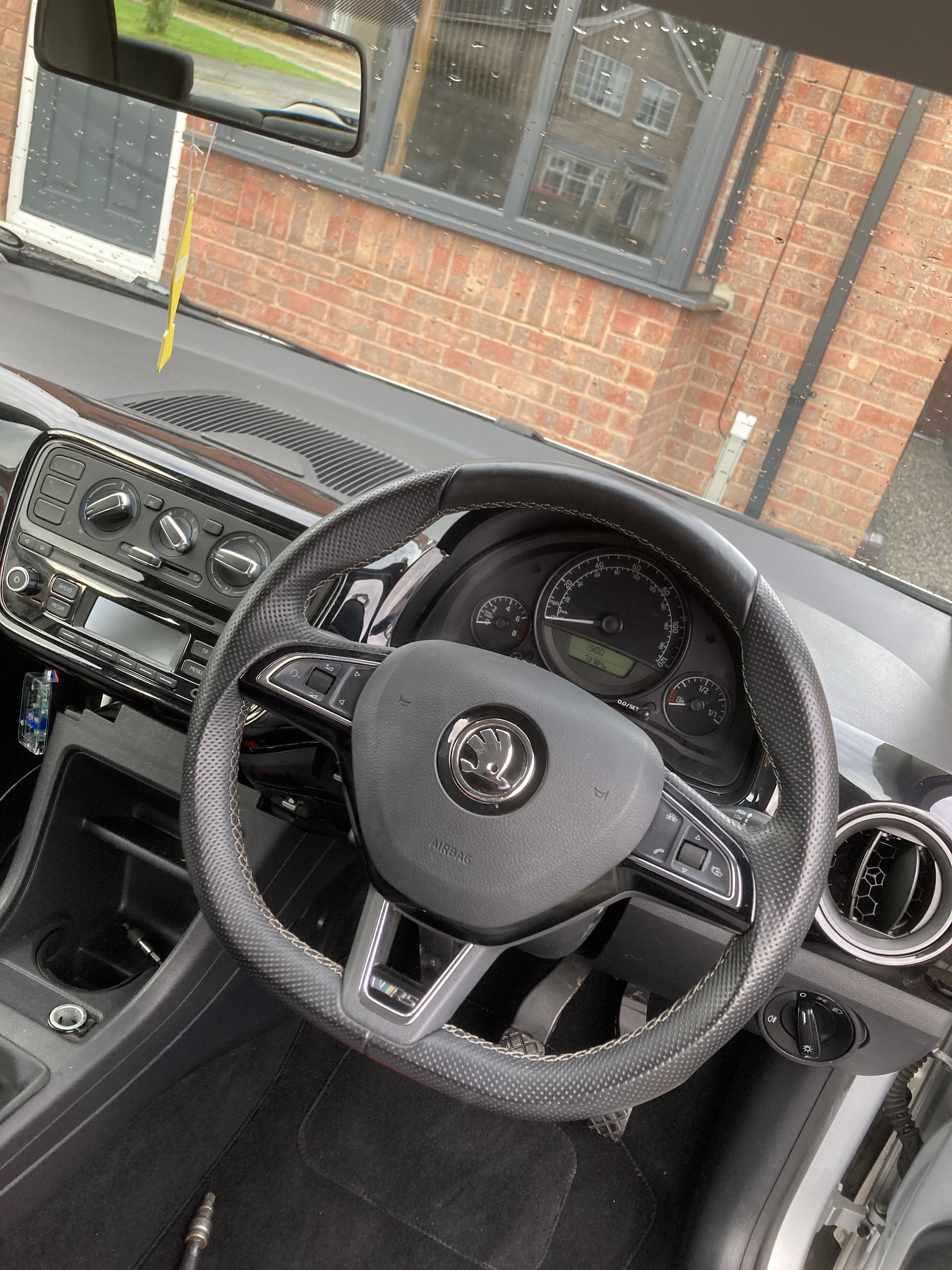

Little night shot, the steering wheel controls work the stereo but unfortunately doesn’t toggle the dash functions so I’ll need to experiment with that see if I can get some different buttons to work as I really don’t want to change the wheel, at least it looks good
