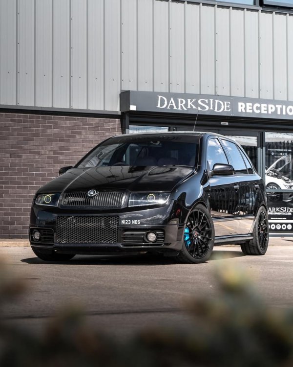

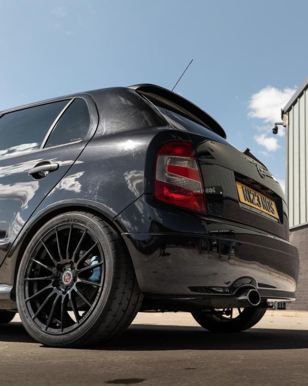

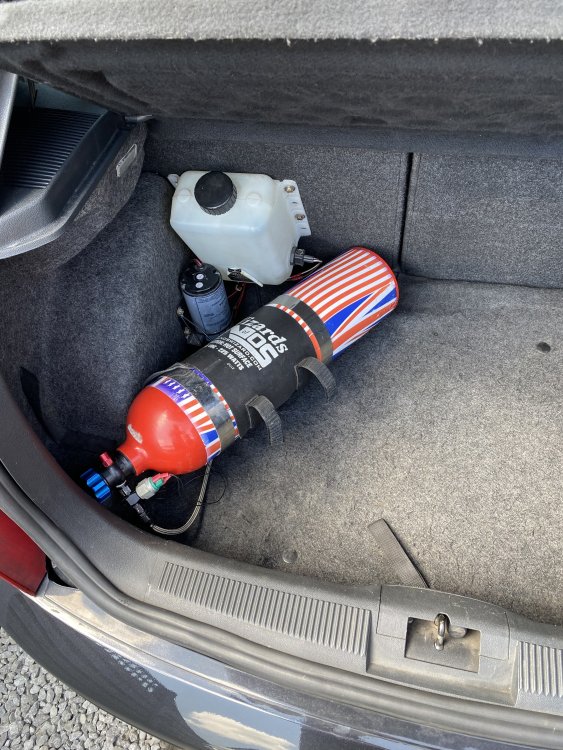

Trevorb33’s Fabia vrs mk1 307bhp/400ftlbs - now sold
So I won a Fabia vrs off darkside developments, Big spec diesel Power Figures 332.7bhp & 445Ft/lbs - With Nitrous (50 Jet) 307.1bhp & 400Ft/lbs - Diesel Only Engine GTD2872VRK Billet Hybrid with Vacuum Conversion Darkside Developments Turbo Kit with Tubular Stainless Manifold/Downpipe Darkside Straight through Stainless Exhaust System Darkside Ported + Dimpled Head with bigger valves Rosten H-Beam Rods ARP Mains Studs Darkside Race Camshaft 1.9 8v Headstud Kit Uprated valve springs Firad PD Race 120% Injectors Universal Front Mount Intercooler Custom Darkside Hardpipe Kit Darkside 57mm EGR Delete Darkside Front Mount Oil Cooler AEM Cone Filter Darkside Custom TIP Pipe 6 BAR MAP Sensor Darkside Custom Remap + Hardcut Limiter Wizards of NOS Dry Nitrous Kit (50 Jet) Performance Aluminium Radiator HyperKuhl Super Coolant Fass Lift Pump Snow Performance Water Methanol Kit Snow Performance Solenoid Machined Pistons Coated Pistons Transmission 02M 6 Speed Gearbox Darkside Single Mass Conversion with Sachs SRE Clutch Quaife 02M Limited Slip Differential 4th Gear Support short shifter Chassis Vibratechnic Engine and Gearbox Mounts KW Variant 3 Fully Adjustable Coilovers Adjustable Drop Links Powerflex Bushes with Black Race Series on Wishbone Brakes Porsche Caliper Upgrade Brembo 312mm Front Brake Discs & Track Pads Brembo 256mm Rear Brake Upgrade RBF600 Brake Fluid Wheels and Tyres 17" 2Forge ZF1 Wheels in Gloss Black 215/40/17 Yokohama A052 Tyres Exterior Bumper opened for Air Flow Custom Headlights Plans are afoot mainly to clean it up to my standards, bodywork is pretty good both side sills were done a couple of years back, just a bit of rust coming through on bootlid. Nitrous is going to come off (scares me a little haha) and I’m in the process of tiding all the masses of wiring, as it’s had many additions over the years, nitrous wiring, water meth, boost gauge, sub in its past, some pics before I started my bits and pieces
