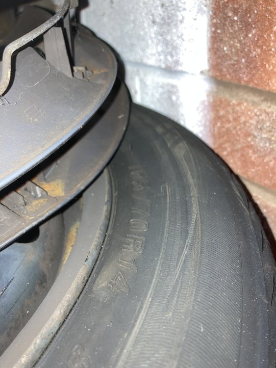

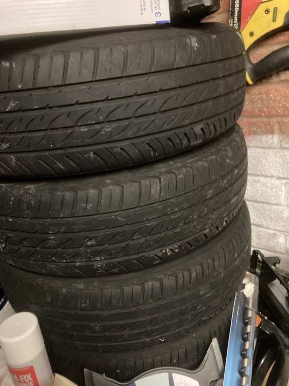

£30 14” citigo steelies fit mii/up 4x100
