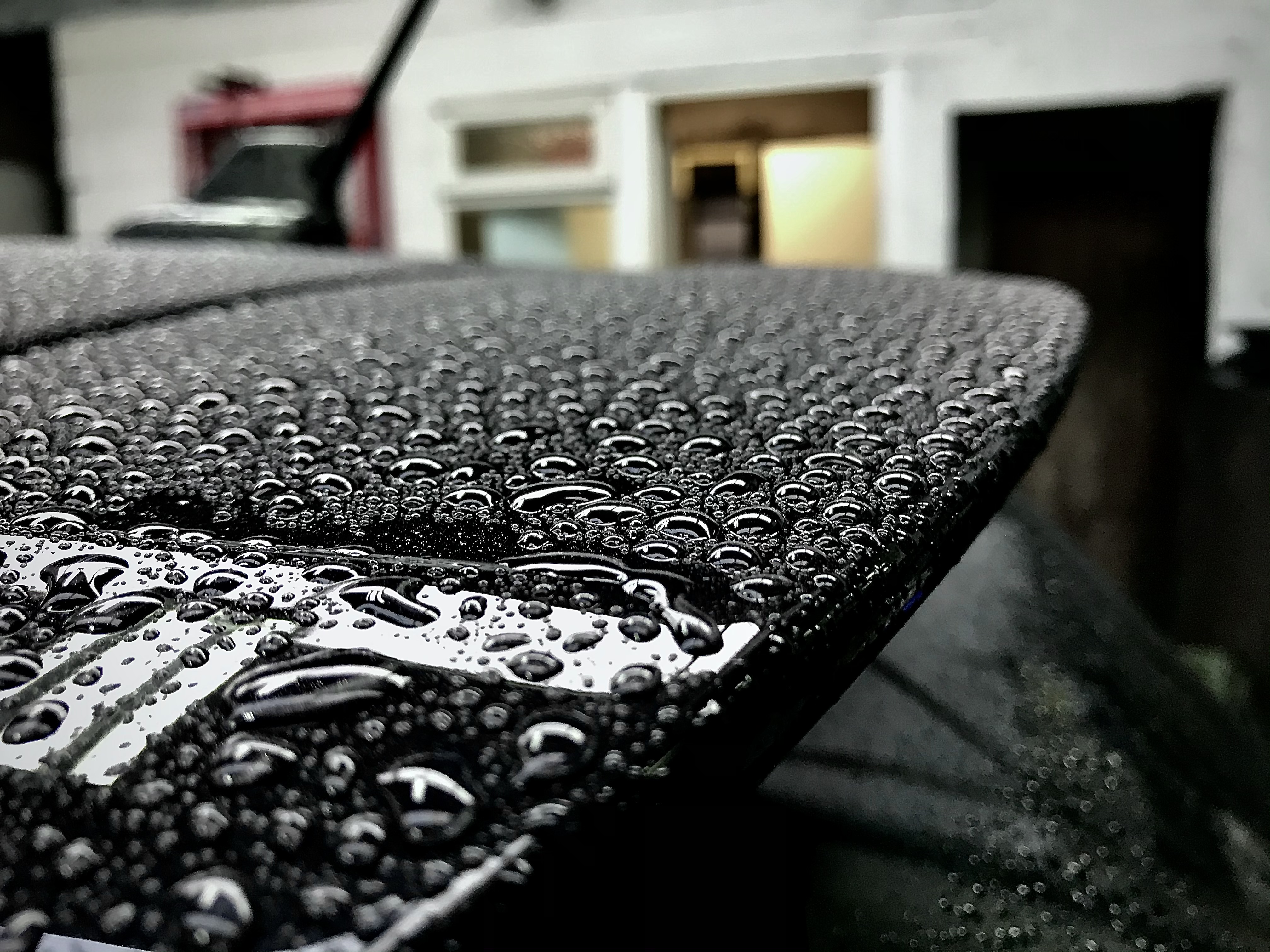

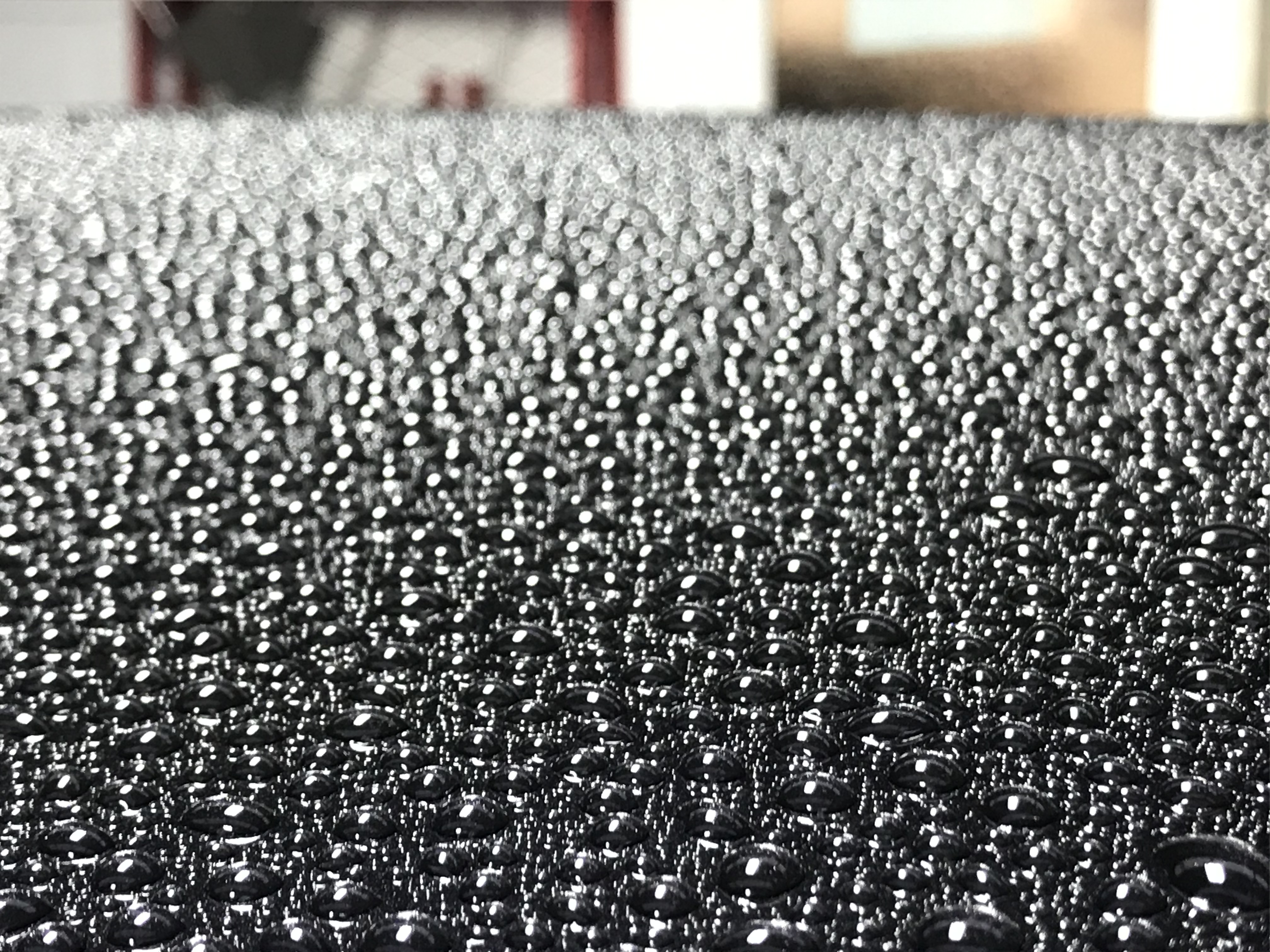

No last stage protection has been applied to this black MK2 Fabia vRS, just the Blackfire SRC finishing polish. Not the best beading I’ve had, but not bad for naked paintwork- Post Your Reflection Shots
