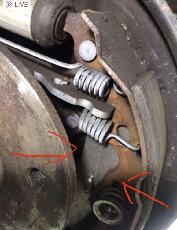

  8. I had the same .... handbrake on MOT test was ok but the foot brake failed. When I took it all apart, the very first bit of movement was very stiff and freed up once I had done my thing. The foot brake doesn’t pull the silver arm as much as pulling up the handbrake, so pressing the foot brake wasn’t strong enough to get passed the initial sticking point. Not saying this is 100% your issue, but the symptoms are the same as I had last week.
  9. No, I’m mean the actual silver arm attached to one of the shoes ......

  15. How free is the actual handbrake arm (can’t think of the correct, technical term for it!) inside the drum?? I had a very similar problem on a car last week that I fixed by removing the shoe that its attached to and freed it up in a vice with a bit of oil and some brute force back and forth.

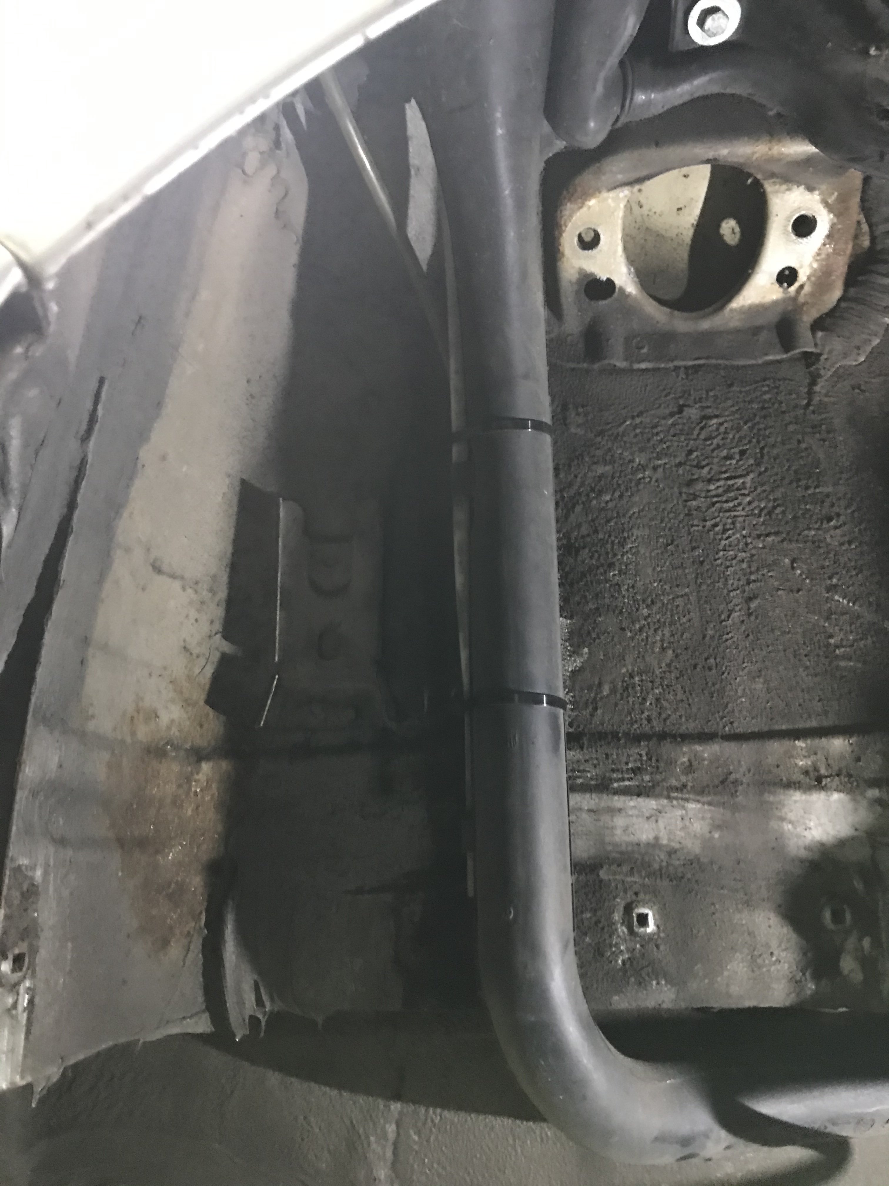

  23. The pipe attached to the back of the small drain hole just under the screw cap has become detached. Take out the arch liner and reattach it, like I had to ....
